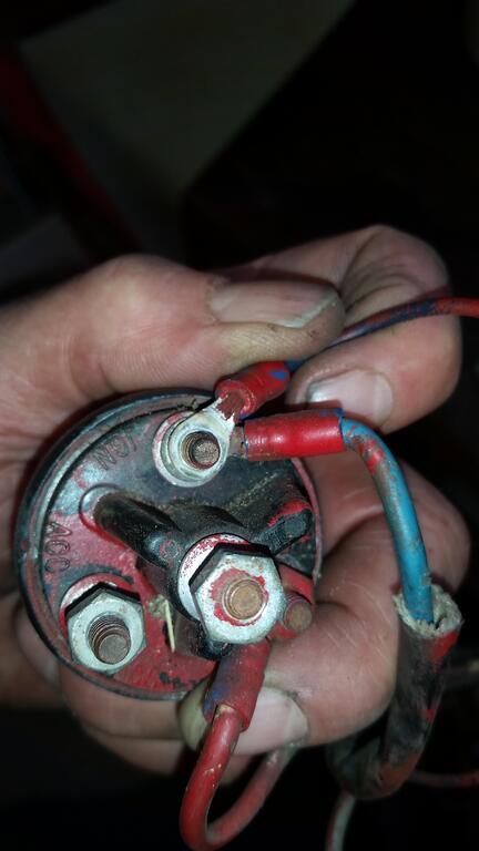

702854boy 1,245 #4 Posted September 17, 2025 21 minutes ago, WHX?? said: If it's original that is. I do have the original one and it was still working but I decided I wanted to switch it over to the solenoid and low amp switch to make it a little less likely to let all the magic smoke out. 2 Share this post Link to post Share on other sites

gwest_ca-(File Mod) 12,557 #6 Posted September 17, 2025 8 hours ago, 702854boy said: I do have the original one and it was still working but I decided I wanted to switch it over to the solenoid and low amp switch to make it a little less likely to let all the magic smoke out. No need to replace the switch. Just add the solenoid and get rid of the heavy wire to the switch if you want to. Replace with 14 gauge wire. The original switch should now outlast the rest of the tractor. 2 1 Share this post Link to post Share on other sites

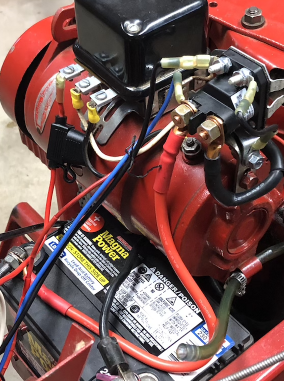

ri702bill 13,394 #7 Posted September 17, 2025 I am in full agreement in adding a solenoid to the 854 - I did mine years ago. I made up a flat plate and mounted it to to back end of the S/G - that allowed short runs for the wiring. Running the heavy amperage load thru an ignition switch is not a good longterm idea..... Share this post Link to post Share on other sites

Handy Don 17,735 #9 Posted September 17, 2025 One example of adding a solenoid and attaching it to the generator and having it fit under the 854 hood. Very similar to @ri702bill’s. Here in our files section, are two versions of the 854 wiring diagram--with and without a solenoid. 1 1 Share this post Link to post Share on other sites
ri702bill 13,394 #10 Posted September 17, 2025 And I see the added weather resistant inline fuse holder - a "must have" when rewiring a 50 plus year old tractor. Share this post Link to post Share on other sites
