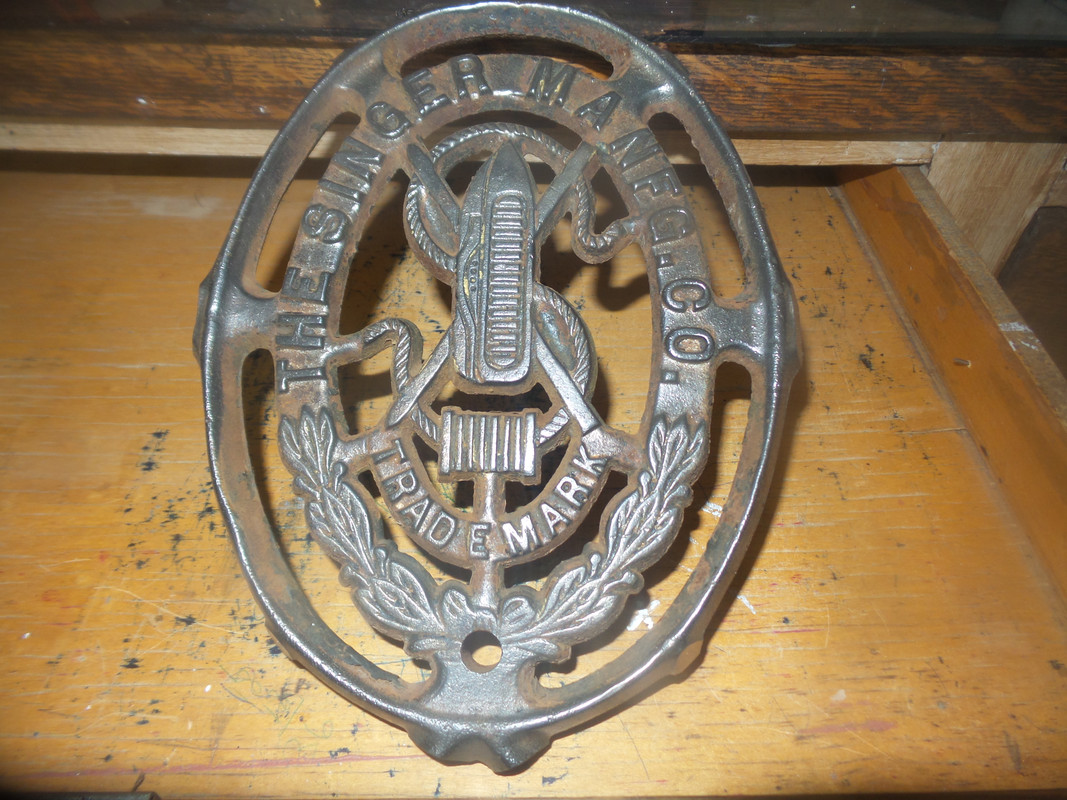

bc_gold 199 #1 Posted September 11, 2025 (edited) Landfill score, someone had discarded the cast iron frame from a Singer sewing machine. Brought it home then cut the trade mark logo from the casting. Gave one to a buddy his wife wants him to clean up the rough edges, she wants to use it in the kitchen to set a hot pot onto. I'm going to steal her idea, clean it up then gift it to a girl friend. Edited September 11, 2025 by bc_gold 7 1 Share this post Link to post Share on other sites

Achto 31,906 #3 Posted September 12, 2025 (edited) 20 hours ago, bc_gold said: clean it up then gift it to a girl friend. I like a beeswax finish on cast iron. Get the iron cherry red, rub with bee's wax, the iron will suck the wax into the pores to seal it. Leaves a nice semi gloss finish that is fairly durable. I good demo of natural finishes. Edited September 12, 2025 by Achto 1 Share this post Link to post Share on other sites
