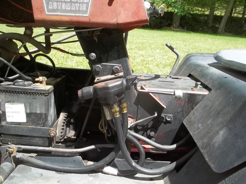

Brockport Bill 2,553 #6 Posted September 12, 2025 I've not had hydraulic leak from 1800 but did on c175 Blackhood with kt17 engine. Removing the master hydraulic valve from inside hoodstand plus 4 hoses was brutal so I decided I was only going to do it once because I couldn't determine precise leak location...so i removed master valve and took apart and installed new O rings plus all 4 new hoses ...no leak thereafter...only had to do once....yippee! A bit expensive for 4 hoses but didn't want to repeat the job.....lots of bruised cut knuckles 2 Share this post Link to post Share on other sites
953 nut 70,654 #7 Posted September 12, 2025 4 hours ago, Brockport Bill said: Removing the master hydraulic valve from inside hoodstand plus 4 hoses was brutal The older models like the Electro and Charger weren't as pretty with the valve hanging off the side but they were easy to maintain. 1 Share this post Link to post Share on other sites
pfrederi 21,342 #8 Posted September 12, 2025 1 hour ago, 953 nut said: The older models like the Electro and Charger weren't as pretty with the valve hanging off the side but they were easy to maintain. I will take ugly but easy to work on over elegant/slick design any day... 1 1 Share this post Link to post Share on other sites

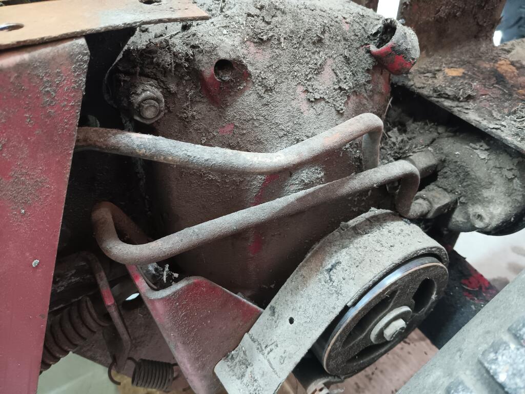

homefried1@yahoo.com 2 #9 Posted September 12, 2025 Heres what the pipe looks like on a gt1600 Share this post Link to post Share on other sites
953 nut 70,654 #10 Posted September 12, 2025 4 minutes ago, homefried1@yahoo.com said: Heres what the pipe looks like on a gt1600 Is that what is leaking on you. If so you could buy the fittings and a hose from Surplus Center. https://www.surpluscenter.com/Hydraulics/?gad_source=1&gad_campaignid=18526732283&gbraid=0AAAAAo6yYyqtA3rKB1-xlS_ayELjfi1t0&gclid=CjwKCAjwiY_GBhBEEiwAFaghvocA81ohnTIMe1Fl3HB4-JoYyZ4JeF3XemwhGG3_EdfZ0mEGYstDORoCtJ0QAvD_BwE Share this post Link to post Share on other sites
Wayne0 1,666 #11 Posted September 13, 2025 More than likely, if it's at the valve, it's the fitting on the end of a hose. I had 2 blow off before I got smart and replaced all the hoses. With the amount of work it takes to get that valve out, you only want to do it once! Share this post Link to post Share on other sites

c-series don 12,752 #13 Posted September 14, 2025 That’s not a GT-1600, the 1600 only came in an 8-speed model. On one of my GT-1800’s I replaced that steel pipe with a hydraulic hose that I had made. Probably would have been much cheaper to buy the correct one on E-Bay, but I was in a hurry and needed it right away. I believe all the eighties and early nineties Eaton 1100’s were the same and have that pipe, it’s not specific to a GT-1800 2 Share this post Link to post Share on other sites
ebinmaine 81,282 #14 Posted September 14, 2025 18 hours ago, homefried1@yahoo.com said: I just wish it were as easy to get to on a gt1800, as it is on the pictured gt1600! I'll get it eventually. 2 hours ago, c-series don said: not a GT-1600 Agreed. That was @cleat 's pic I think? that he'd shared. Likely a 520H chassis which is the same as a GT1800. 2 hours ago, c-series don said: all the eighties and early nineties Eaton 1100’s were the same Frame and transmission yes. There's a difference in that pipe at some point. IIRC it was based on the location and angle of the transmission oil filter mount. I remember this because we got bit by the pipe being different. 1 Share this post Link to post Share on other sites
ebinmaine 81,282 #15 Posted September 14, 2025 On 9/12/2025 at 8:59 AM, homefried1@yahoo.com said: Here's the two different types. Now the transmission filter end is at different angles. 1 Share this post Link to post Share on other sites
cleat 9,450 #16 Posted September 14, 2025 (edited) 7 hours ago, ebinmaine said: Here's the two different types. Now the transmission filter end is at different angles. For some reason wheel horse used rubber or hard lines for supply and return to the hydraulic valve from the hydro. Also the hard line from the filter to the hydro is different whether or not it is fed from a hard line or a rubber line. Another difference is the filter bolts to the fender support around 1/2" or 3/4" further back in another set of holes with the hard line models. Edited September 14, 2025 by cleat 2 Share this post Link to post Share on other sites

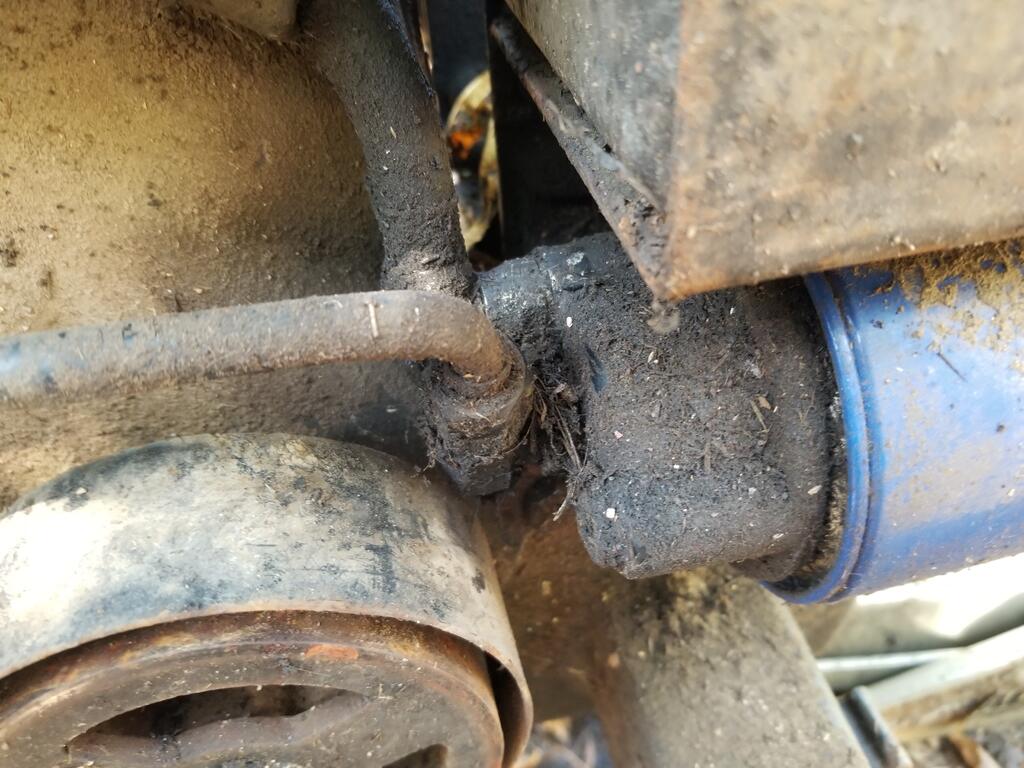

homefried1@yahoo.com 2 #17 Posted September 17, 2025 I'm still not absolutely certain that this is where the leak is. It is the right location, but I cant see the oil coming out, only seeing it pooling up right under the fitting. It gushes out! I bought a set of crow foot wrenches and put the 11/16 on an extension and tried to loosen the attachment nut, but even with a cheater bar, it did not turn. I'm thinking I may have to remove the rear end to get to it to get that fitting out. 1 Share this post Link to post Share on other sites

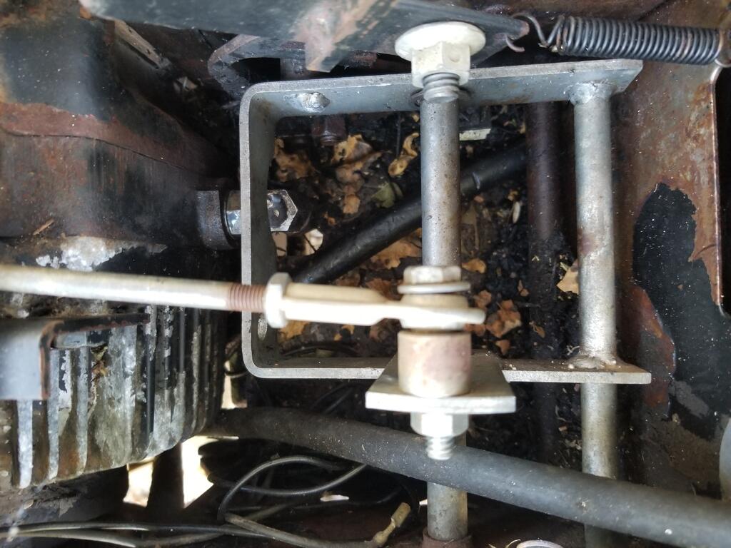

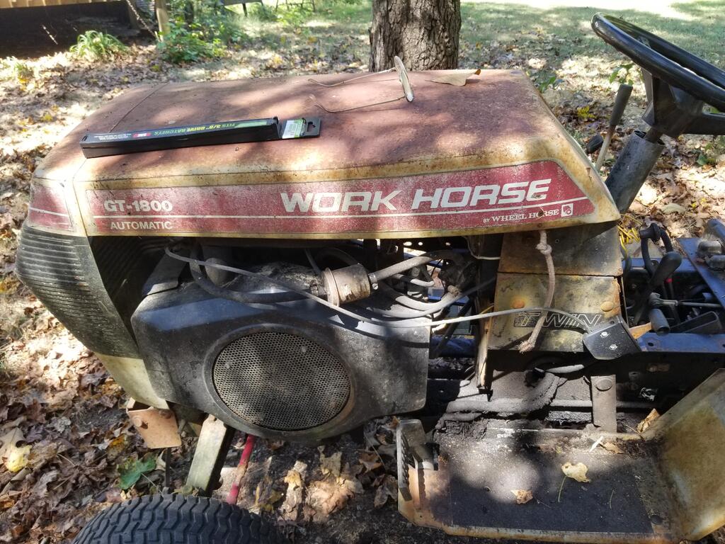

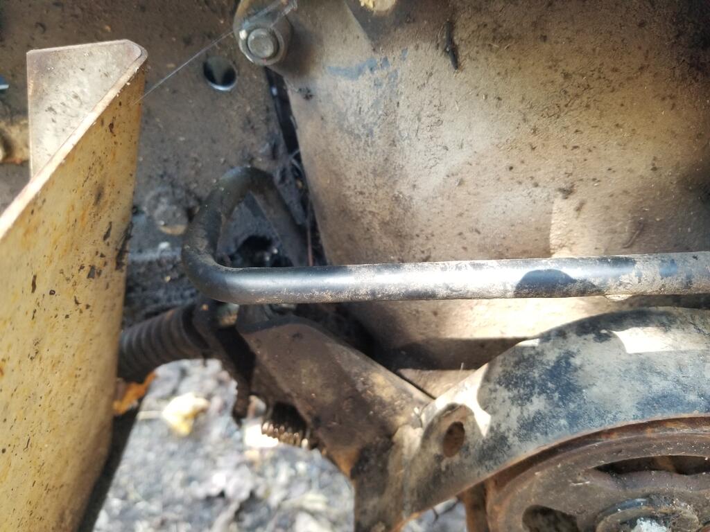

homefried1@yahoo.com 2 #18 Posted September 17, 2025 On 9/14/2025 at 6:52 PM, cleat said: For some reason wheel horse used rubber or hard lines for supply and return to the hydraulic valve from the hydro. Also the hard line from the filter to the hydro is different whether or not it is fed from a hard line or a rubber line. Another difference is the filter bolts to the fender support around 1/2" or 3/4" further back in another set of holes with the hard line models. Here are some pictures of my tractor. Have you ever taken the rear end out of one? Is that a big job? thanks for the help. Share this post Link to post Share on other sites
cleat 9,450 #19 Posted September 17, 2025 2 hours ago, homefried1@yahoo.com said: Here are some pictures of my tractor. Have you ever taken the rear end out of one? Is that a big job? thanks for the help. I would start by giving it a real good degreasing and cleaning so you can more easily see the leak. You would not want to disconnect a hydraulic line that is dirty and get anything into the hydraulic system either. 3 Share this post Link to post Share on other sites
