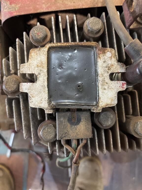

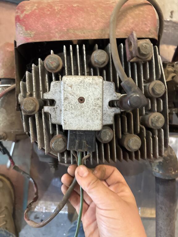

TonyToro Jr. 2,523 #1 Posted September 7, 2025 (edited) I am taking the old engine from my Raider 12. It doesn’t have a coil and some sort of voltage regulator under the dash. The ignition switch only had 3 posts too and no solenoid. The new engine I got has a coil, and solenoid. And 2 wires coming from the alternator. What type of voltage regulator/rectifier is needed so it will charge? And guidance and help is appreciated. Thank you. Edited September 7, 2025 by TonyToro Jr. Share this post Link to post Share on other sites
pfrederi 20,992 #2 Posted September 7, 2025 What does the regulator under the dash look like? You may just need a new ignition switch. Share this post Link to post Share on other sites
TonyToro Jr. 2,523 #3 Posted September 7, 2025 This is what it looks like. Share this post Link to post Share on other sites
pfrederi 20,992 #4 Posted September 7, 2025 Take the two wires coming from your alternator and hook them up to the two outer wires on this regulator see if it works. I imagine your ignition switch was one of the heavy duty ones used back then One heavy wire to Battery one to the starter motor and a small wire to the coil. For testing you could just take the center wire from your regulator to the battery positive see if it charges 1 Share this post Link to post Share on other sites
953 nut 68,140 #5 Posted September 7, 2025 Buy a 103990 ignition switch and follow this diagram and you should have everything you need. 1 Share this post Link to post Share on other sites
TonyToro Jr. 2,523 #6 Posted September 8, 2025 (edited) So we have it running! It has the 103990 ignition switch. But still not sure how to hook up the charging system. EDIT- @953 nut Looked at your diagram again and I see what you’re saying. 2 wires from the stator go the the 2 outside posts. And the one in the middle go to the ignition switch. Got it! Edited September 8, 2025 by TonyToro Jr. 1 Share this post Link to post Share on other sites

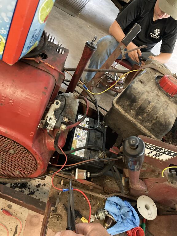

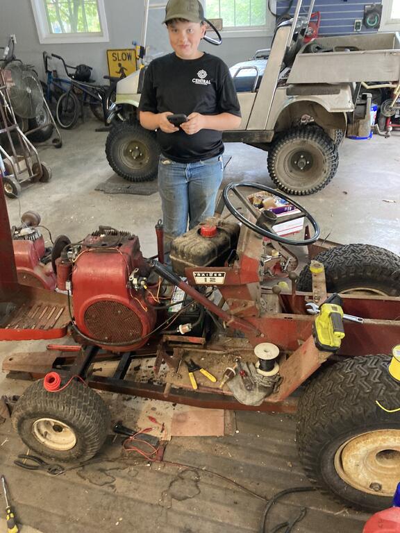

TonyToro Jr. 2,523 #7 Posted September 8, 2025 (edited) Here’s the pictures and videos from today. IMG_2018.mov IMG_2011.mov Edited September 8, 2025 by TonyToro Jr. 2 Share this post Link to post Share on other sites
