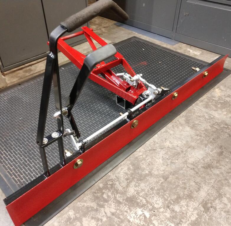

ri702bill 12,389 #8 Posted September 6, 2025 I made up a short scarifier to fit my 42" WH plow. When not in use, it flips up out of the way... 4 Share this post Link to post Share on other sites

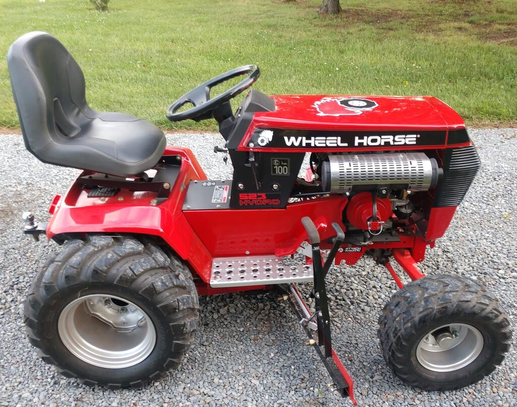

squonk 47,263 #9 Posted September 6, 2025 The biggest issue with the WH mid graders is the fact it's pretty light weight. They want to skid more than dig. You need a solid lift link and you just about have to stand on the top edge. You need something heavy with teeth. 4 Share this post Link to post Share on other sites

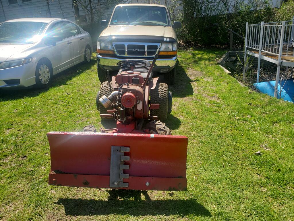

kpinnc 18,721 #10 Posted September 6, 2025 (edited) 12 hours ago, squonk said: The biggest issue with the WH mid graders is the fact it's pretty light weight. They want to skid more than dig. You need a solid lift link and you just about have to stand on the top edge. You need something heavy with teeth. Or you can find an old worn out commercial scrape blade and cut you a thick one from the wear bar. This one weighs about 80lbs. Got mine from Don @Lee1977 and fabbed the rest. It will spin the tires on the tractor without jumping just because of the weight. Edited September 6, 2025 by kpinnc 2 4 Share this post Link to post Share on other sites
