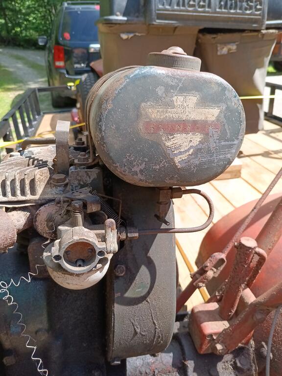

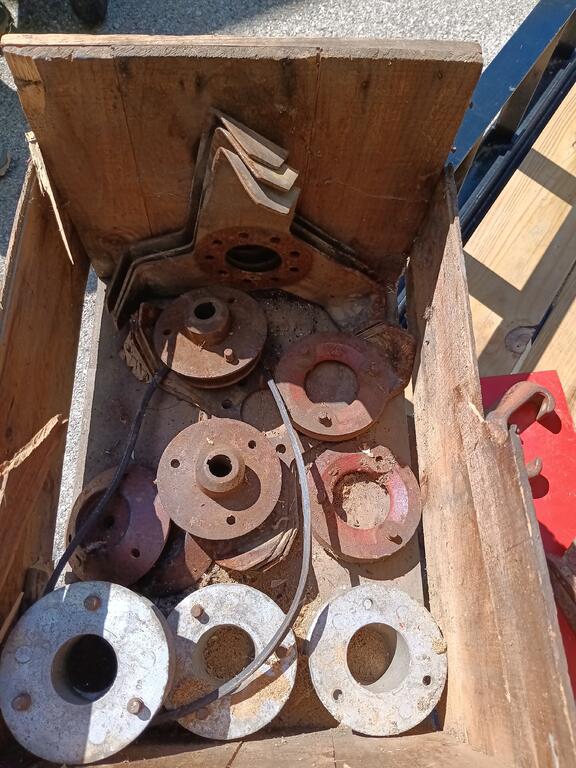

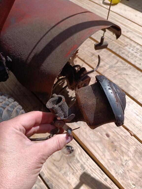

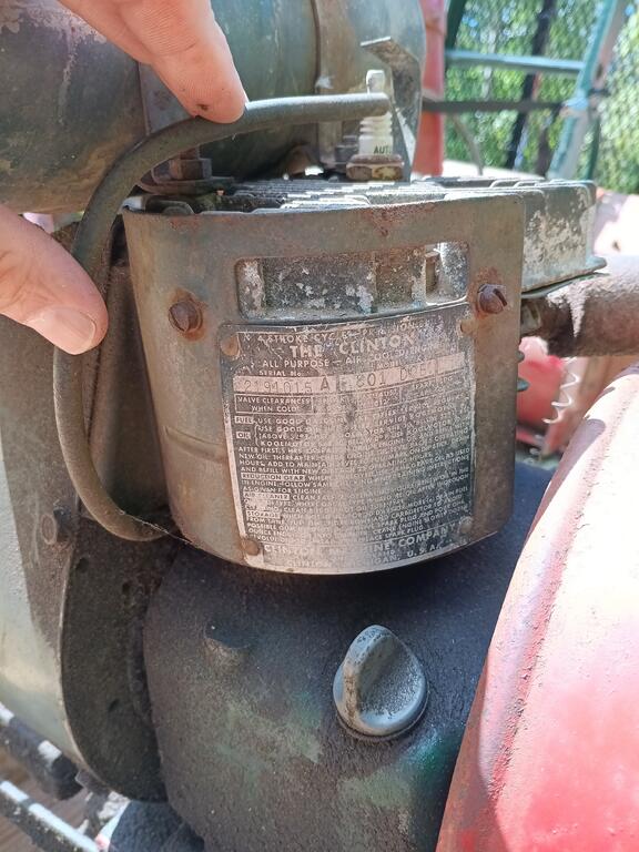

ebinmaine 80,461 #1 Posted August 30, 2025 While at a fellas house this morning to get his '92 520H I was helping shuffle some things to access the snowblower. This tiller was one of the objects. He offered to give it to me and I figured with some help I could get it going sometime or find someone who will. I did do some quick interwebs poking. The tiller appears to be the predecessor of Troybilt. RototilleR Model 2 Likely 1952 - 54 I'm NO expert. Just things I'm finding online similar to mine. The engine is a Clinton. Model 801 I think? It'll need a carb repair or replacement as this one got knocked around at some point. He gave me a nice wooden box full of extras. 3 Share this post Link to post Share on other sites

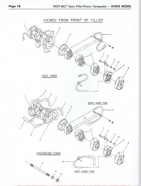

pfrederi 21,096 #8 Posted August 31, 2025 They are called pick tines. Designed for rocky soil. Father had a set on an very old troy bilt. They will not do well if you are till sod or grassy areas. Sounds perfect for your clay and rocks in Maine!! 3 Share this post Link to post Share on other sites

WHX?? 57,919 #10 Posted August 31, 2025 (edited) Pretty cool you ask me. Yes motor dates to early fifties ... 51 or so. I have manuals if your gonna take a wack at getting it running. Edited August 31, 2025 by WHX?? 1 Share this post Link to post Share on other sites
pfrederi 21,096 #11 Posted August 31, 2025 (edited) They might be cultivating tines. Need a better look. Edited August 31, 2025 by pfrederi 1 Share this post Link to post Share on other sites
1054 Project 92 #12 Posted August 31, 2025 Troy-Bilt offered optional tines for rocky soils that looked just like these. 1 Share this post Link to post Share on other sites

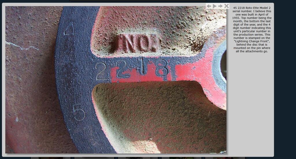

pfrederi 21,096 #13 Posted August 31, 2025 A little history on rototiller/Troy-Bilt and maybe a way to get its age. 1 1 Share this post Link to post Share on other sites
