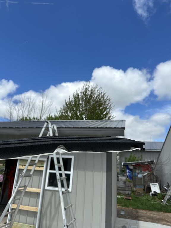

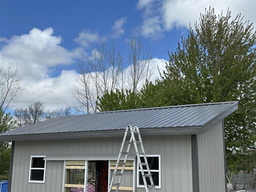

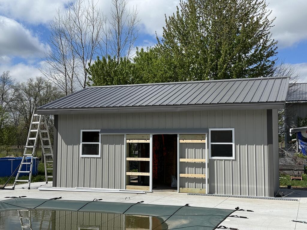

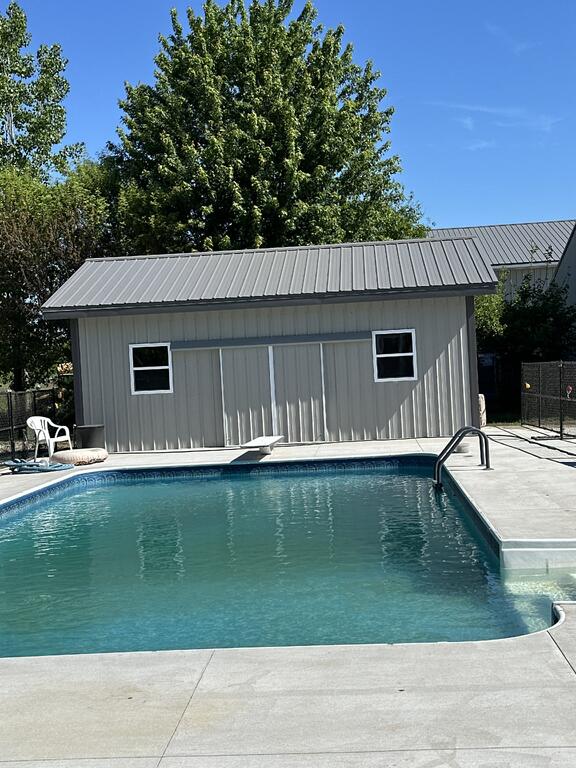

Pullstart 70,101 #151 Posted April 28 5th try, and it’s still not what I imagined, but it’s water proof and looks decent. I will try to duplicate the other end, but you can’t see them both at the same time I have foam rubber closure pieces to stuff under the roof edge before screwing if down too. 1 Share this post Link to post Share on other sites

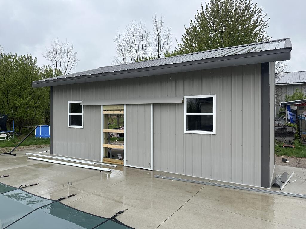

Pullstart 70,101 #152 Posted April 28 Shed construction is finished, shy of door latches and door sheet metal. Yay! 1 4 Share this post Link to post Share on other sites

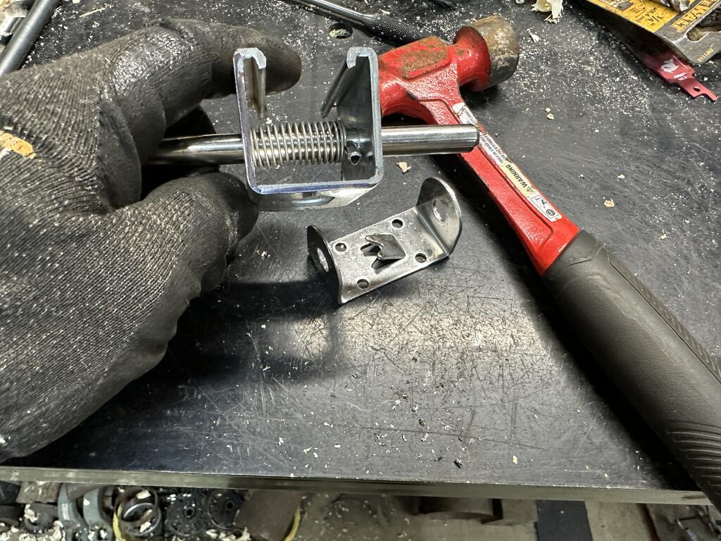

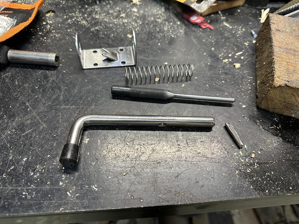

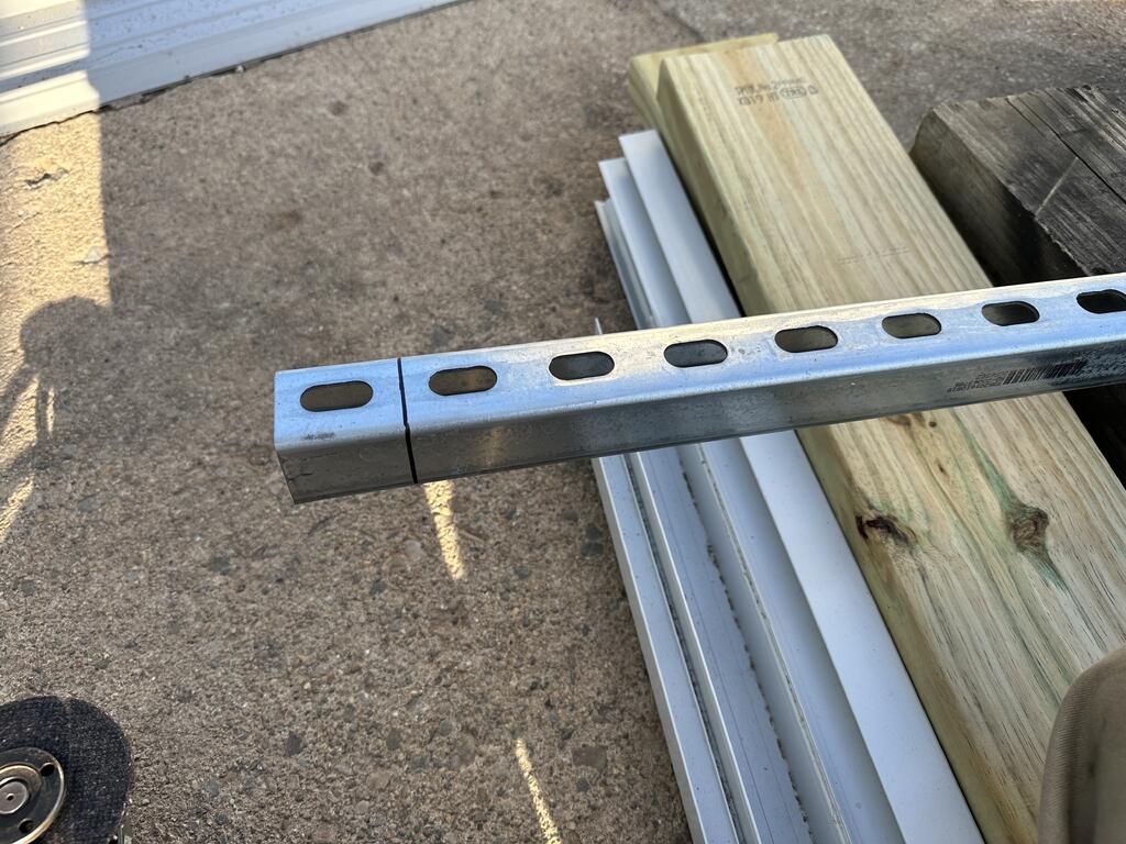

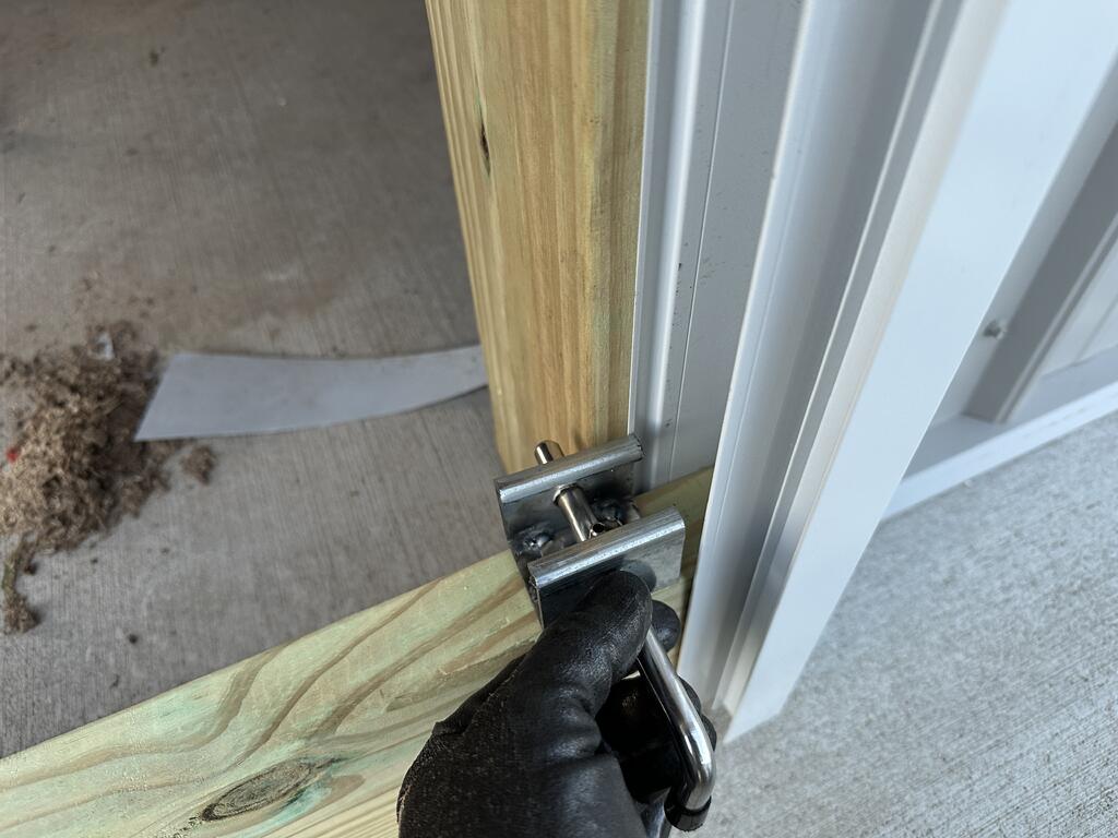

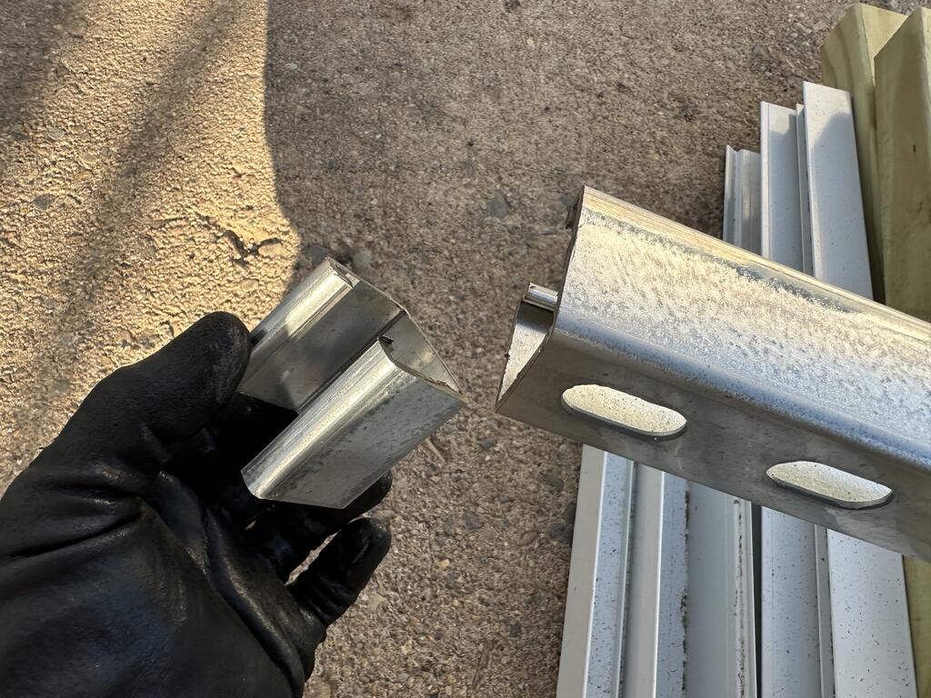

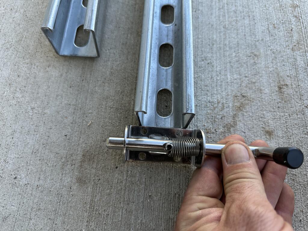

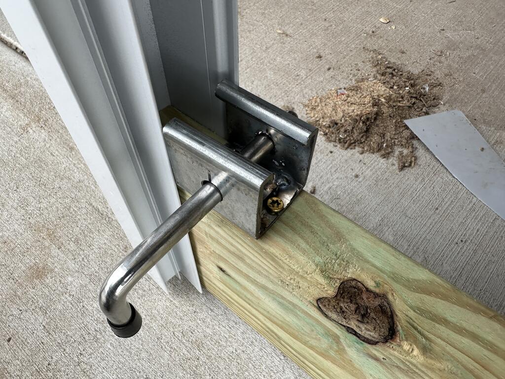

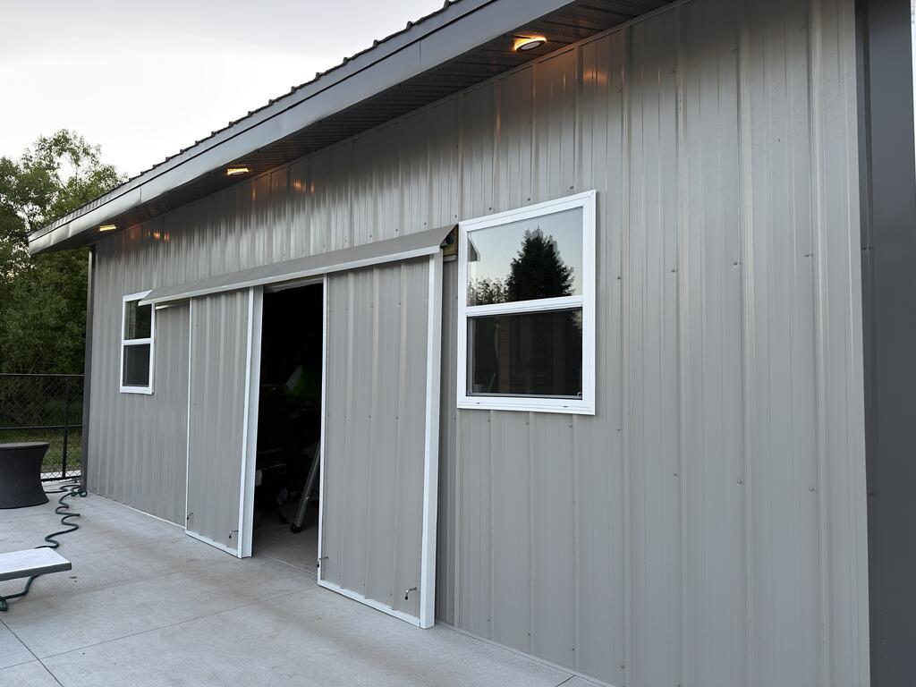

Pullstart 70,101 #153 Posted April 29 I received my latches, and got to work. The door is just a tickle over 1-1/2” thick, built using 2x4s and all. The first issue, was that the brackets were more than 2” long. That doesn’t work for me. I bought some uni-strut for this project and I have not used any yet. I have a feeling things will change soon. Share this post Link to post Share on other sites

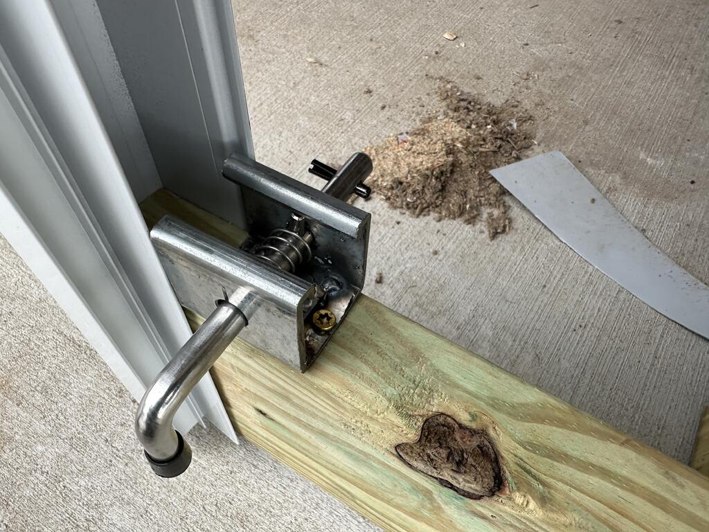

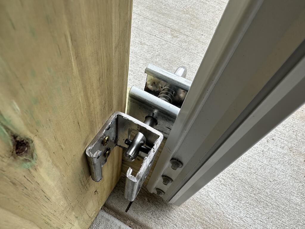

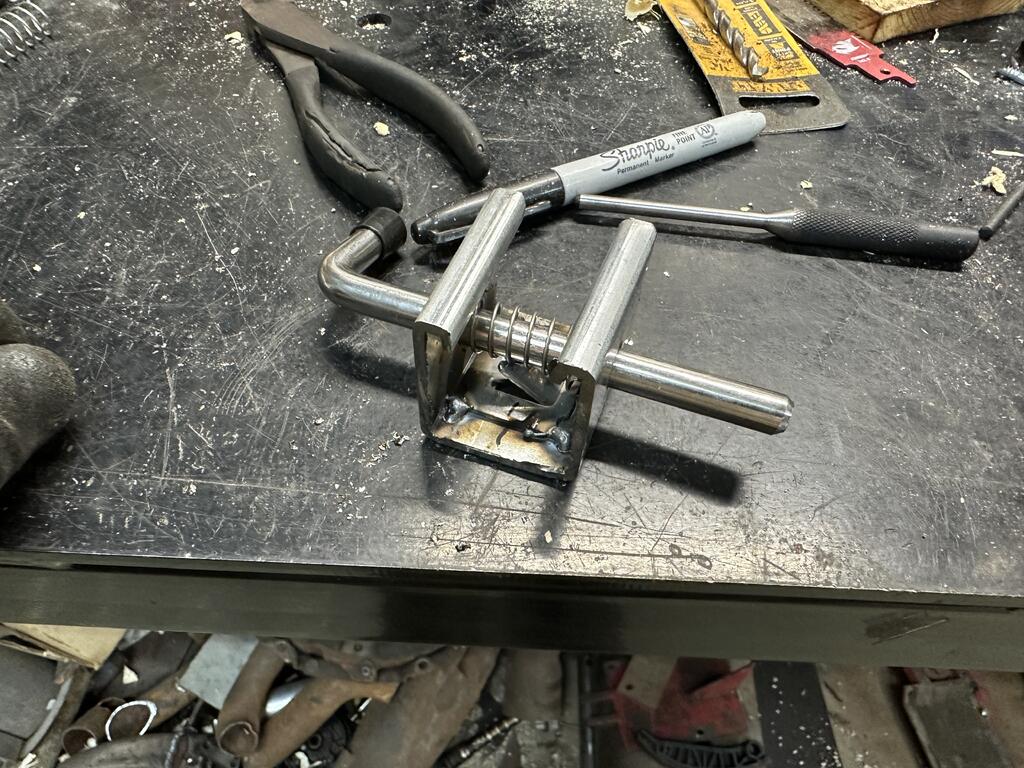

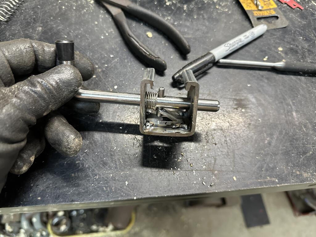

Pullstart 70,101 #154 Posted April 29 A little cut here, drill there, and tack weld about, and I have a latch that fits inside my door. It still has no way to hold the door from swinging in the wind (yet). 3 Share this post Link to post Share on other sites

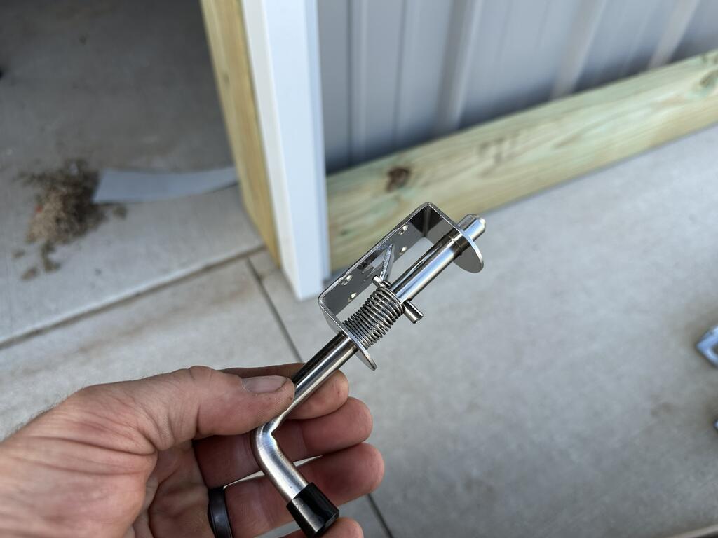

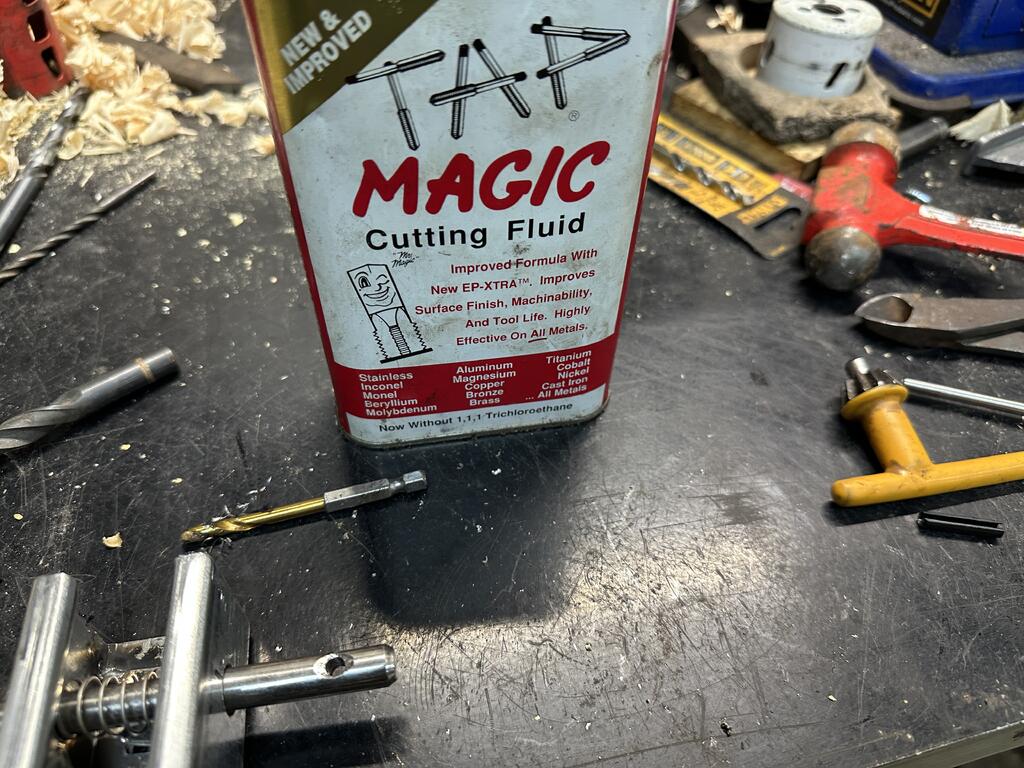

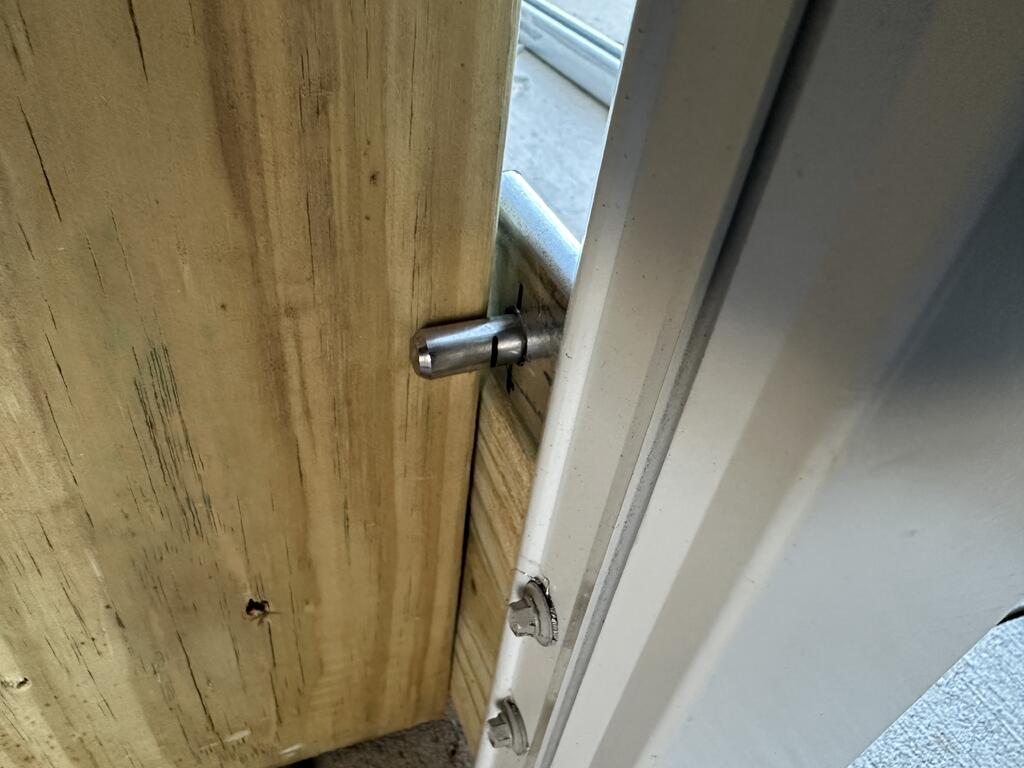

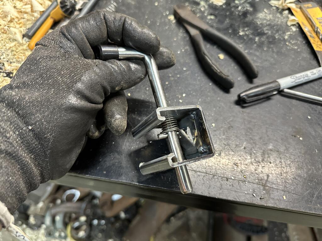

Pullstart 70,101 #155 Posted April 29 The latch fits inside the door, and I believe with another roll pin through that 304 stainless steel rod, it can create a key to engage the post bracket. I’ll need to trim the length of the rod, but it’s proving to be doable. 2 Share this post Link to post Share on other sites

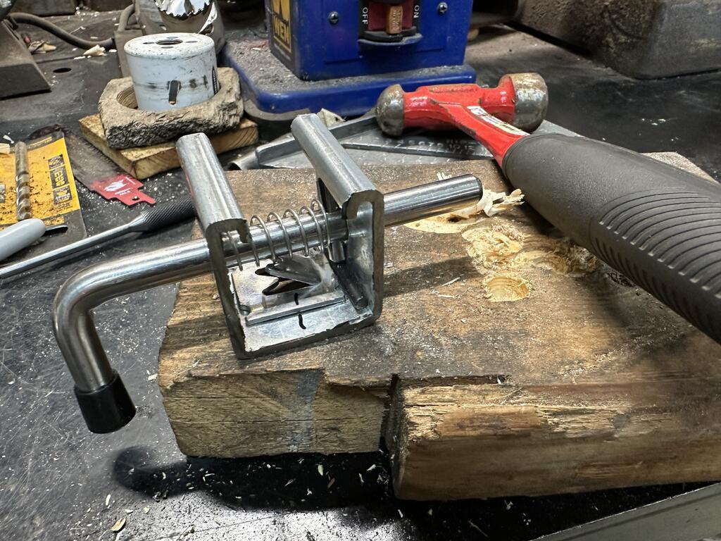

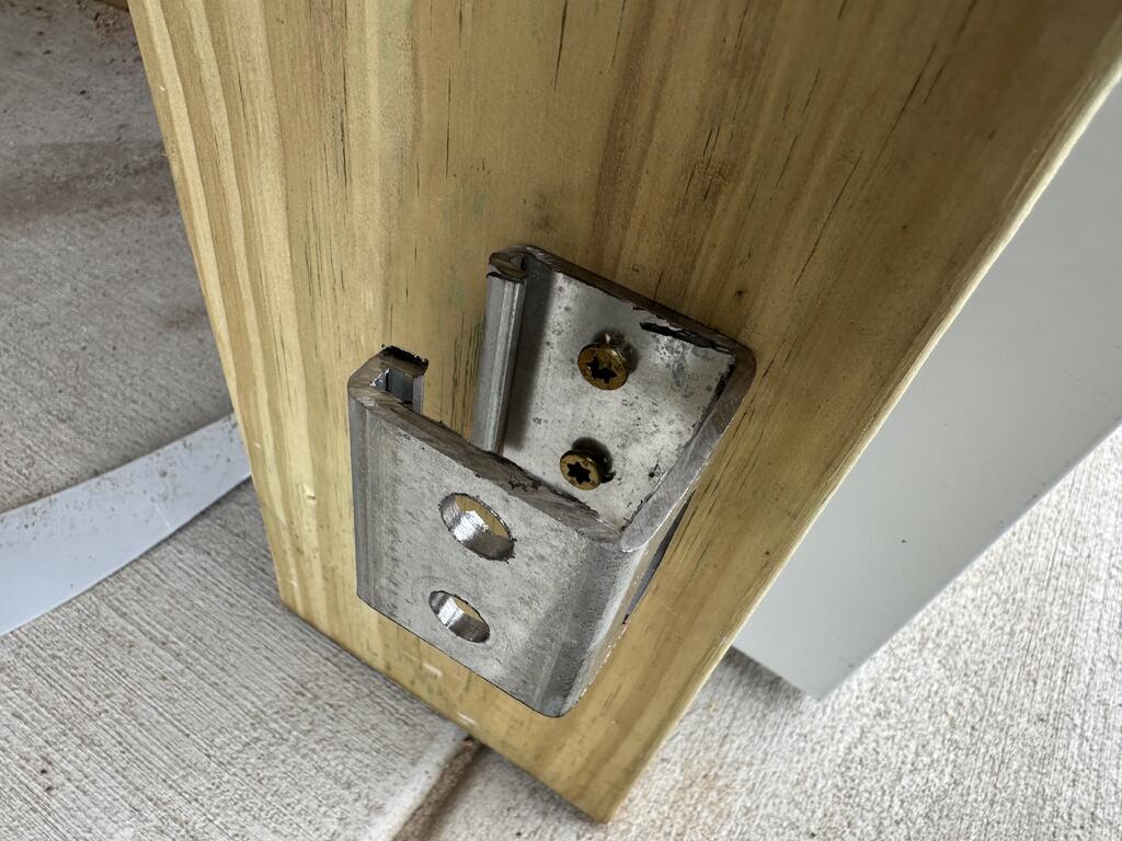

Pullstart 70,101 #156 Posted April 29 Rod drilled, post bracket built. Share this post Link to post Share on other sites

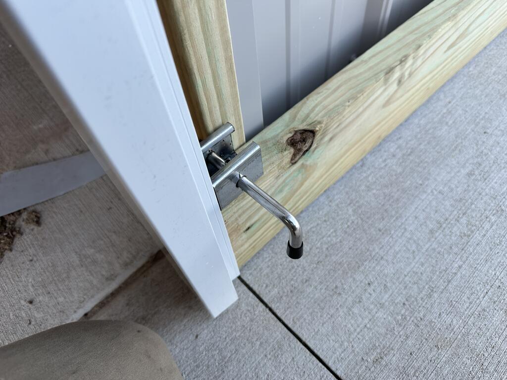

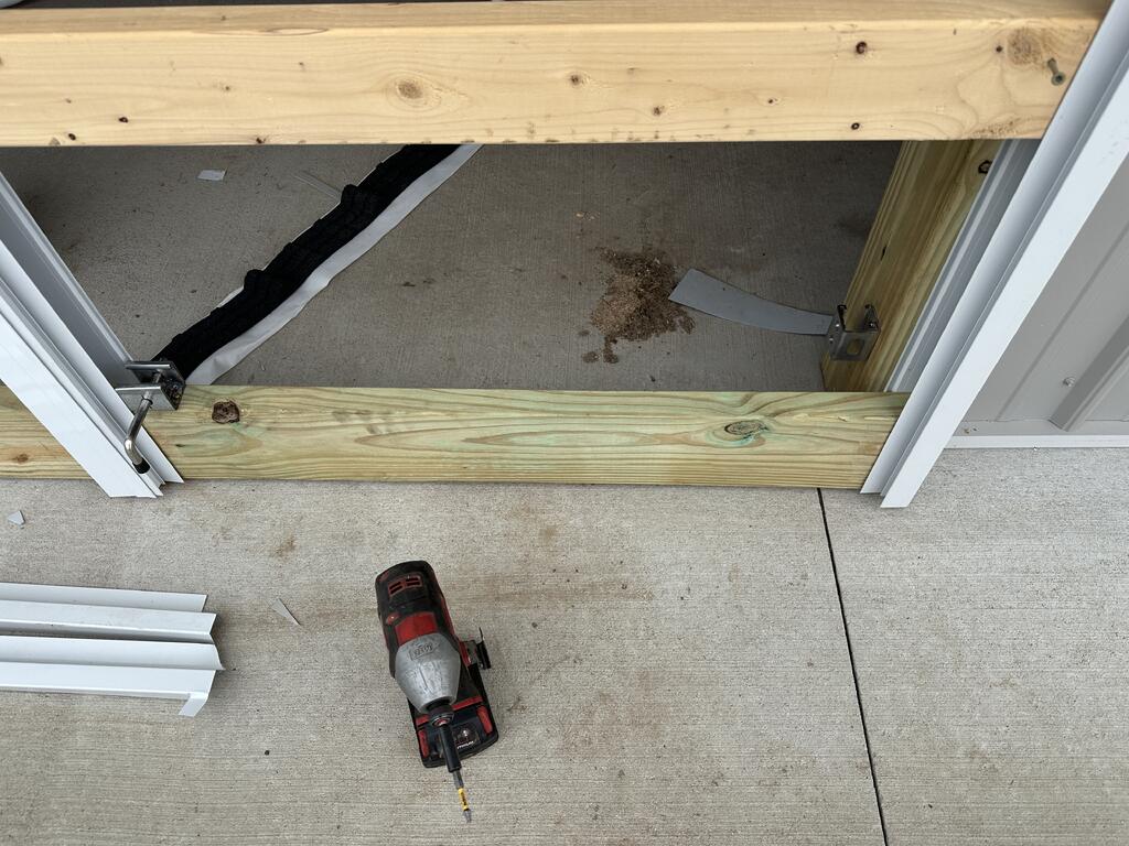

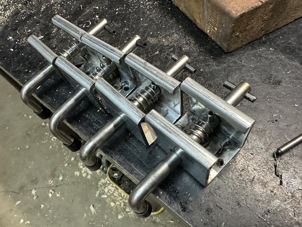

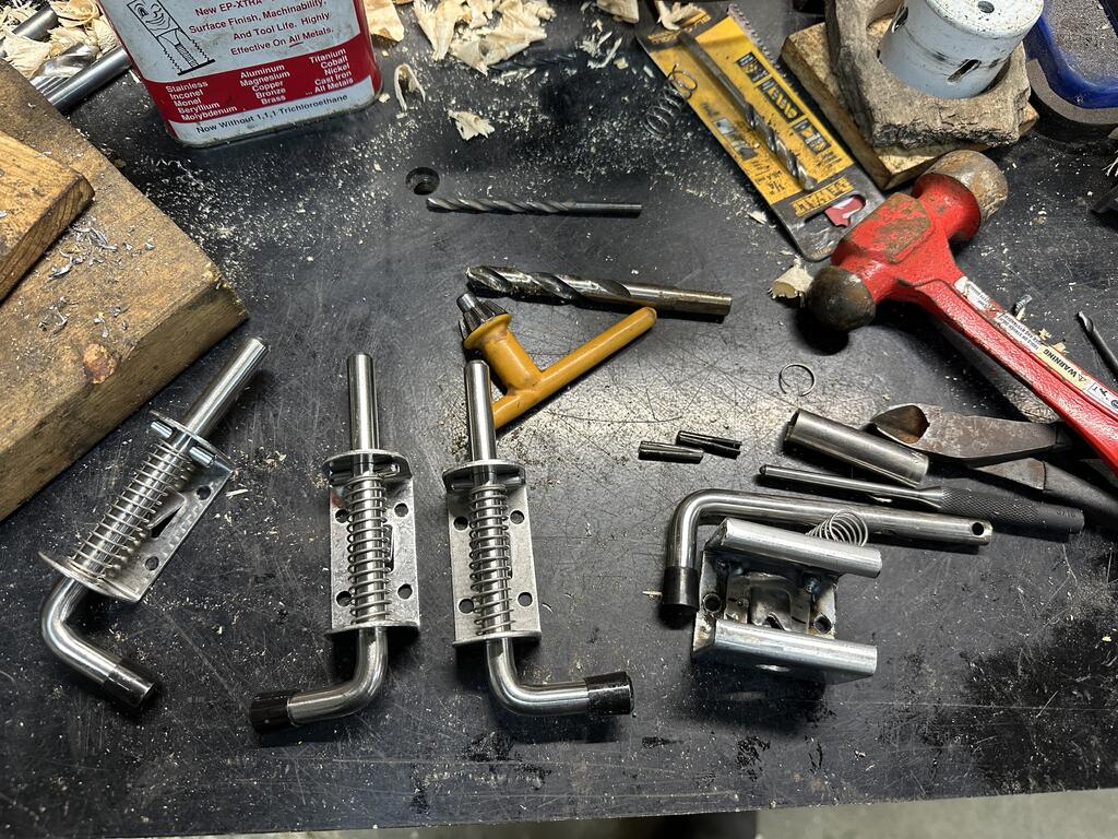

Pullstart 70,101 #157 Posted April 29 Proof of concept! I can build the remaining latches and trim the rods to length, then install them in the door frames. I’ll then install the door steel, drill through holes, and assemble. This feels good! 2 Share this post Link to post Share on other sites

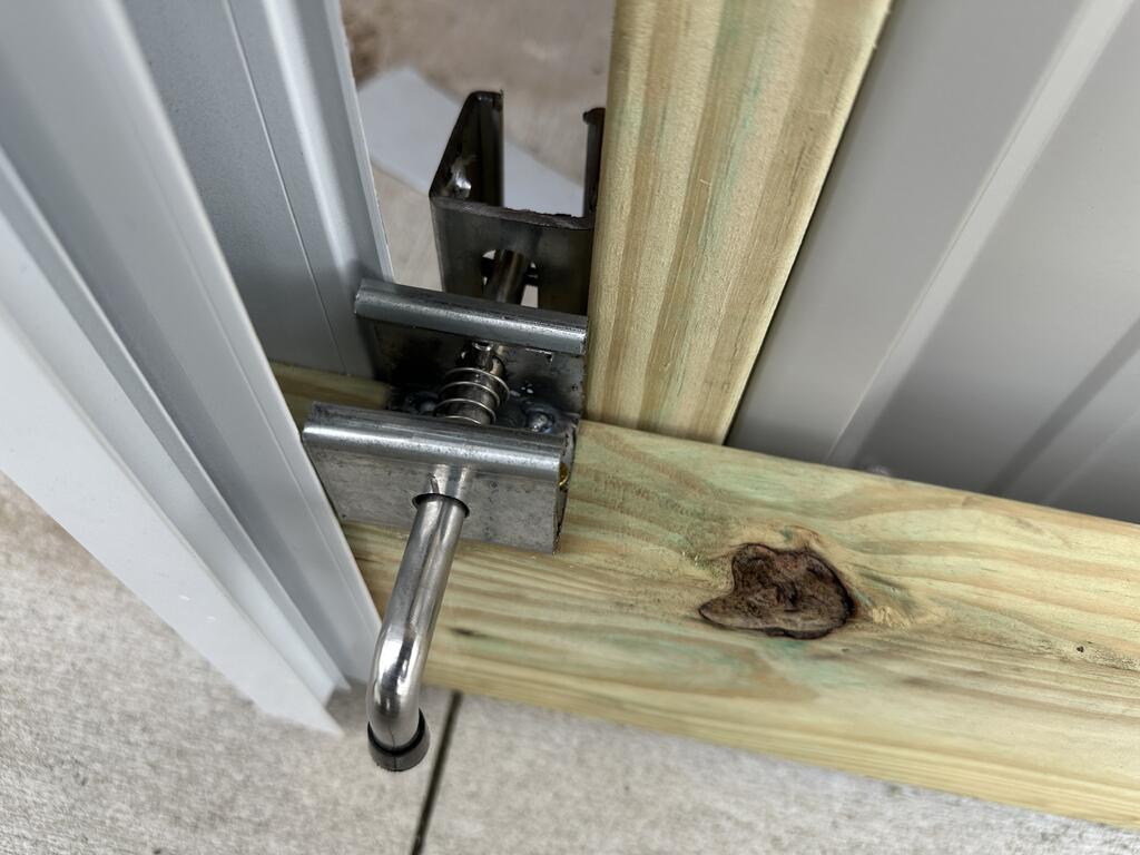

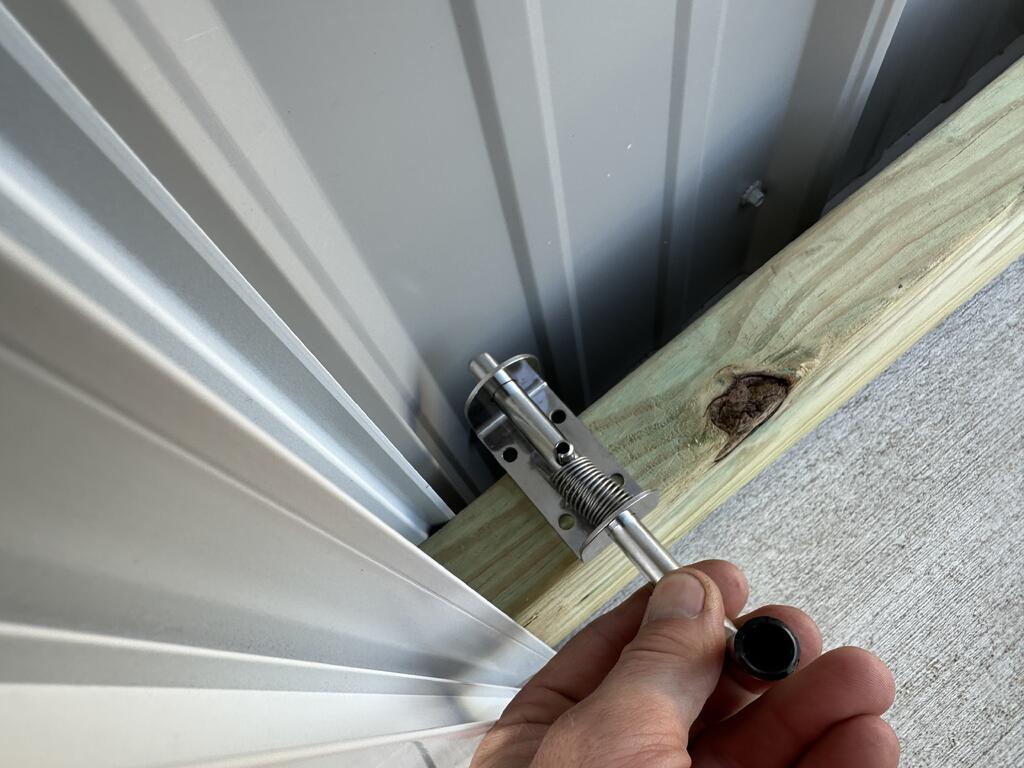

Pullstart 70,101 #158 Posted April 29 I trimmed the rod to length and assembled one latch. The door opens and closes with clearance, and shuts well. Now I just need to blow the rest of the latches apart and repeat the process. 2 Share this post Link to post Share on other sites

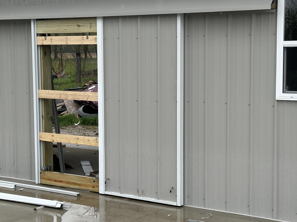

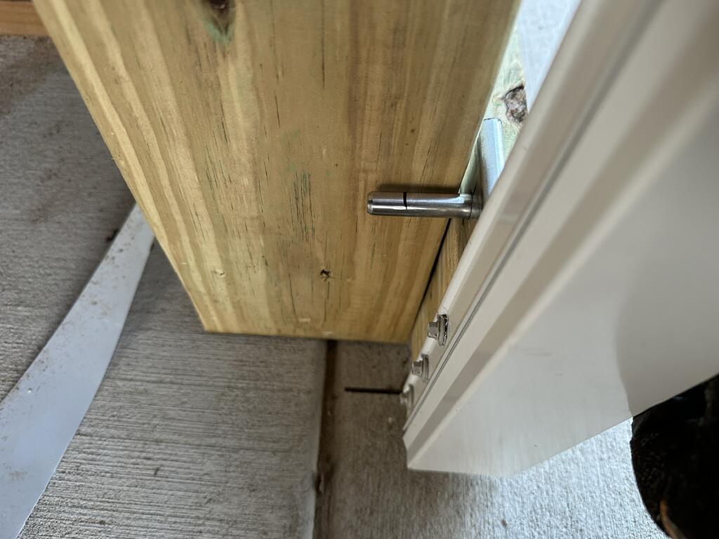

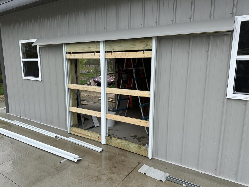

Pullstart 70,101 #159 Posted April 29 The front door can latch open or closed, and will function smooth. Plus a bonus it’s custom 2 Share this post Link to post Share on other sites

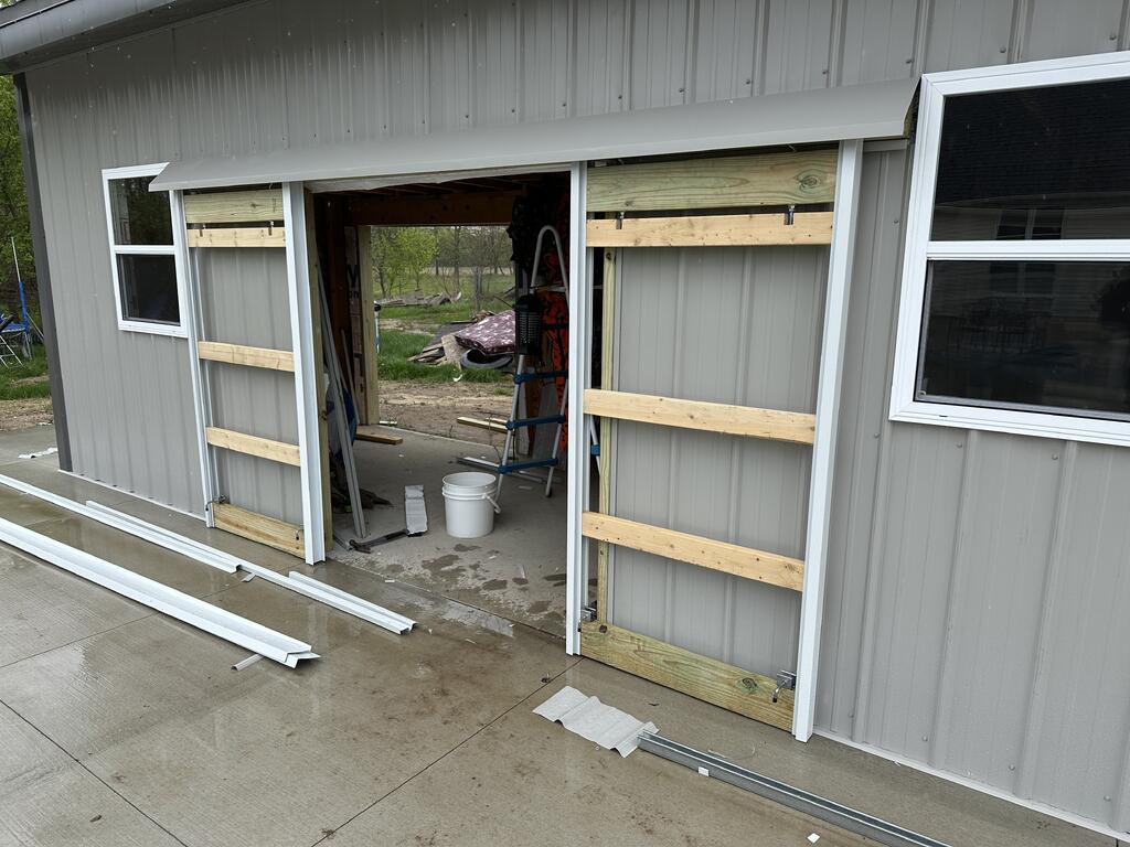

Pullstart 70,101 #160 Posted April 29 I’m soaked from the rain, but making progress! 2 Share this post Link to post Share on other sites
Handy Don 16,751 #161 Posted April 29 6 minutes ago, Pullstart said: I’m soaked from the rain But hey, the stuff inside is mostly dry. 😉 1 1 Share this post Link to post Share on other sites

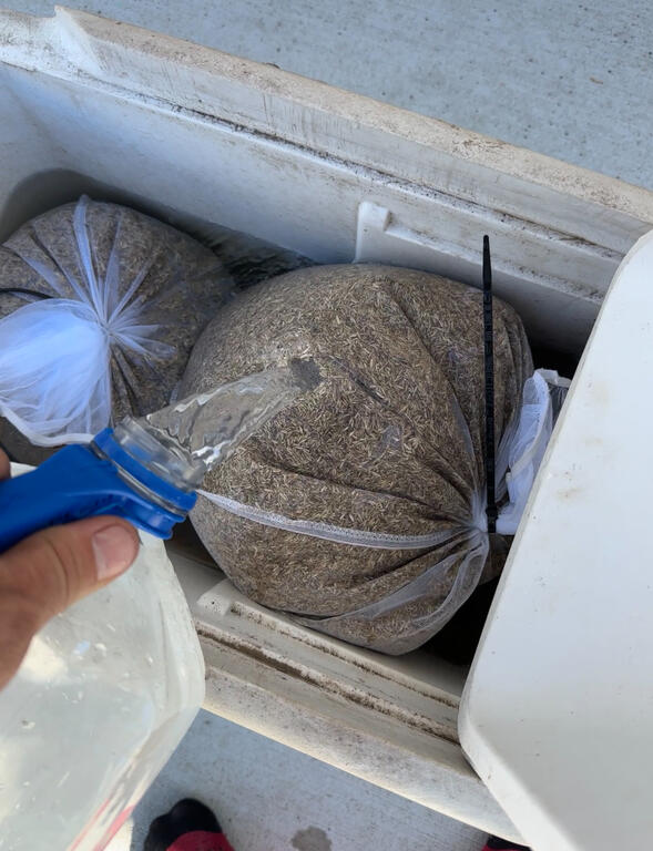

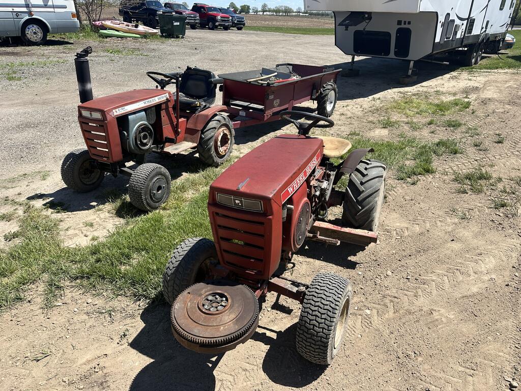

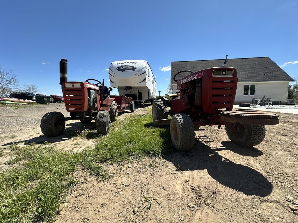

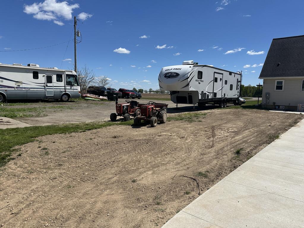

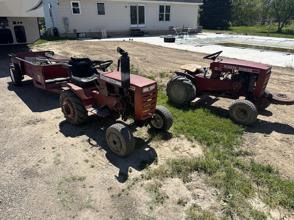

Pullstart 70,101 #172 Posted May 14 Between the B-121 and the 1445, I got more land leveling and rock picking done today. I pulled the cultivator around a bit to bust some of the top rocks out and did a lot of manual raking too. I plan to soak/germinate some rye grass seed for 24 hours, then heavy dunk every 12 hours in paint straining bags and 5 gallon buckets of water here soon. Once the seeds begin to sprout I’ll mix them with some dry fertilizer and broadcast about this earth, once dampened. Apparwntly that method can grow decent grass in a week or so. I doubt it’ll be perfect, and I might need to replant some, but I’m excited to try it! 4 Share this post Link to post Share on other sites
Pullstart 70,101 #173 Posted May 14 I have 18 lbs of perennial rye grass in paint strainer bags soaking in tepid water for 24 hours, then I’ll dip it every 12 thereafter. Once it begins to sprout, I’ll mix it 1:1 with some dry yard fertilizer and broadcast the prepared soil. It should only take a couple days to be ready! 5 Share this post Link to post Share on other sites

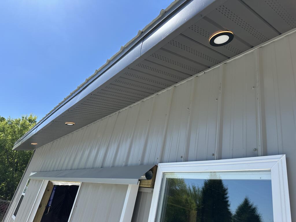

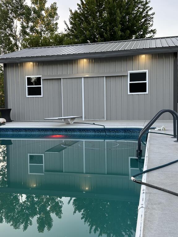

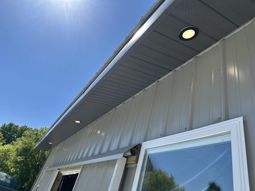

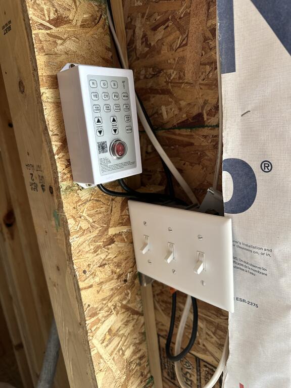

Pullstart 70,101 #174 Posted June 3 On 4/30/2026 at 3:44 PM, Pullstart said: Fence components ordered Still waiting on the 30 fence panels, but my neighbor graciously lent me a temporary fence system for the pool to be opened! I started wiring the lights too. The new pool light is no longer line voltage to the pool, I’m excited about that. I did however run wiring through a GFCI breaker. 6 1 Share this post Link to post Share on other sites

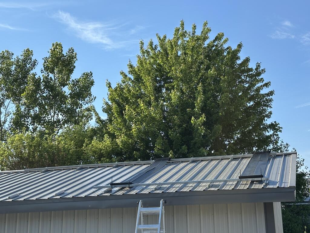

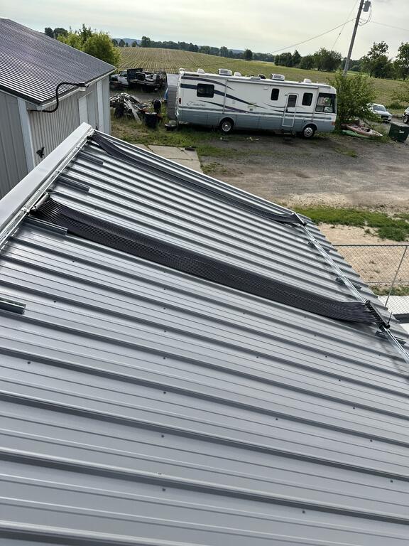

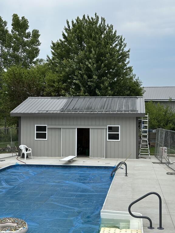

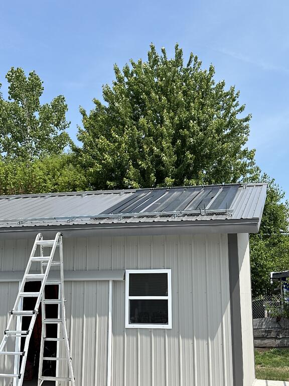

Pullstart 70,101 #175 Posted Tuesday at 02:14 PM Grass is kind of coming up, I think I compacted it too much and the water is not holding amazing. It’s spotty, but ok. I used a few chunks of unistrut and built a frame on the roof. I used some sticky foam seal between the 1’ strut and the roof, and attached it well. The solar system I built gives me high hopes that people will be in the water sooner than later! It’s about 15’ wide and the runs are 10’ vertically. I can add more width fairly easy, but I want to get it up and running before I make a decision whether to add to it or not. There is a total of 20’ of unistrut width currently, but I can extend that too. The manifold will be piped with “reverse return” piping in mind. It will go in one end of the bottom, and out the other end. The combination of 90s on opposite corners (capped pipes) and tees in the rest of the run will force water to flow evenly through the system no matter how long it is. In theory. 3 Share this post Link to post Share on other sites
