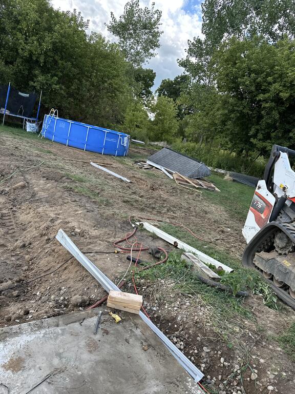

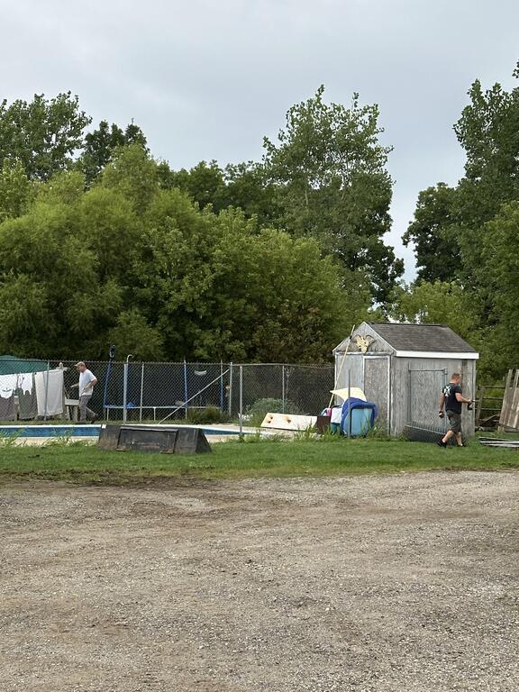

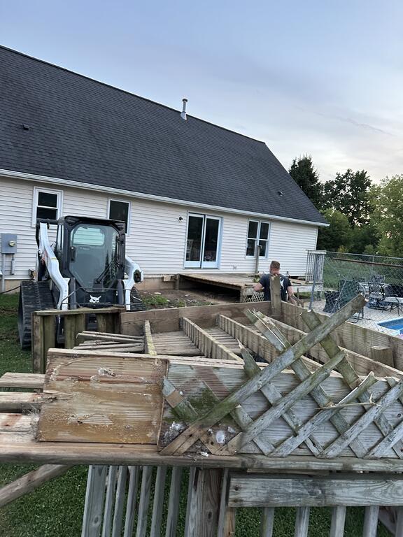

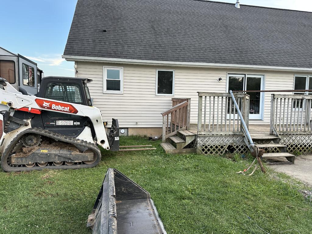

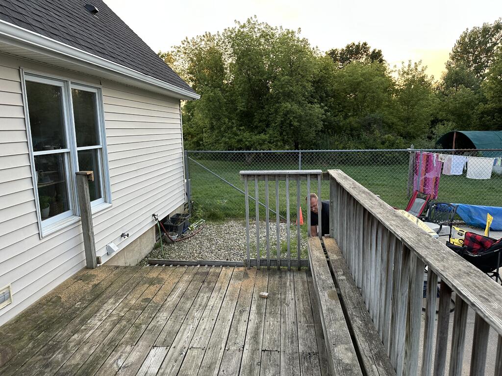

Pullstart 71,223 #1 Posted August 26, 2025 I figured it might be a decent idea to start this thread. It’s a major undertaking, but many necessities are being taken care of in one project. We will have two graduation open houses in the next two years and many family functions end up here during summer months. Winter too, I suppose. 1. Our deck was in rough shape. We could re-do the deck boards, but it was also a very poor size and design. It’s gone now! 4 Share this post Link to post Share on other sites

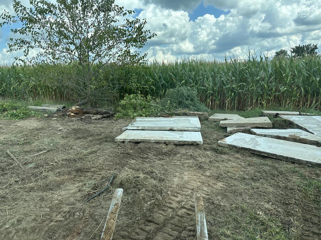

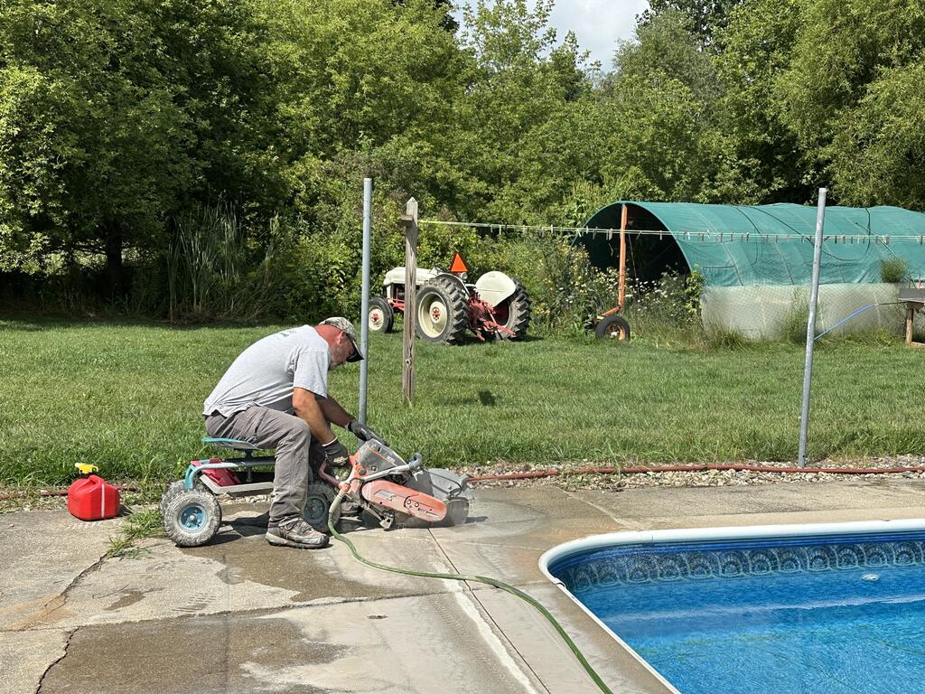

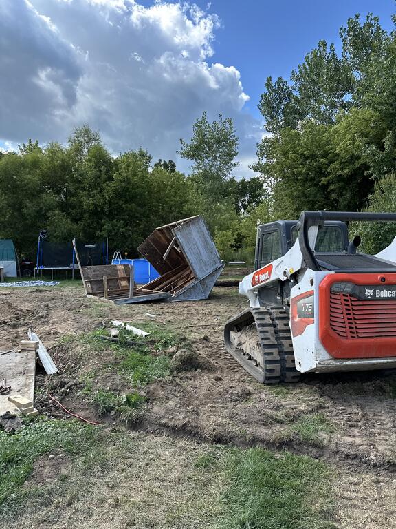

Pullstart 71,223 #2 Posted August 26, 2025 I did some welding work and have done some maintenance / repairs on a neighbor and friend’s equipment lately. Instead of charging him, I banked rental time. For example, the dump truck had major tailgate issues and I remedied the route problem in a simple way. Same for his mini excavator when the track blew off on a side hill and the grease zerk fitting stripped out. I took care of it cheaper and faster than most mobile wrench shops might have. 2. The concrete was very broken, un-level and a trip hazard for all ages. It was also quite small around the pool and we were quoted nearly $13,000 to level the slabs and epoxy seal the cracks. I ended up with a quote for $14,000 to pour much larger concrete, and will pour a bit around the back of the house to support the A/C unit and encapsulate the propane line. We roasted the deck and pulled up the cement. 6 2 Share this post Link to post Share on other sites

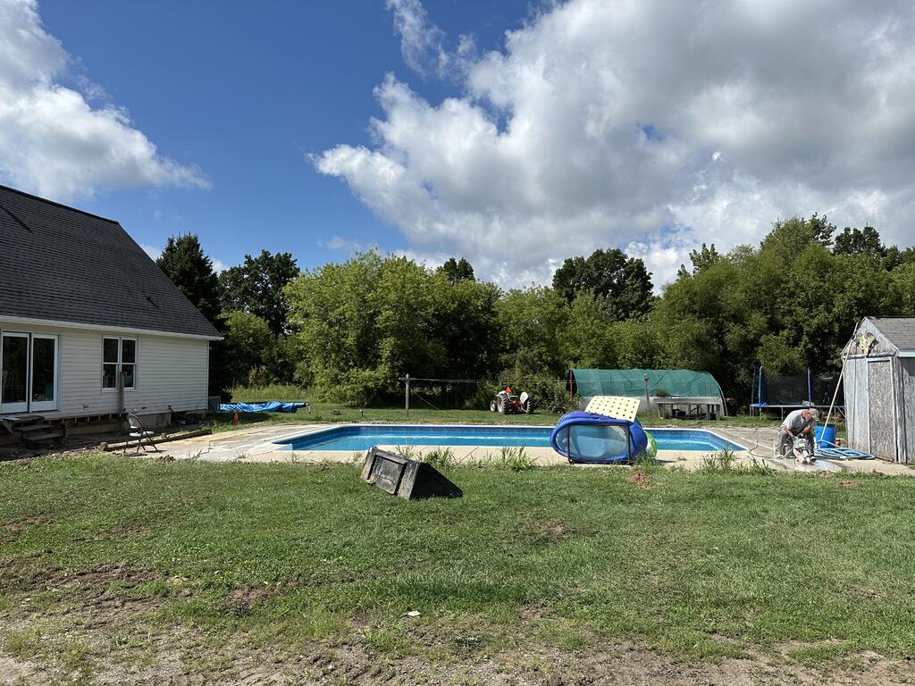

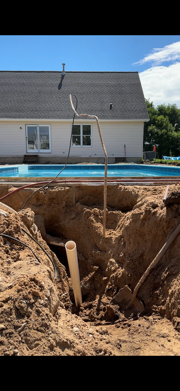

Pullstart 71,223 #3 Posted August 26, 2025 3. Pool leak, pool piping update. We were quite surprised this spring to open the pool, and it was nearly empty. I managed to use blue food coloring in a Tony Chatcherie food injection syringe to prove the bottom drain/return pipe had water flow out of it. A test plug proved to stop the water loss. Come to find out, the 1990’s flexible pipe used in pool plumbing was soy based. Mice, worms, and even ants like to chew on it. Time to update to schedule 40 pipe. @Bow_Extreme I’m going 2”! 7 1 Share this post Link to post Share on other sites
wallfish 20,576 #4 Posted August 26, 2025 8 hours ago, Pullstart said: We roasted the deck and pulled up the cement. Please don't burn pressure treated wood because of all the chemical toxins and heavy metals involved. The ash is also poisonous so be careful. AI states even a teaspoon of the ash could be lethal. Yes it's more of a PITA to get rid of but... Illegal to burn PT lumber in all 50 states. Delete the evidence! Looking forward to seeing the finished project 3 1 1 Share this post Link to post Share on other sites

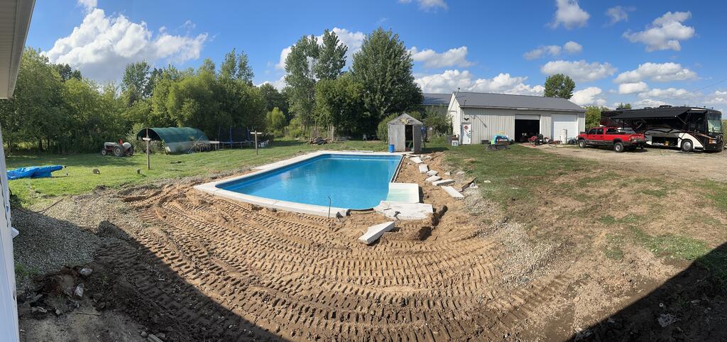

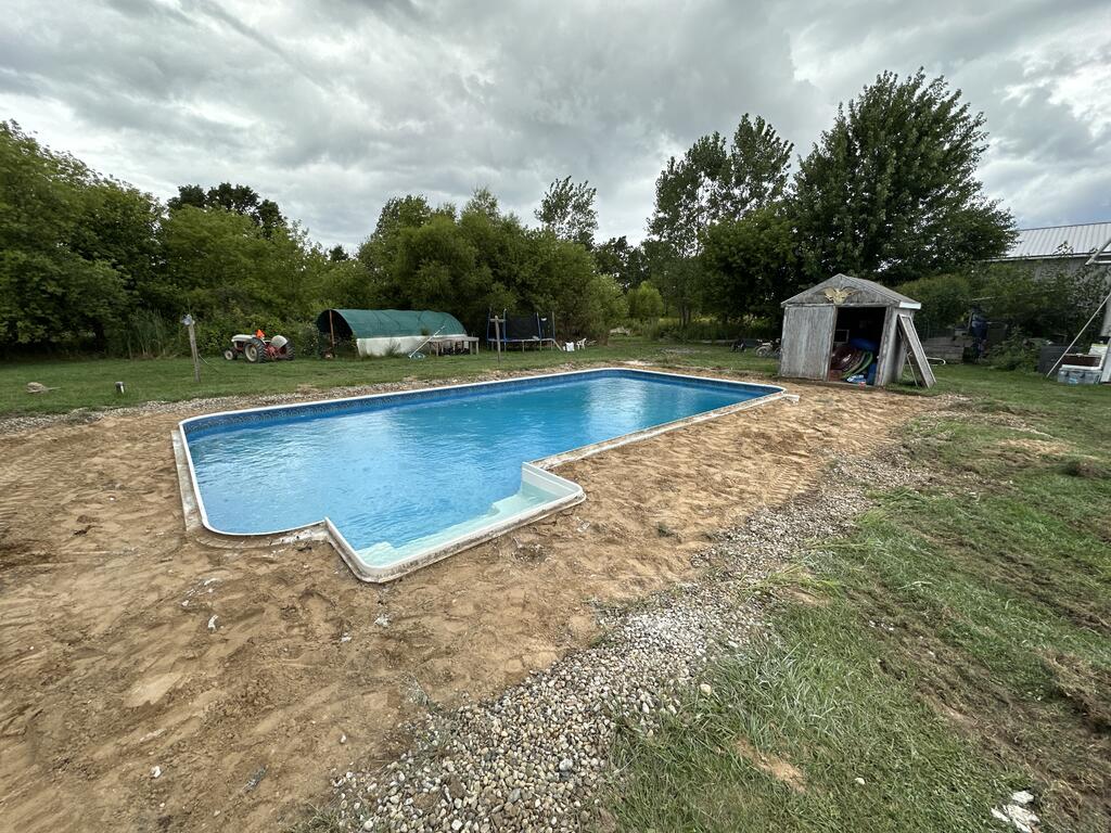

Pullstart 71,223 #10 Posted August 29, 2025 (edited) On 8/27/2025 at 7:51 AM, Bow_Extreme said: Isn't that pipe on the bottom side of the pool? yes, our bottom drain is an issue. The pool store fella and I decided I’d stub in a pipe as deep as possible using repipe, and plumb it through the new slab as if all were normal. In the next 2-5 years when we need to replace the liner, we will dig into the back of the deep end and tie into that pipe, replacing the drain basin and all. For now, the test plug will remain in the drain pipe that is currently there, and that pipe will stay in the ground just under the new slab to keep that straw tall. Less likely to siphon out… This 2” pipe is 10’ long and completely below grade. The 45 degree sidewall of the deep end is vermiculite. I am pretty sure I sunk my 2” auger down to the absolute bottom of that corner. It should be near touching and easy to find, perfectly in line with the drain. Edited August 29, 2025 by Pullstart 2 Share this post Link to post Share on other sites

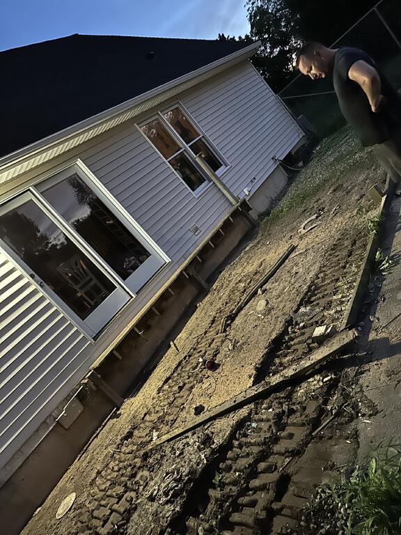

Pullstart 71,223 #14 Posted August 30, 2025 Every project has its victories and setbacks. We found the boiler lines… 2 Share this post Link to post Share on other sites

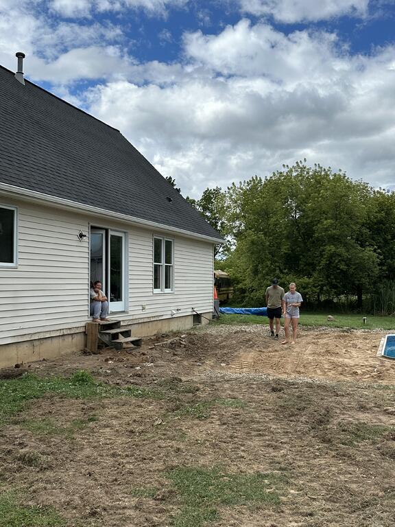

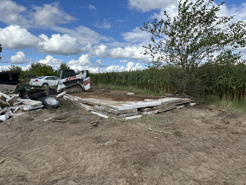

Pullstart 71,223 #17 Posted August 31, 2025 The shed did not make the move. Bummer, but I have a blank slate for concrete! 4 Share this post Link to post Share on other sites

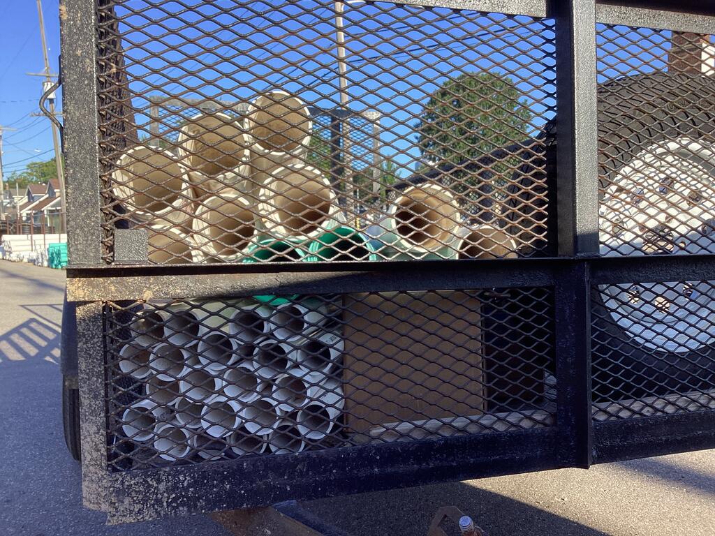

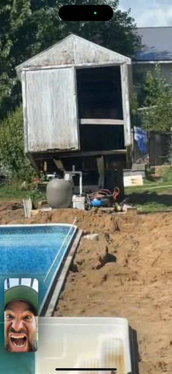

Pullstart 71,223 #18 Posted September 1, 2025 All our 1-1/2” piping was soft sided SOY BASED piping. Since we were there, we replaced everything with hard 2” PVC schedule 40. I ran a chase from the house as well, for an auto fill water line, and anything else needed. 2 3 Share this post Link to post Share on other sites

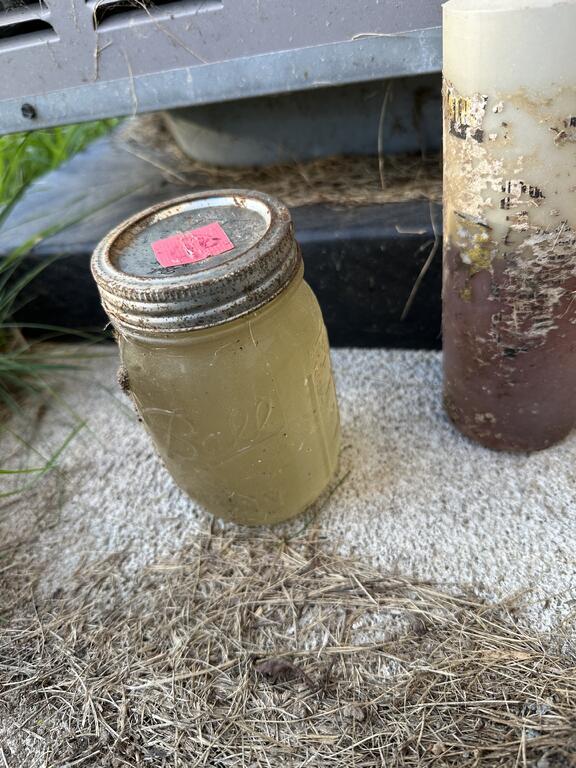

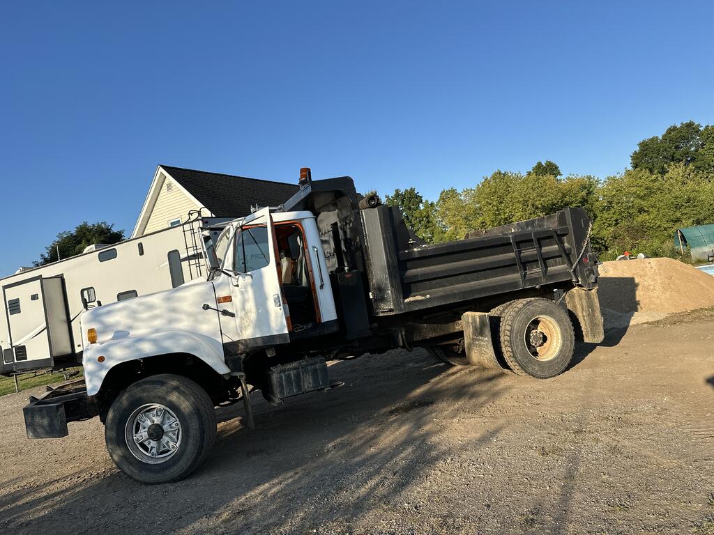

Pullstart 71,223 #25 Posted September 2, 2025 Yesterday I successfully found the sump pump outlet pipe, and the LP line on the side of the house. With the mini excavator! Oops… the LP company will be replacing and updating the line with something more modern. We will sleeve it through a 2” PVC pipe in the concrete. The drain line needed to be deeper for the concrete anyway. I also found a jar of shine squirreled away behind my A/C unit. I don’t recall doing that, it must of been good! Today, I don’t know how many loads of sand I hauled out of the pit down the road. I think 35-40 yards of sand has been trucked in. 3 Share this post Link to post Share on other sites
