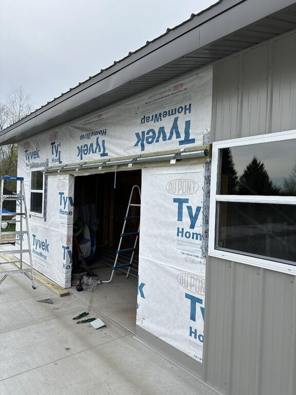

Pullhosen’s Pony Express 98 #126 Posted October 10, 2025 41 minutes ago, rjg854 said: Well now that's something I've never seen before, Tyvek on a roof. I suppose it should be ok. It was actually quite slippery when dry! I just wanted to shed water and I had this. It’s probably not ideal but it does currently work. 2 1 Share this post Link to post Share on other sites
rjg854 13,454 #127 Posted October 10, 2025 As long as it's doing what you want it to do, that's the important thing. Are planning on shingles? I don't see why you couldn't leave it for that purpose too. 1 Share this post Link to post Share on other sites
Pullstart 71,561 #128 Posted October 10, 2025 2 hours ago, rjg854 said: As long as it's doing what you want it to do, that's the important thing. Are planning on shingles? I don't see why you couldn't leave it for that purpose too. Steel 1 Share this post Link to post Share on other sites
Handy Don 17,735 #129 Posted October 10, 2025 16 hours ago, WHX?? said: So isn't 24 OC for our snow loading For our area, and for steeply pitched, we were well within the code--I made sure to confirm with the architect! 😀 1 Share this post Link to post Share on other sites
Handy Don 17,735 #130 Posted October 10, 2025 2 hours ago, Pullhosen’s Pony Express said: It’s probably not ideal but it does currently work. It does allow vapor-sized molecules to pass through slowly. 1 Share this post Link to post Share on other sites

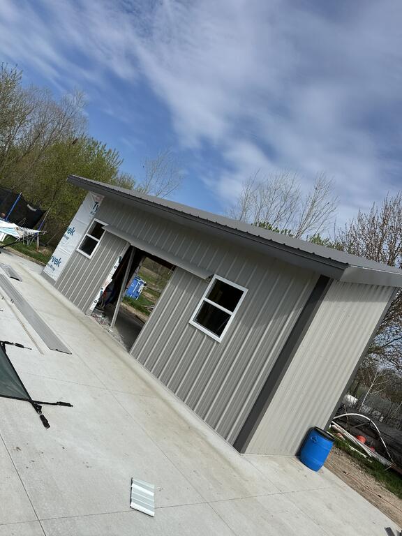

Pullstart 71,561 #131 Posted October 11, 2025 The construction is pretty much wrapped up. Time for making it weather proof! 3 3 Share this post Link to post Share on other sites

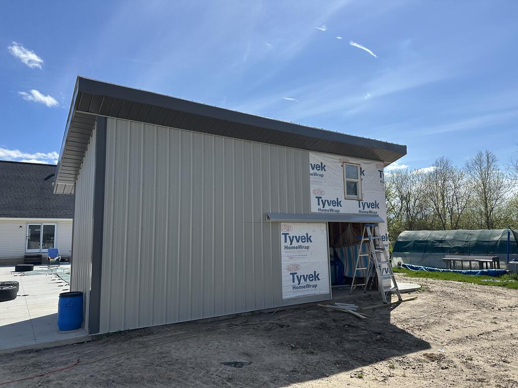

Pullstart 71,561 #132 Posted April 19 Yep, I’m still grinding away on this. I have 34 or so days until Jada’s graduation party. Most every piece needs to be cut to length and trimmed somehow to fit. It’s time consuming, so I am using whatever dry weather I have to get it done. 6 4 Share this post Link to post Share on other sites

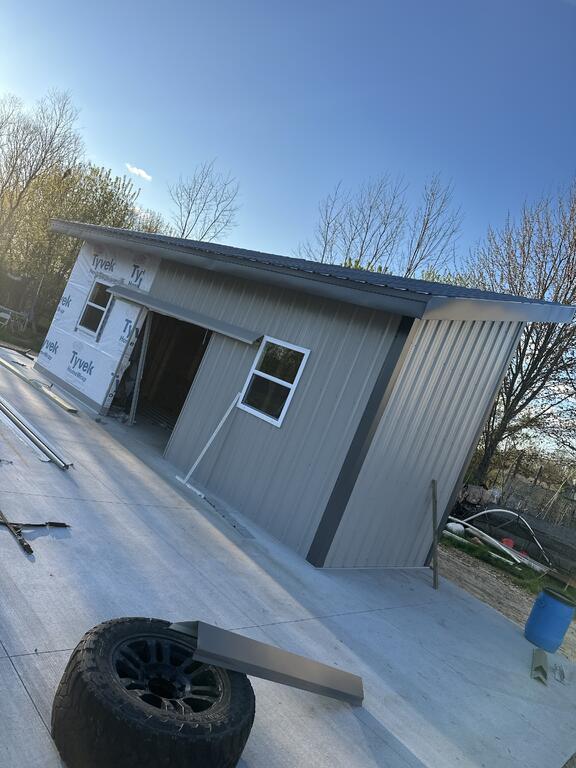

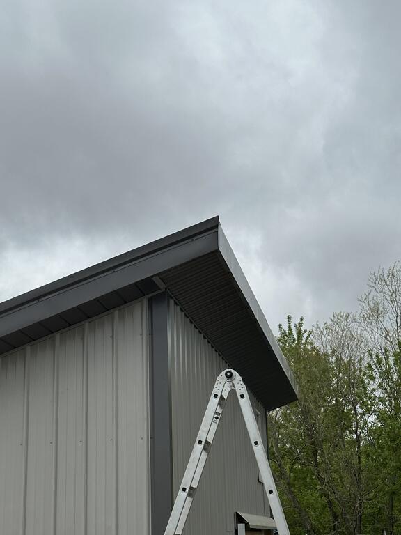

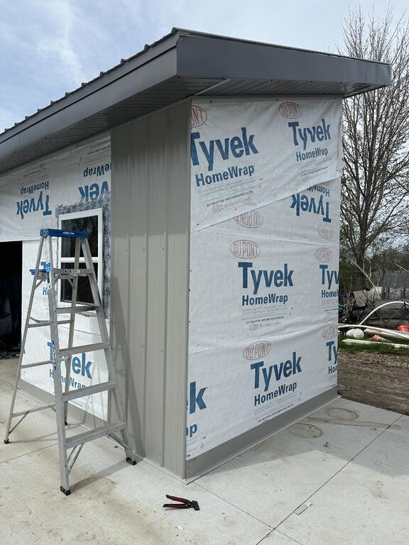

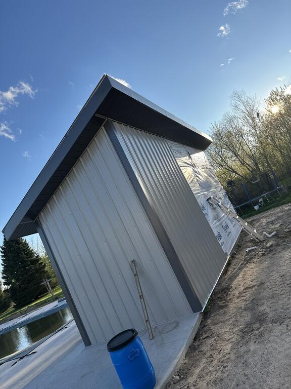

Pullstart 71,561 #137 Posted April 20 There’s lots of work today to get 70 square foot of steel mounted up! Back window and door openings are cut out, window is in and I need to trim and seal it up. Back sliding door track is installed and trimmed as well. 9 3 Share this post Link to post Share on other sites

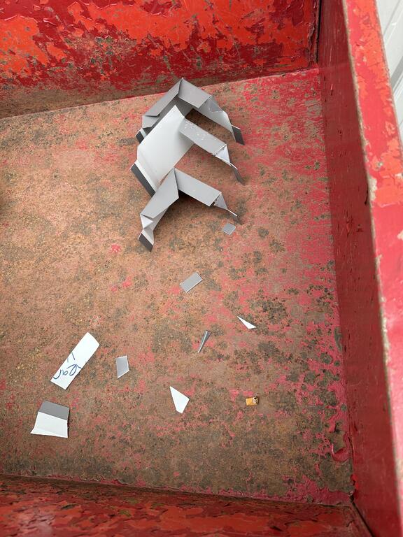

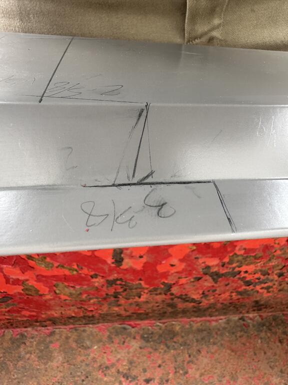

Pullstart 71,561 #141 Posted April 21 I screwed up a couple pieces. Or they aren’t screwed up. I had to order a couple more pieces, but can still work on the front. 5 1 Share this post Link to post Share on other sites

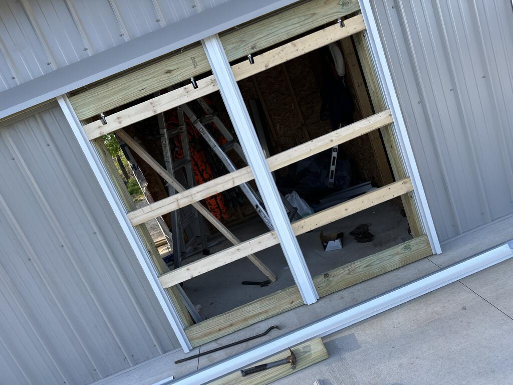

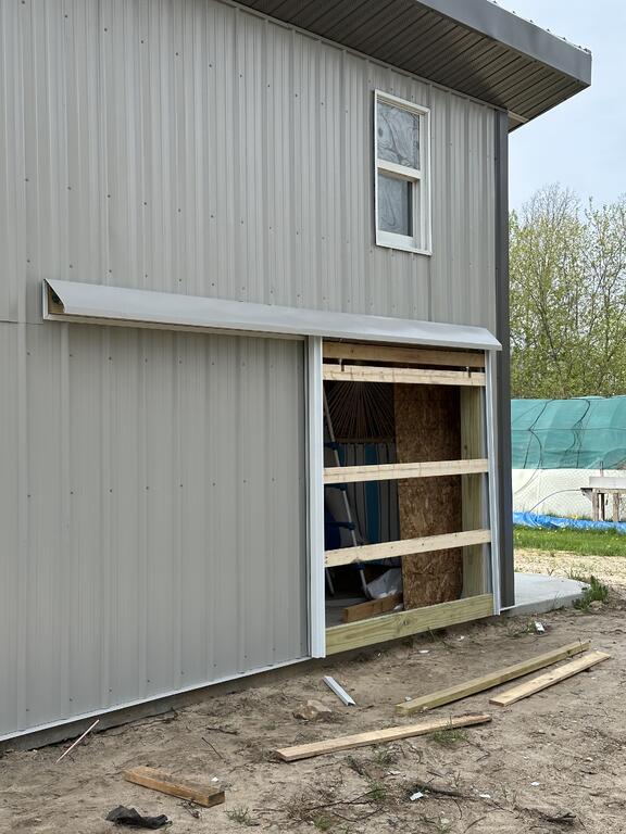

Pullstart 71,561 #142 Posted April 27 I have the door frames built and hung. I am brainstorming my method of door closure. If possible, I’d like to prevent any more holes in the concrete. However, I have no other access to latch from the inside. Then, I’ll install bottom trim and the sheet steel. 4 1 Share this post Link to post Share on other sites
Pullstart 71,561 #143 Posted April 27 I have four of these style latches coming. There wasn’t anything locally that I could find. My thoughts are to make a keyhole slot in the angle bracket (or use a chunk of unistrut with a slotted hole) and stick another roll pin through the end of the rod. Push in, quarter turn. Low enough to hold the door bottoms closed and possibly another latch to hold it open as well. There are so many methods of keepers, rollers, etc. it’s hard to say the right or wrong way to hold a rolling door open! Share this post Link to post Share on other sites

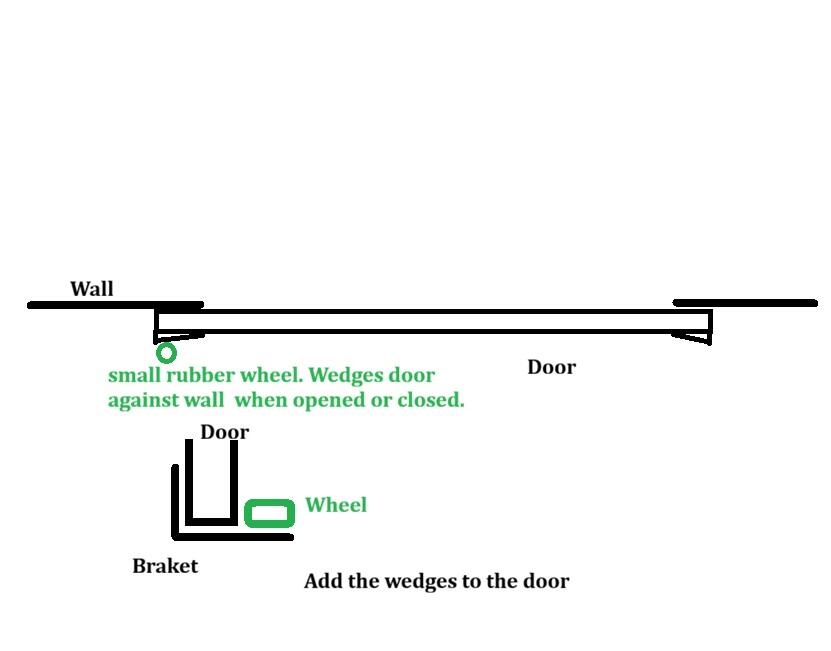

wallfish 20,744 #148 Posted April 28 Spit balling ideas My sliders only wedge to lock in the closed position 2 Share this post Link to post Share on other sites
Pullstart 71,561 #149 Posted April 28 That’s simple and easy John. I like it! Now will it work with my doors? 1 Share this post Link to post Share on other sites

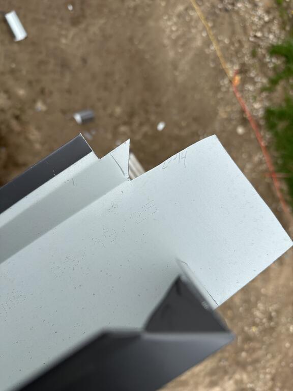

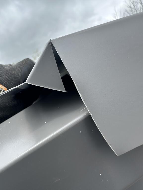

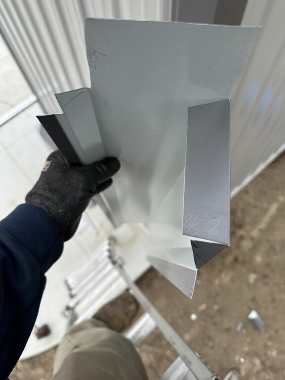

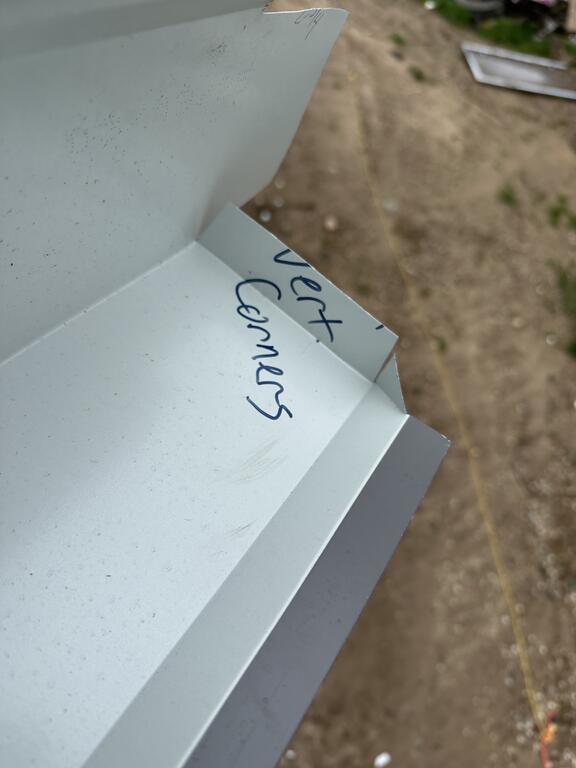

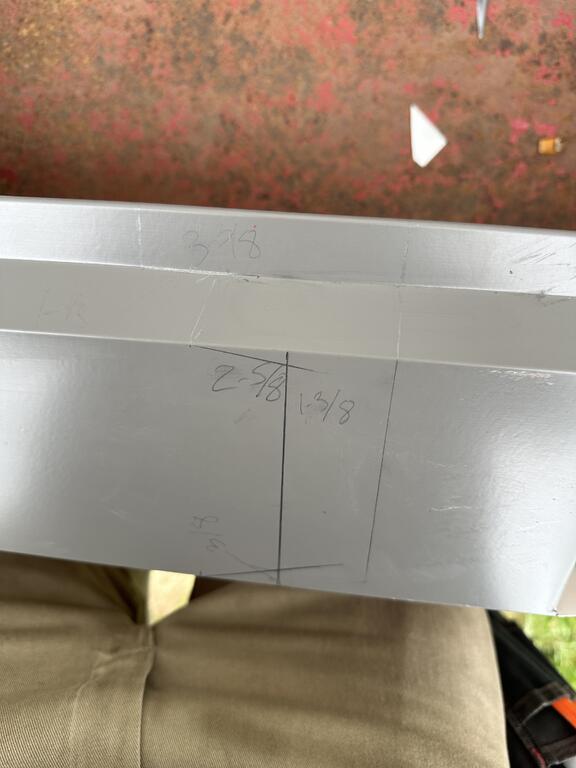

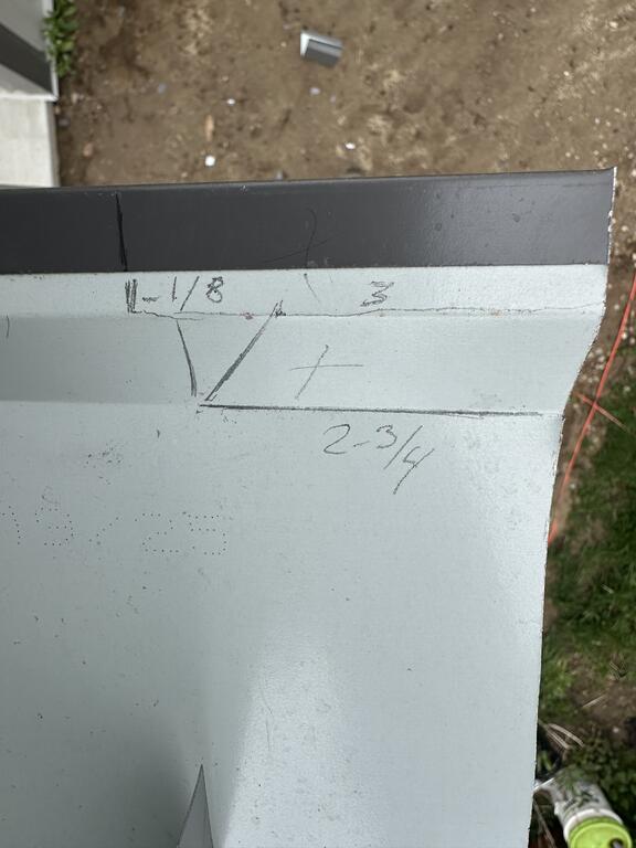

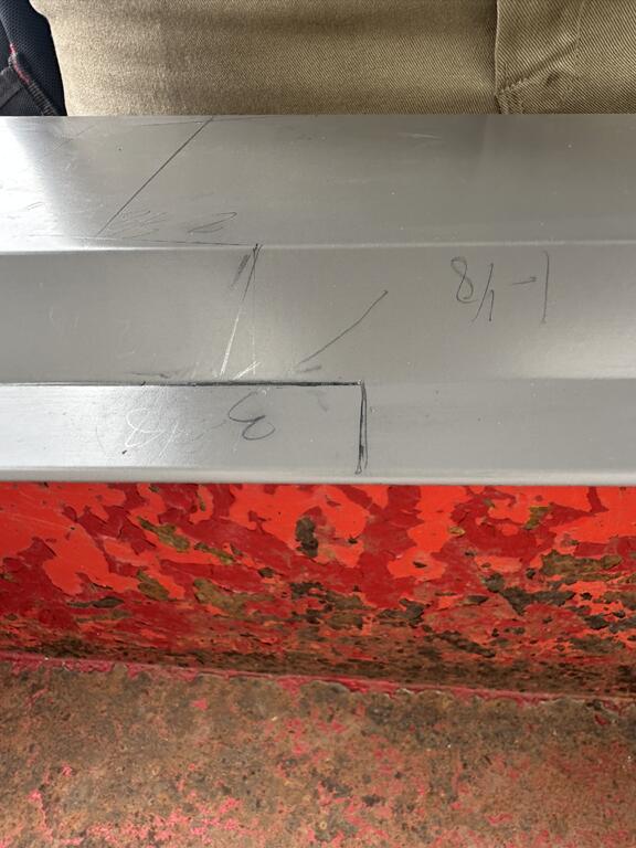

Pullstart 71,561 #150 Posted April 28 One last trim edge to do, and I’m glad to have a little extra material. Lots of compound angles to trial and error and error and error and figure and error some more. I’m hopeful that I will get this corner all mathed out, so the opposite will be equal measurements and easy to pop on. 5 Share this post Link to post Share on other sites
