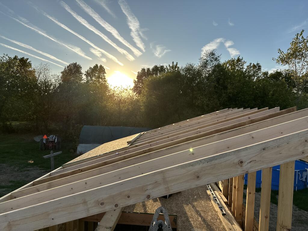

Pullstart 71,561 #101 Posted October 6, 2025 Another fast forward for real-time progress: 4 3 Share this post Link to post Share on other sites
Pullstart 71,561 #102 Posted October 6, 2025 One stick at a time… 2 Share this post Link to post Share on other sites
Pullstart 71,561 #103 Posted October 6, 2025 It’s supposed to start thunder storming any minute. I just got off the roof, and it’s ready to shed water! 2 2 Share this post Link to post Share on other sites
Handy Don 17,735 #104 Posted October 7, 2025 Ready for gusty wind, too? Share this post Link to post Share on other sites
Handy Don 17,735 #105 Posted October 7, 2025 1 hour ago, Pullstart said: It’s supposed to start thunder storming any minute. I just got off the roof, and it’s ready to shed water! Ready for gusty wind, too? Share this post Link to post Share on other sites
Pullstart 71,561 #106 Posted October 7, 2025 12 hours ago, Handy Don said: Ready for gusty wind, too? not really, but it’s better than nothing currently Share this post Link to post Share on other sites

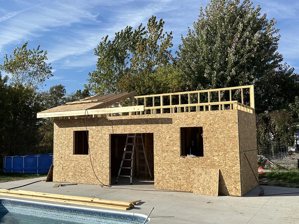

Pullstart 71,561 #109 Posted October 8, 2025 The to do list is shrinking! 1 Share this post Link to post Share on other sites

WHX?? 58,387 #112 Posted October 8, 2025 1 hour ago, 953 nut said: OSHA, Wisconsin would love me! Funny but not correct ... I travel that road on my way to Spike Camp and there is no OSHA there! I like that out building Kev. Screw the pool crap tho I could get 10 in there plus the loft for the hood collection! Why on earth did you not pitch the roof to the back? Would have no runoff to the pool area. No ice build ups no drip lines. No doors freezing up. 4 1 Share this post Link to post Share on other sites
953 nut 70,648 #113 Posted October 8, 2025 11 minutes ago, WHX?? said: Funny but not correct ... I travel that road on my way to Spike Camp and there is no OSHA there! If you blink you would miss it. No OSHA in this picture either. 4 Share this post Link to post Share on other sites
SylvanLakeWH 32,919 #114 Posted October 8, 2025 17 minutes ago, WHX?? said: Why on earth did you not pitch the roof to the back? Would have no runoff to the pool area. No ice build ups no drip lines. No doors freezing up. Was thinking the same thing, but I'm not as good lookin' as Kevin so... 1 Share this post Link to post Share on other sites
Pullstart 71,561 #115 Posted October 8, 2025 2 hours ago, WHX?? said: I like that out building Kev. Screw the pool crap tho I could get 10 in there plus the loft for the hood collection! Why on earth did you not pitch the roof to the back? Would have no runoff to the pool area. No ice build ups no drip lines. No doors freezing up. I built it with the “backwards” roof in mind for a couple reasons. First, south facing pane means I can build me a massive solar heat collector for the pool plumbing. Second, I have room for a lean to off the back Third, I have no need for winter access, so frozen doors is not an issue. Additionally, the pool is sloped like a trough between the pool shed and the pool itself. Water runs to the center of the two, then sideways away from the diving board. 2 Share this post Link to post Share on other sites
Pullhosen’s Pony Express 98 #116 Posted October 9, 2025 Overkill is the story here. Surprise! A double top plate allows for 24” center spacing on the roof rafters. I chose double plate and 16” centers. My span allowed 2x6s to be used. I chose 2x8s. 3 Share this post Link to post Share on other sites
Handy Don 17,735 #117 Posted October 9, 2025 Last roof construction I had a say in, we used trusses on 24’s with double top plates. Deliverer hoisted them with a truck boom (2-story building) and a crew of two positioned and secured. 22 trusses in three and a half hours. Later added hurricane hold-down clips and did final alignment while sheathing. 1 Share this post Link to post Share on other sites
Pullstart 71,561 #118 Posted October 9, 2025 3 hours ago, Handy Don said: Last roof construction I had a say in, we used trusses on 24’s with double top plates. Deliverer hoisted them with a truck boom (2-story building) and a crew of two positioned and secured. 22 trusses in three and a half hours. Later added hurricane hold-down clips and did final alignment while sheathing. I do have hurricane ties as well to install on these. 2 Share this post Link to post Share on other sites
ebinmaine 81,278 #119 Posted October 9, 2025 6 hours ago, Handy Don said: hurricane hold-down clips Those and/or huge screws are code required here Share this post Link to post Share on other sites
WHX?? 58,387 #120 Posted October 10, 2025 (edited) Double top plate is pretty standard. So isn't 24 OC for our snow loading. I woulda went with 19 & a diamond. You ain't worried about that sheeting being so closed to the concrete rotting out?? Edited October 10, 2025 by WHX?? speeling Share this post Link to post Share on other sites
Pullstart 71,561 #121 Posted October 10, 2025 1 hour ago, WHX?? said: You ain't worried about that sheeting being so closed to the concrete rotting out?? I did think about that. It’s 3/4” off the concrete and I plan to flash it the best I can. I’m checking the budget now on vinyl vs steel siding. I think I’ve got about $2k into the structure now, maybe $2,500. I was quoted $3,100 for steel to finish it! Share this post Link to post Share on other sites
WHX?? 58,387 #122 Posted October 10, 2025 (edited) Seems a little high on the steel. We got Amish folk here that supply steel woulda been less than 1k. That woulda been my choice. Steel wainscot?? Tell ya what would look good is fake stonework. Edited October 10, 2025 by WHX?? 1 Share this post Link to post Share on other sites
