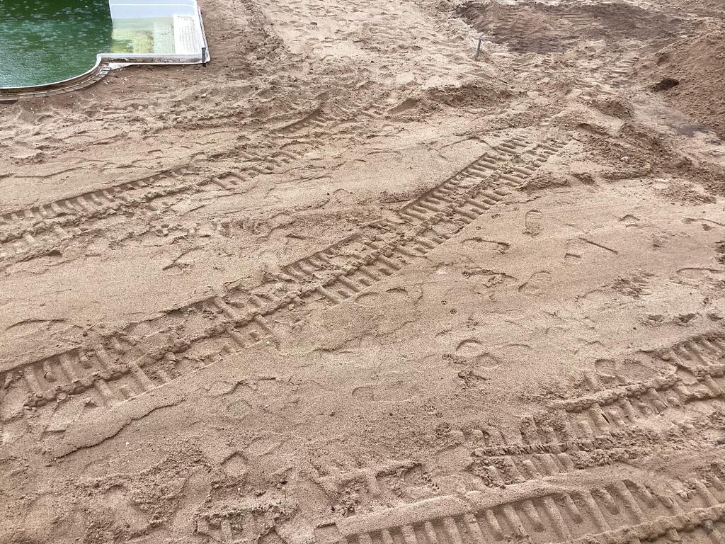

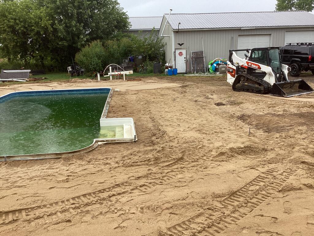

Handy Don 17,735 #35 Posted September 4, 2025 Haven’t seen a plate compactor in use yet in any of your vids. I am hoping the excavation contractor is compacting in layers on the backfills. Just running a bobcat back and forth isn’t generally considered adequate compaction of soil. 2 Share this post Link to post Share on other sites
Pullstart 71,561 #36 Posted September 4, 2025 47 minutes ago, Handy Don said: the excavation contractor is me We have had some massive rains, and I have also been compacting too, wetting down the deep areas of fill (trenches), etc. We will bring in a gas powered compactor too come Monday, after forms are set. 2 Share this post Link to post Share on other sites

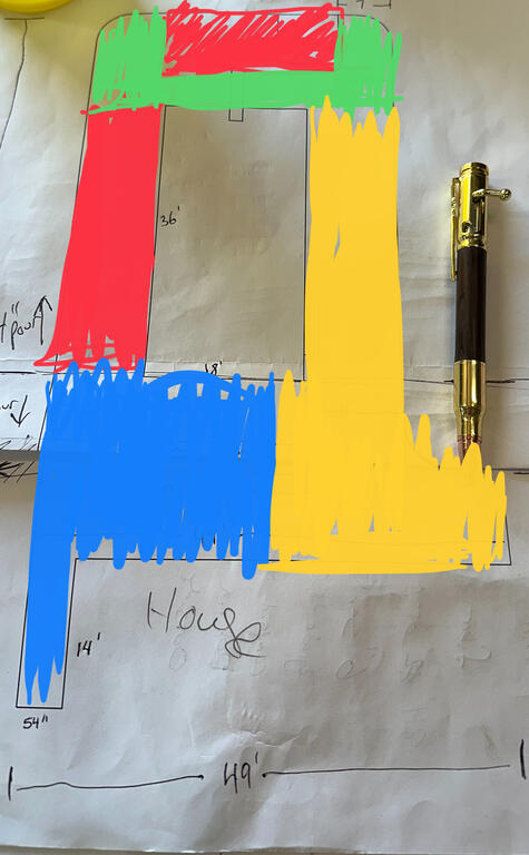

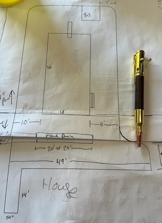

Pullstart 71,561 #45 Posted September 8, 2025 This is the general drawing of the pool plan. We ended up moving the pool house back 3’ for a larger gap between the diving board and the pool house doors. The pool house will now be 8’x24’x10’ sidewall. Tomorrow we pour the blue section. Wednesday morning the red sections, and in the afternoon the green. Thursday morning we finish with the yellow. Hopefully when we’re done, the rainbow will all be grey scale! 2 Share this post Link to post Share on other sites
Wayne0 1,666 #46 Posted September 8, 2025 Nice pen. 2 1 Share this post Link to post Share on other sites
953 nut 70,648 #47 Posted September 8, 2025 20 minutes ago, Pullstart said: Tomorrow we pour the blue section. Wednesday morning the red sections, and in the afternoon the green. Thursday morning we finish with the yellow. Hope the concrete finishers can stay inside the lines, unlike you. 7 Share this post Link to post Share on other sites
Pullstart 71,561 #48 Posted September 9, 2025 8 hours ago, Wayne0 said: Nice pen. That’s a bolt action exotic wood custom from one of my father inlaw’s coworkers. 3 Share this post Link to post Share on other sites
