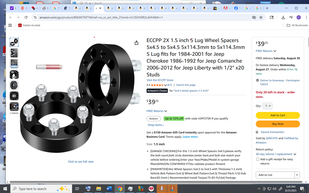

Sublauxation 17 #8 Posted August 25, 2025 So this should work: 7/16 x20 lug bolts with a taper to center the spacer on the hub (spacer has 1/2 inch hole but I'm guessing this would just sit a bit deeper? Then just drill out the wheel lug holes to 1/2 and use the tapered lug nuts or should I just buy some flat 1/2 lug nuts? I never measured, the lug bolts are 7/16 x 20 aren't they? Share this post Link to post Share on other sites
ebinmaine 80,657 #9 Posted August 25, 2025 4 minutes ago, Sublauxation said: These will likely be too short. I'll PM you with the info I use. Share this post Link to post Share on other sites
Sublauxation 17 #10 Posted August 25, 2025 13 minutes ago, ebinmaine said: These will likely be too short. I'll PM you with the info I use. That was a concern, I was looking at 1" spacers but was worried that these wouldn't sit below the new face for the wheel, Likewise, some concern that they aren't long enough for 1 1/2 spacers What width spacer did you use, seems most do 2" I would be a bit worried that the lug nuts you showed may be too long to sit below the face on the 1 1/2" spacer so maybe just go with 2"? Share this post Link to post Share on other sites

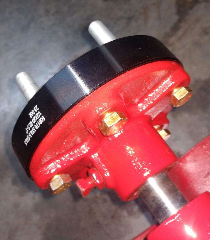

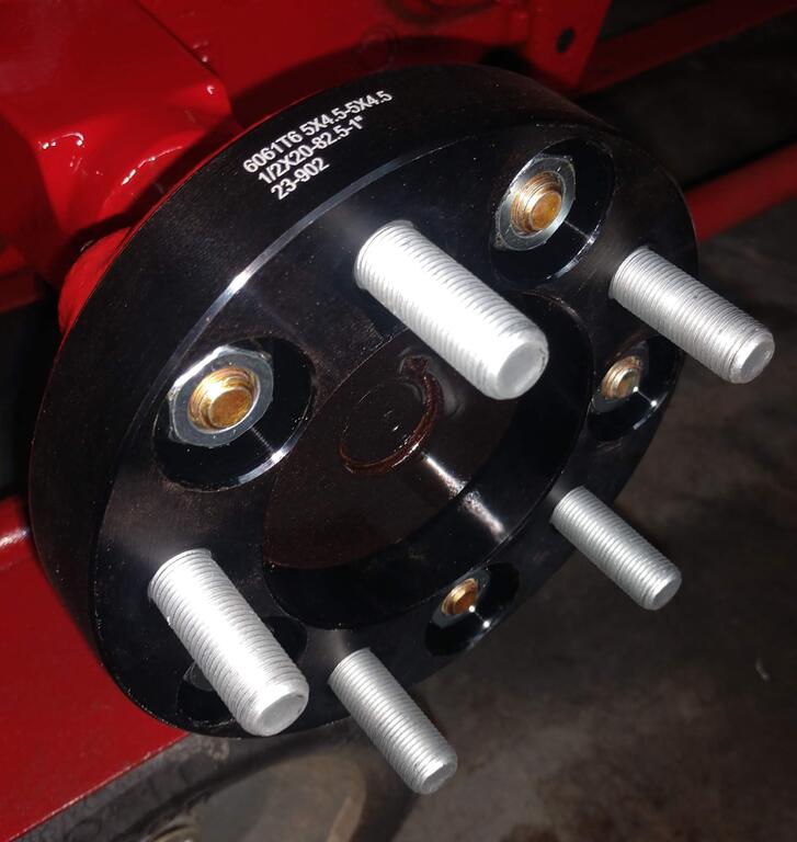

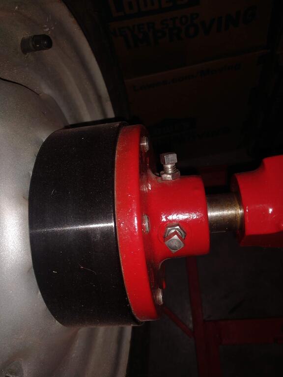

kpinnc 18,940 #15 Posted August 25, 2025 (edited) Keep in mind a couple things: if you go too big on spacers (about an inch) you won't be able to use a Wheel Horse mower deck again, unless your tractor will carry a 48 or 60 inch deck. 1.5 inch spacers are about the max with a 48 inch deck and it's very close. Tire size and brand are factors here. Hub centric spacers won't work. Plus the spacers you use must be large enough to get around the hub face center. Measure yours before buying spacers. Also those studs in your picture don't work well. Likely they are too big to get a socket inside the spacer holes with them. Either use 7/16 x 20 bolts from the back and lug nuts to attach the spacers- or studs with raised heads. These are pretty expensive, but won't interfere with the axle bolts in the hub. Both types are shown below. Also you will need to ream out the holes on your wheels to 1/2 so the spacer studs will fit. It's only 1/16 larger so if you go back to OEM bolts they will still work with factory bolts. Edited August 25, 2025 by kpinnc Share this post Link to post Share on other sites

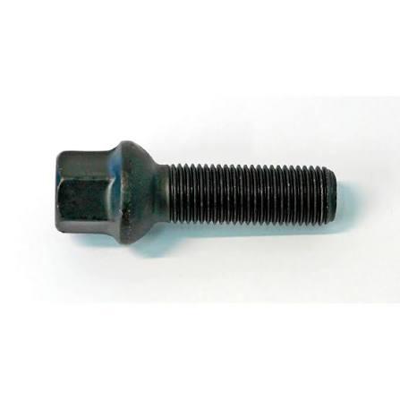

8ntruck 9,296 #17 Posted August 26, 2025 (edited) Probably worth a mention - there are several types of lug nut or stud tapers. In safety critical applications (cars, trucks, busses, high speed side by sides, etc.) they should not be mixed - the lug nut or stud needs to match the nut seats in the wheel. If they don't, the stud or nut will loose torque, which hastens a wheel failure. The stud @kpinnc posted a picture of has a spherical surface to clamp a matching spherical surface on a Wheel. This is typical on a late model VW product - other Europen makes as well. Just about all American automotive applications use a 60 degree chamfer. Agricultural vehicles commonly have 90 degree chamfers. Wheel Horse seems to have used both 60 degree and 90 degree chambers on different models. My 1973 14-8 uses 60 degree chambers. My early 80's C-195 uses a 90 degree chamber- at least as far as I can tell. Those short surfaces are tough to get a good angle measurement on. Again, on our tractor application, which is low speed and low load when compared to cars, tricks, busses, etc., it is possible to cheat and mix and match the various chamber contours. THIS DOES NOT MEAN THAT NO DAMAGE WILL HAPPEN IF ONE DOES MIX CHAMFER TYPES. Lug nut torque will still be lost, which ALWAYS LEADS TO ACCELERATED WHEEL FAILURE. If you choose to mix chamfer types, you NEED TO CHECK LUG TORQUE FREQUENTLY. Edited August 26, 2025 by 8ntruck 1 Share this post Link to post Share on other sites
