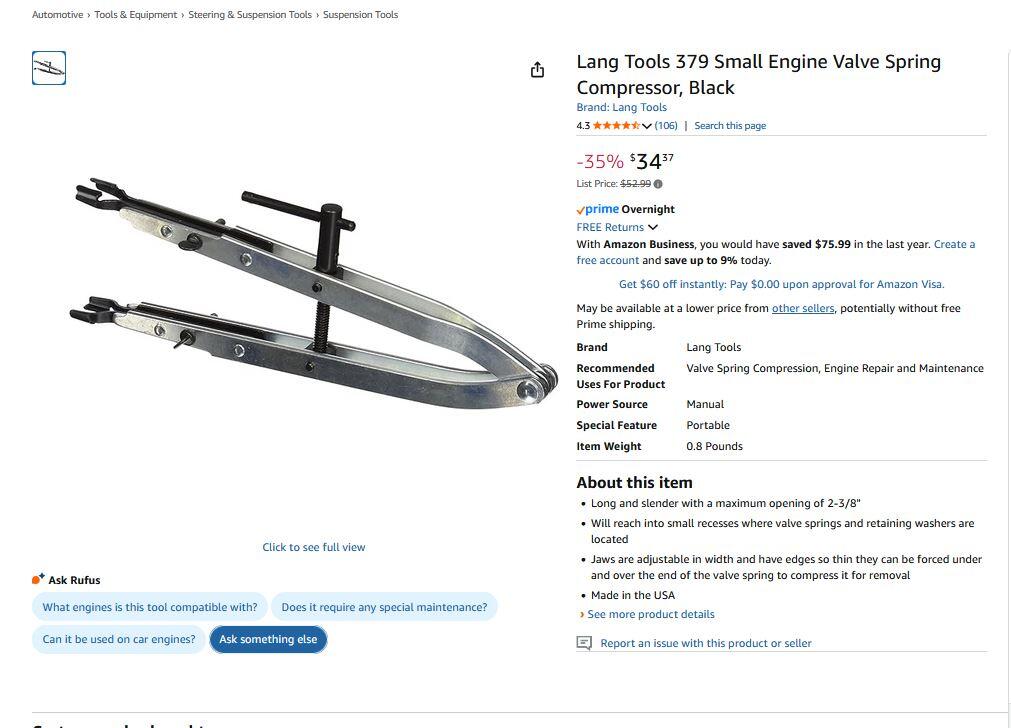

horseman with no horse 68 #1 Posted August 23, 2025 ive looked looked high, ive looked low, ive looked too and fro, and yet to find a flat head compatible spring compressor locally. anybody got any suggestions? maybe i can make one out of a c clamp? Share this post Link to post Share on other sites
ri702bill 12,811 #2 Posted August 23, 2025 Check the Jungle site - they have a Lisle Small Engine Valve Spring Compresser for sale. An automotive C-shaped overhead valve compressor - with the ratchet lock - is what I use..... 1 1 Share this post Link to post Share on other sites
rmaynard 17,527 #3 Posted August 23, 2025 Amazon Lisle 23300 Small Engine Valve Spring Compressor https://a.co/d/3HgUpNR 1 Share this post Link to post Share on other sites
953 nut 68,503 #5 Posted August 23, 2025 I use an old Craftsman "C" type valve spring compressor I've had for over fifty years, works well. 1 Share this post Link to post Share on other sites
pfrederi 21,046 #6 Posted August 23, 2025 or one like this 1 2 Share this post Link to post Share on other sites

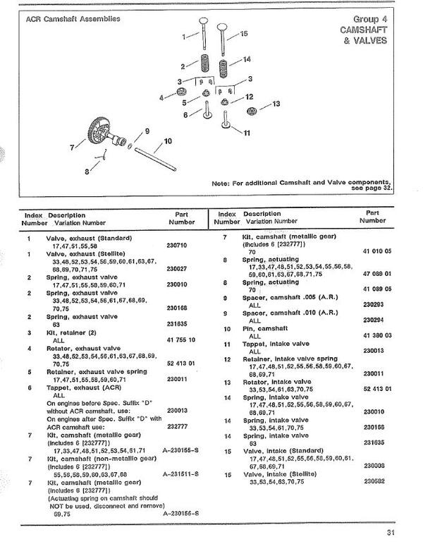

horseman with no horse 68 #7 Posted August 28, 2025 getting further in the process, making sure to get the breather gaskets, and i was wondering about valve seals? https://www.rehlkoenginesparts.com/oemparts/a/koh/61857321855d461d14599d90/camshaft-valves-4-2-51-tp-2045-b here's kohlers breakdown for my exact spec number of k181 and number 4 and 13 look like seals but i cant find the part number anywhere. Share this post Link to post Share on other sites
oliver2-44 11,694 #8 Posted August 28, 2025 I am not aware of any Kohler K series engines that use valve seals 1 1 Share this post Link to post Share on other sites
Gasaholic 390 #9 Posted August 28, 2025 10 hours ago, horseman with no horse said: here's kohlers breakdown for my exact spec number of k181 and number 4 and 13 look like seals but i cant find the part number anywhere. Ain't none. The horizontal shaft L-Head engines didn't need them. (Oil follows the path of gravity, y'know?) Ive rebuilt everything from K-91 to K582 K series , only ones I ever saw using valve seals (Sometimes) were the twin opposed, but otherwise they never had, nor used them. 1 Share this post Link to post Share on other sites
pfrederi 21,046 #10 Posted August 28, 2025 4 and 13 are valve rotators Your variant is #51 you do not get them and there are no seals... 3 Share this post Link to post Share on other sites

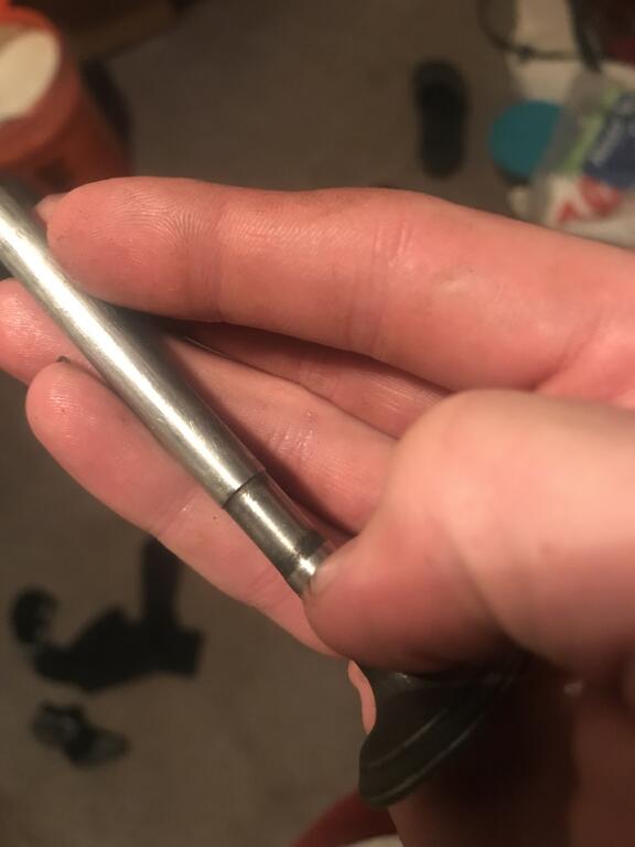

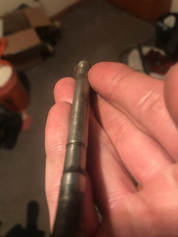

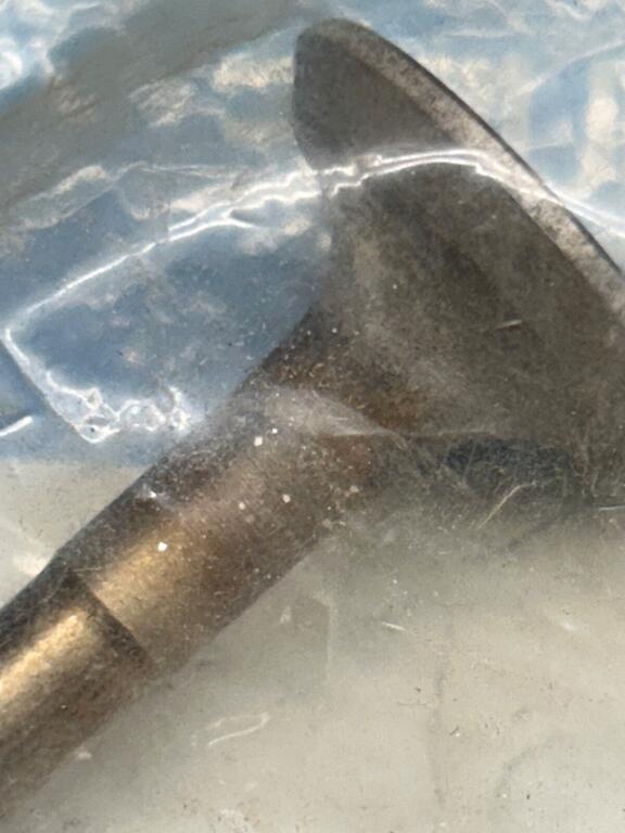

horseman with no horse 68 #12 Posted September 9, 2025 (edited) whelp i got the valves out. the exhaust has a very good sized ridge in the spot on the stem that rides the guide in the block. im definitely wanting to get a new valve. on the subject of replacing guides..... how difficult would that be? Edited September 9, 2025 by horseman with no horse Share this post Link to post Share on other sites
horseman with no horse 68 #13 Posted September 9, 2025 or is that valve stem wear not gonna reflect on the guide? Share this post Link to post Share on other sites
lynnmor 9,010 #14 Posted September 9, 2025 (edited) That may not be wear, check a new valve to see if it has that undercut. Replacing valve guides is usually a matter of having a punch with a pilot of the correct size and pressing or hammering it out. Edited September 9, 2025 by lynnmor 1 Share this post Link to post Share on other sites
horseman with no horse 68 #15 Posted September 9, 2025 sadly i have to buy a new valve anyway lol i ground the stem to like 24 thou and im not willing to lap it any longer. im more concerned about the guides. if you dont think its wore then im happy. also whats the best way to take material off the stem to set the lash? Share this post Link to post Share on other sites
