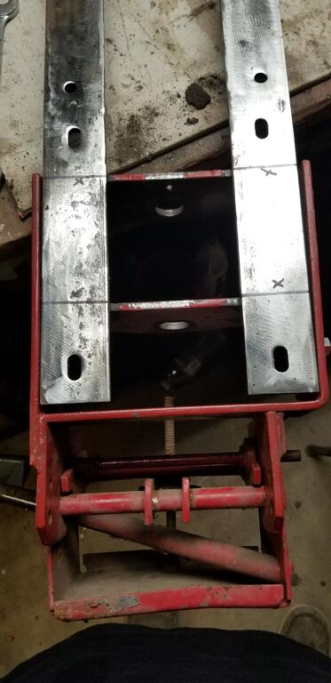

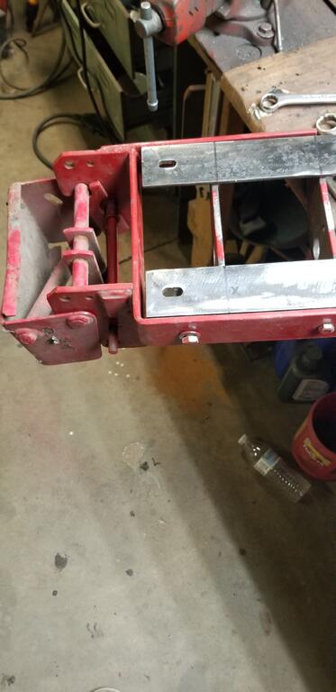

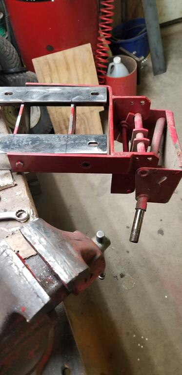

mrc 1,109 #7 Posted August 22, 2025 hi madjack, i have never owned a GT14. however, i do own a bronco 14. the bronco is pre 1973. therefore it used the old style attaching system and tensioner. i upgraded my bronco with front and mid tach-a-matic system. with the tach-a-matic system you can use any attachment or deck from 1973-2007. i do not know if you can add tach-a-matic to your gt14. perhaps others will chime in. regards mike Share this post Link to post Share on other sites
oliver2-44 11,694 #8 Posted August 22, 2025 That GT 14 frame is wider than all the models that is the attach a matic. However you can take the mid mount attach a matic brackets and put them on the inside of the frame and they will work. There are some threads on here of how to mount the mule drive to make it work. Cut to fit, paint to match. 1 Share this post Link to post Share on other sites
gt14rider 1,278 #9 Posted August 23, 2025 You can make a mount, it is offset 1" to the right. the midmount can be moved to the inside of the frame, like @oliver2-44 stated above. Share this post Link to post Share on other sites
