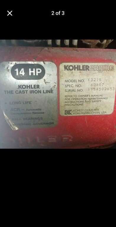

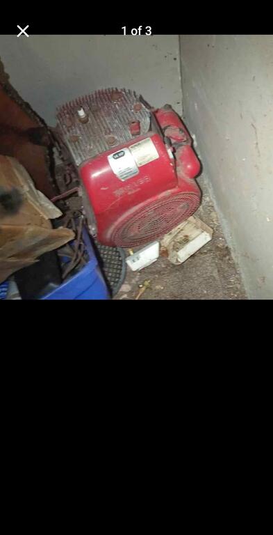

chrisg802 1 #3 Posted August 20, 2025 Ok this is the engine it looks pretty much identical to whats in mine now Share this post Link to post Share on other sites
ebinmaine 80,881 #4 Posted August 20, 2025 1 hour ago, chrisg802 said: hey everyone i am new to wheel horse tractors. i recently bought a c-100 and i love it but it could use some more power for what i would like to use it for. with that being said i found a 14hp engine near me for a good price and im wondering if i can take the 8hp out and put the 14hp in. wondering more so if it can be done relatively easy without all kinds of crazy modifications. You state above your tractor has an 8 HP. Your C100 should have a 10 HP. Any pics of the existing engine? What specifically is the task you're doing that needs more HP? 46 minutes ago, chrisg802 said: Ok this is the engine it looks pretty much identical to whats in mine now This engine is missing the top cover sheet metal. That's pretty Important... Share this post Link to post Share on other sites

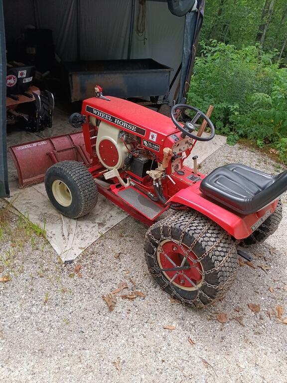

chrisg802 1 #5 Posted August 20, 2025 Your are right sorry I was looking at getting another wheel horse before posting this and got it confused. But yes my C100 is a 10 hp. I would love to get a snowblower and a blade for it but I was told the single stage blowers aren't that great so I would love to put a 2 stage on it then I came across that 14hp engine and figured more power would be more better haha... realistically I know some stuff I'd like to use it for like pulling my homemade box blade is a bit much for it but I can't afford a "full size" tractor so I have to work with what I have 1 Share this post Link to post Share on other sites
pfrederi 21,215 #6 Posted August 20, 2025 Was made for Toro but that 14 hp has a very short crankshaft on the PTO end I do not think it would work with a WH PTO 2 Share this post Link to post Share on other sites
chrisg802 1 #7 Posted August 20, 2025 Ok thanks glad I asked before buying it Share this post Link to post Share on other sites
ebinmaine 80,881 #8 Posted August 20, 2025 4 minutes ago, chrisg802 said: Your are right sorry I was looking at getting another wheel horse before posting this and got it confused. But yes my C100 is a 10 hp. I would love to get a snowblower and a blade for it but I was told the single stage blowers aren't that great so I would love to put a 2 stage on it then I came across that 14hp engine and figured more power would be more better haha... realistically I know some stuff I'd like to use it for like pulling my homemade box blade is a bit much for it but I can't afford a "full size" tractor so I have to work with what I have For a plow you'd be fine with 10 HP. Some use as little as 6. For a snowblower.... the single stage has its uses but overall the dual or two stage is preferred. The two stage was introduced by Wheelhorse when the 14 and 16 HP single cylinder Kohler were being phased out. Even a 14 would be marginal for a big snow with a two stage. Going slow would help. For a snow (front) or grader (middle) or box (rear) blade you'd be very interested in proper WEIGHT. Horsepower is obviously a concern but maybe not as much as you'd expect. 1 Share this post Link to post Share on other sites
ri702bill 13,162 #9 Posted August 20, 2025 (edited) On 8/20/2025 at 1:17 PM, ebinmaine said: you'd be very interested in proper WEIGHT. Exactly. Fluid filled tires (with tubes), additional weight in / on the wheels, proper tires and chains are needed for winter use when plowing, in order to provide proper traction... Additional rear weight hung off the tractor helps, but the additional weight in / on the tires is my preference, so as not to overload the axle bearings. Edited August 22, 2025 by ri702bill 2 1 Share this post Link to post Share on other sites
ebinmaine 80,881 #10 Posted August 20, 2025 1 hour ago, ri702bill said: , but the additional weight in / on the tires is my preference, so as not to overload the axle bearings. Agreed. @chrisg802 I can share some YouTube videos from the past several years of both me and my Other Half moving snow on various tractors. This rig: Has 255 lbs of fluid ALONE plus the steel weights. Share this post Link to post Share on other sites
ri702bill 13,162 #11 Posted August 20, 2025 1 hour ago, ebinmaine said: Agreed. @chrisg802 I can share some YouTube videos from the past several years of both me and my Other Half moving snow on various tractors. This rig: Has 255 lbs of fluid ALONE plus the steel weights. And add in the Big Bear on the seat too...! 1 Share this post Link to post Share on other sites
ebinmaine 80,881 #12 Posted August 20, 2025 23 minutes ago, ri702bill said: And add in the Big Bear on the seat too...! Me Bear 🐻 250 plus. Tractor. 625. Plow frame & 60" wide monster plow. At least 150 lbs. Fluid. 255. Steel. 130. Oversize wheels. ? Somewhere around 1400 pounds of snow moving mo-chine!! 3 Share this post Link to post Share on other sites
chrisg802 1 #13 Posted August 20, 2025 I mainly just want to run a snowblower i have a plow truck but a snowblower would be perfect for the beginning of my driveway as its tight and theres not alot of room for snow does anyone know if the c100 could have the mid mount blade on it? Share this post Link to post Share on other sites
953 nut 69,724 #14 Posted August 20, 2025 7 hours ago, chrisg802 said: c-100 and i love it but it could use some more power for what i would like to use it for. with that being said i found a 14hp engine near me for a good price and im wondering if i can take the 8hp out and put the 14hp in 11 minutes ago, chrisg802 said: anyone know if the c100 could have the mid mount blade on it? As others have said the 10HP will be fine for pushing snow with a blade and lots of people use a 10 HP for a blower too. You may need to use low range for a big heavy snowbank but it will get it done. The mid mount grader blade will work ell on a C-100 too. Share this post Link to post Share on other sites
