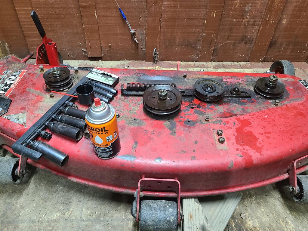

Cee245 853 #1 Posted August 12, 2025 Trying to replace noisy bearings on a 42" sd. And check idler pulley etc. I'm soaking in Kroil currently. I want to be extra careful with the double pulley's. (This one has bagger system.) Are there a few good tips you can share that have worked in the past WITHOUT damaging the pulley? I use a 1/2" impact to get the blades off and top nut on spindle. That is WAY easier than what I had to do 20 years ago! I've done several in the past, but I'm sure there are better methods out there.. Thanks! Share this post Link to post Share on other sites

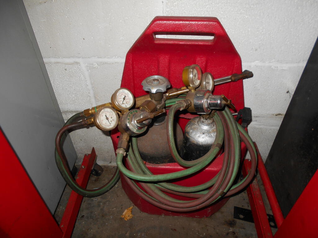

cleat 8,877 #4 Posted August 12, 2025 This pulley was seized onto the shaft of a 42" RD I rebuilt this summer. I applied lots of heat with an acetylene torch and the pulley loosened up. This little torch kit has saved my bacon lots of times. 1 Share this post Link to post Share on other sites

Cee245 853 #6 Posted August 12, 2025 (edited) I ordered a 2nd wonder bar. I've used one in the past on this, but didn't think to use 2 at same time! I'm limited using something like @cleat method because have a wood shed work shop. I don't want it to burn down again 😩 I do use a butane torch for heating stuff though Edited August 12, 2025 by Cee245 Share this post Link to post Share on other sites
