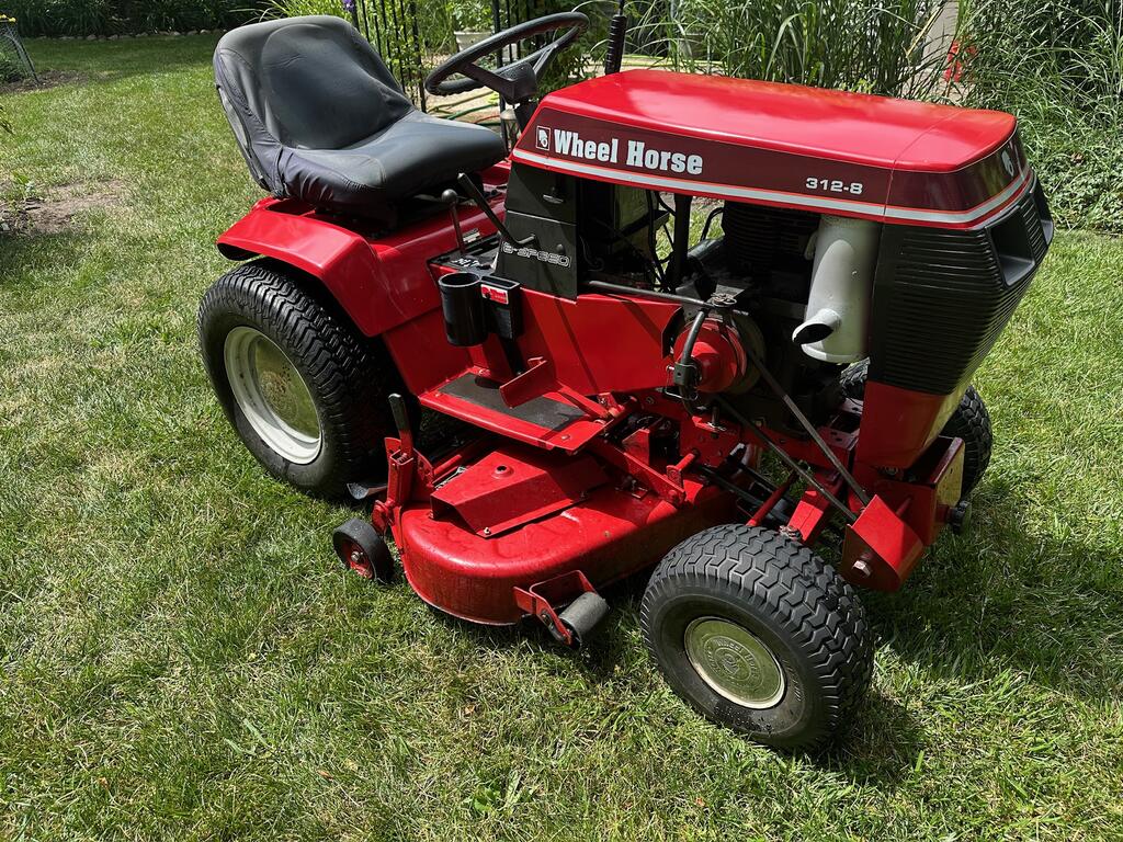

David78 6 #1 Posted August 8, 2025 Just bought my first Wheel Horse tractor. It's a 312-8 that's in great shape. Previous owner hadn't used it much in several years so I talked him in to partying with it. It runs and mows fantastic for an old tractor, but where it's sat for several years it needs some maintenance and tinkering and either the carburetor cleaned or rebuilt. It has the 42 inch deck and is in desperate need of new belts and blades. Was hoping someone could help me with correct belt and blade sizes. I'm going to change the drive belt, oil and filter, ait filter, fuel filter and transmission fluid all at the same time. Any help would be greatly appreciated. 1 2 Share this post Link to post Share on other sites
