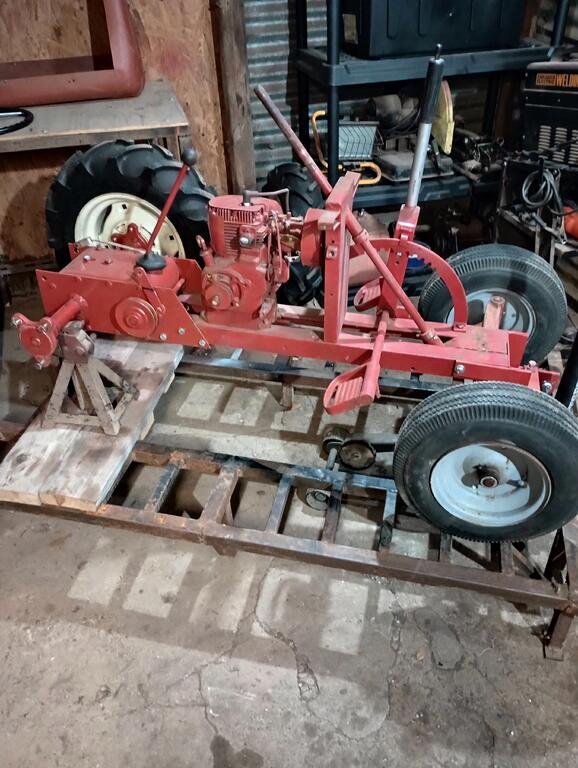

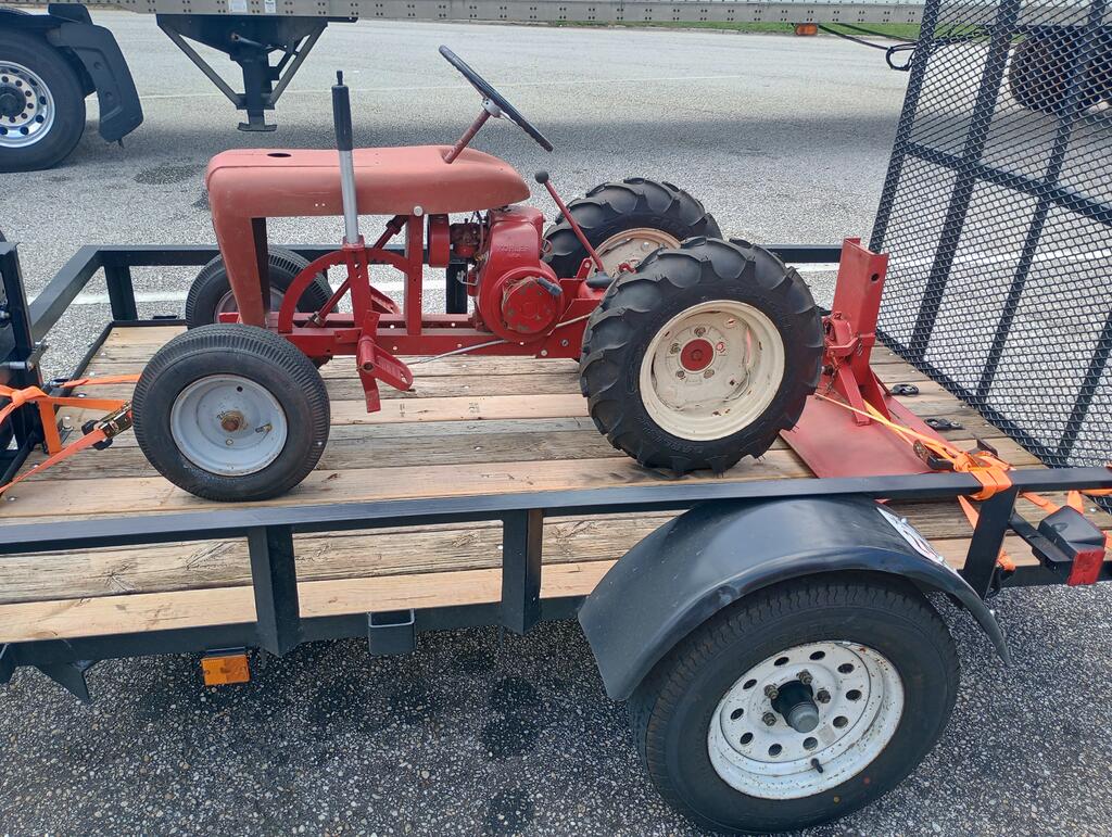

Chrishar 1,026 #1 Posted August 6, 2025 Here's the 400 I went and pickup in Florida just needs a little of TLC to get it going again 7 8 Share this post Link to post Share on other sites

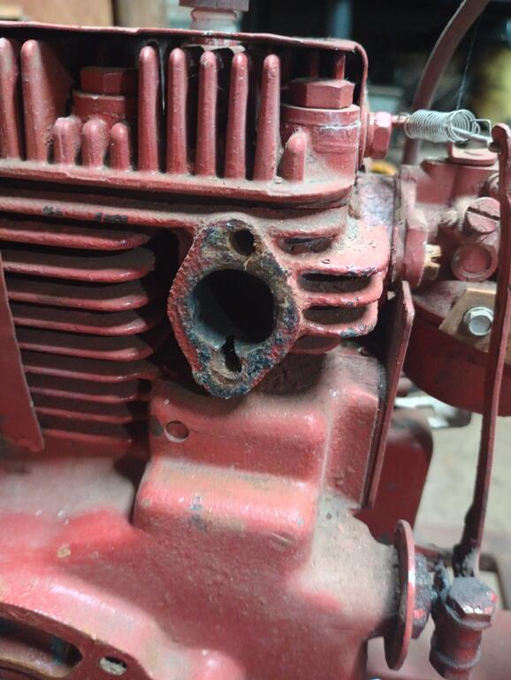

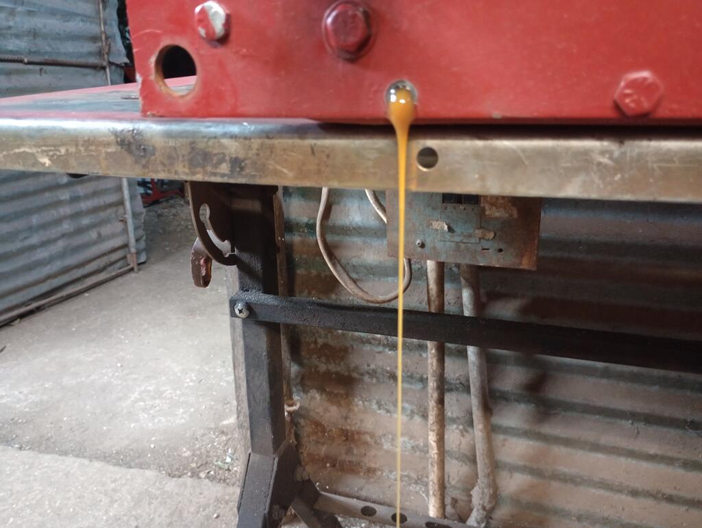

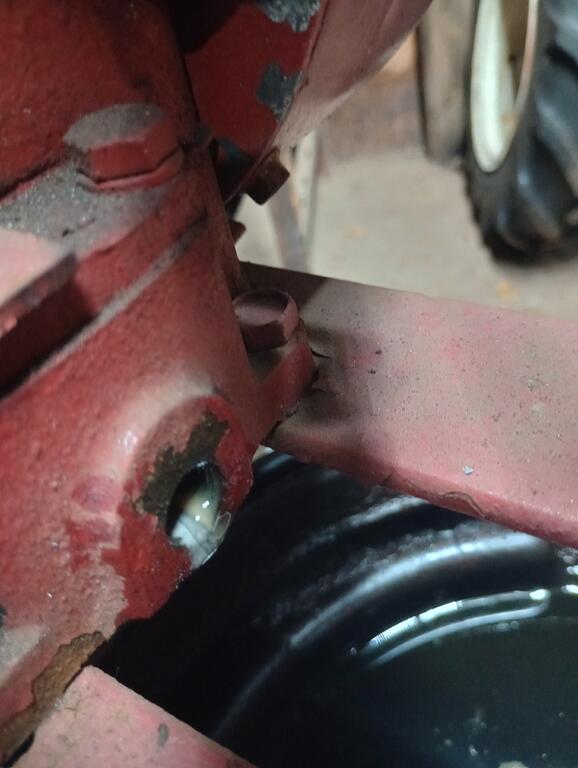

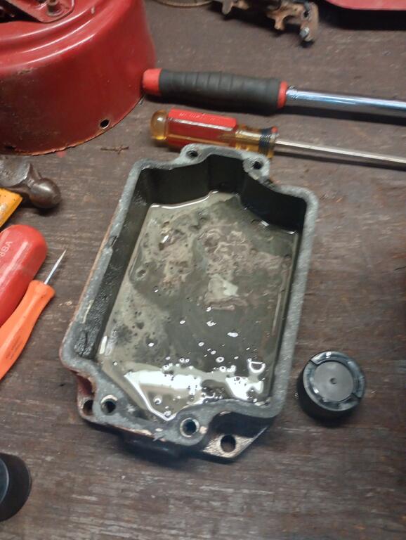

Chrishar 1,026 #2 Posted August 7, 2025 Started to look at some stuff found out the motor oil was over full and mikey looking so I decided to drain it and found water in it so I will have clean it out and look at it and got to fix the exhaust on the motor too that's what I found so far 2 Share this post Link to post Share on other sites
oliver2-44 11,610 #3 Posted August 7, 2025 @Chrishar I think I have a pipe tap to tap that Kohler exhaust like the suburbans originally had. 1 Share this post Link to post Share on other sites
Chrishar 1,026 #4 Posted August 7, 2025 That would be great if you have one oliver2-44 Share this post Link to post Share on other sites
clueless 3,421 #5 Posted August 7, 2025 (edited) Sorry about that, I never remover the cover that was on it. The water most like got in from there, it did sit outside off and on during the last 10+ years. Have you removed the head yet? Edited August 7, 2025 by clueless Share this post Link to post Share on other sites

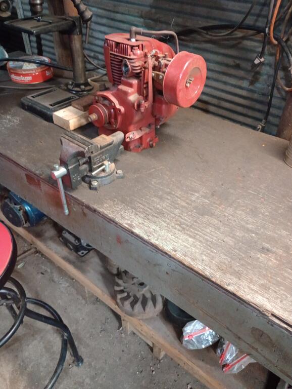

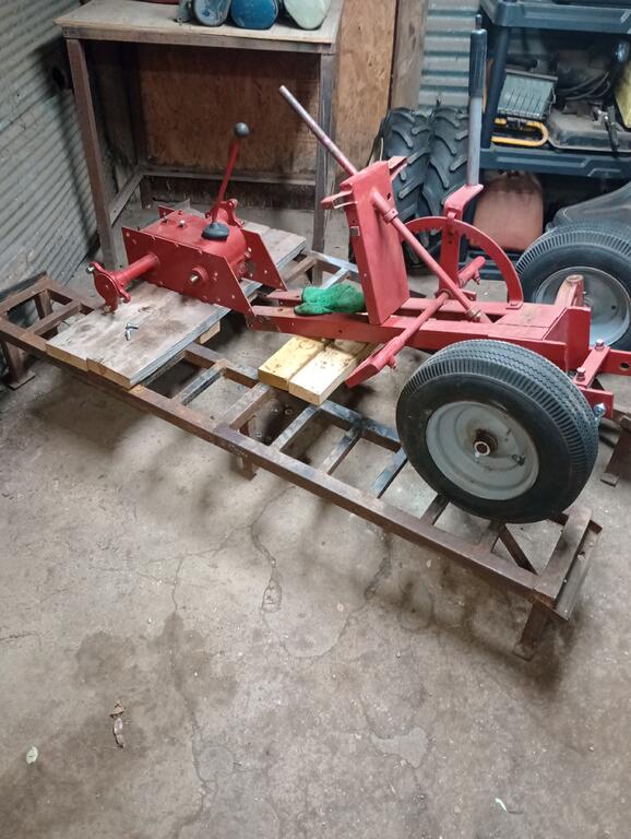

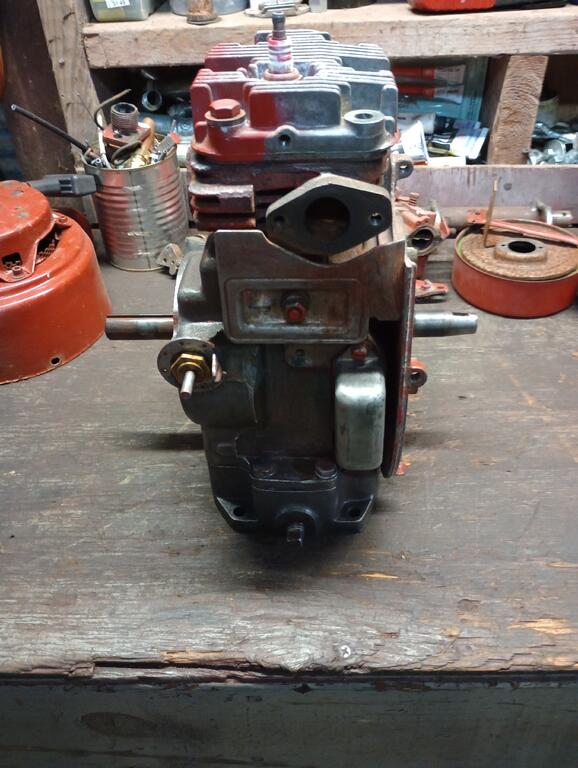

Chrishar 1,026 #8 Posted August 12, 2025 Took motor off and will take it apart to clean it and check it out to make sure everything is good because it had water in it Share this post Link to post Share on other sites

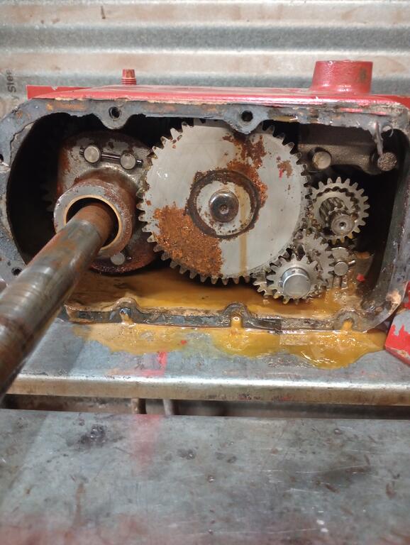

Chrishar 1,026 #9 Posted August 12, 2025 Take transmission apart something is not right with it and does anybody have a hood stand for it Share this post Link to post Share on other sites

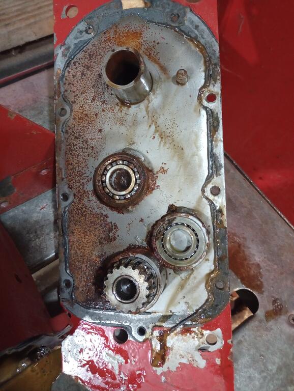

Chrishar 1,026 #10 Posted August 12, 2025 So the transmission has water in it too yay Share this post Link to post Share on other sites
Chrishar 1,026 #11 Posted August 12, 2025 So what I was thinking it has bad bearings it was a rebuild transmission so this is what happens when water gets in there it was hard to turn the brake pulley so now have to order a transmission kit for it hope the motor is not this bad Share this post Link to post Share on other sites

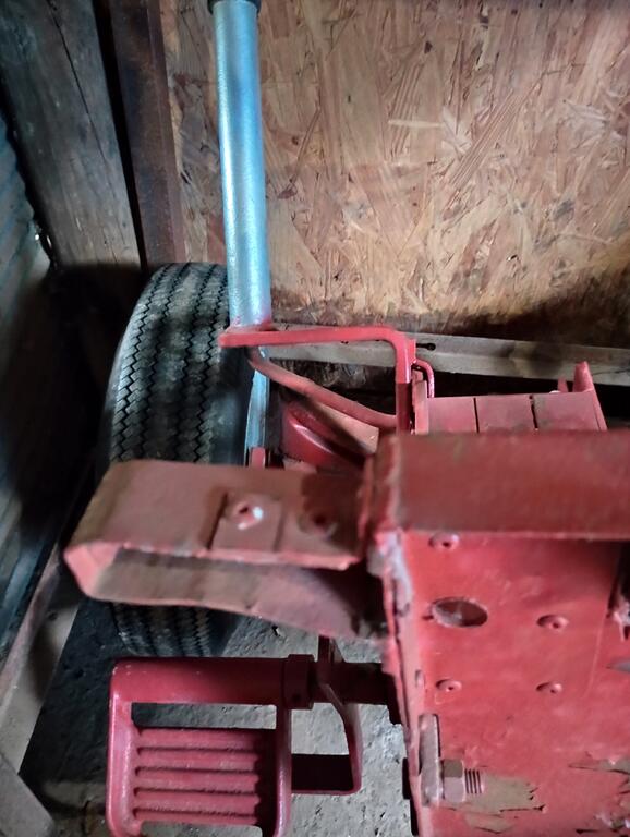

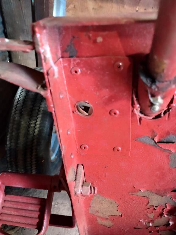

wallfish 20,158 #17 Posted August 16, 2025 On 8/11/2025 at 10:57 PM, Chrishar said: does anybody have a hood stand for it What's wrong with the hood stand? Share this post Link to post Share on other sites
Chrishar 1,026 #18 Posted August 16, 2025 It's broken in four places and some one tried to fix it but not so good I can probably fix it but if I could find one to replace it that would help me on time to get it done for a show coming up soon 1 Share this post Link to post Share on other sites

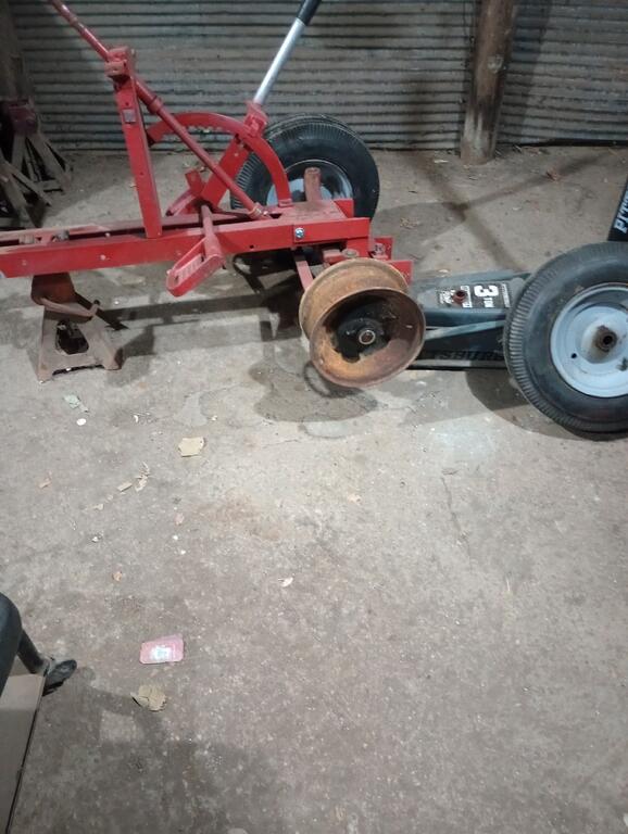

Chrishar 1,026 #20 Posted August 19, 2025 Front rims came in today I just got to clean up paint and put new tires on 2 Share this post Link to post Share on other sites

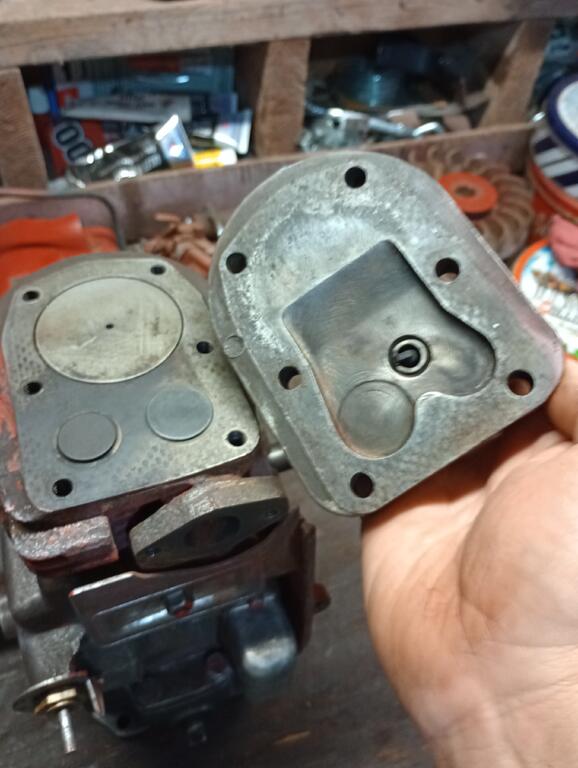

Chrishar 1,026 #21 Posted August 25, 2025 Pulled the head off and it looks good Share this post Link to post Share on other sites

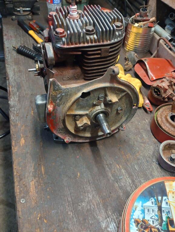

Chrishar 1,026 #22 Posted August 25, 2025 Clean the old paint off and I still have to pull the oil pan and clean the inside of motor and going to reseal the motor too 3 Share this post Link to post Share on other sites

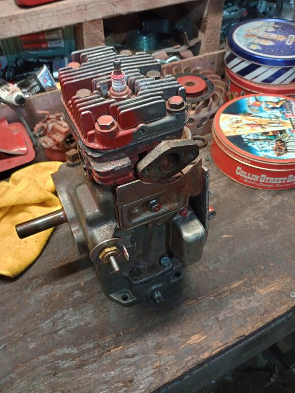

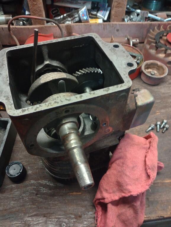

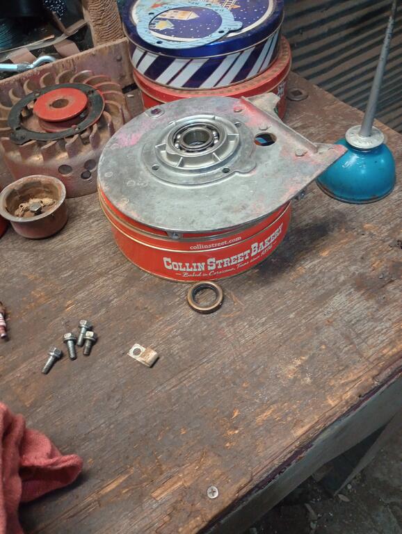

Chrishar 1,026 #24 Posted August 27, 2025 Had sometime last tonight to work on motor so I took it apart cleaned it and put all new gaskets on 2 1 Share this post Link to post Share on other sites

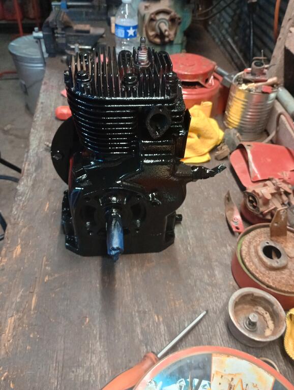

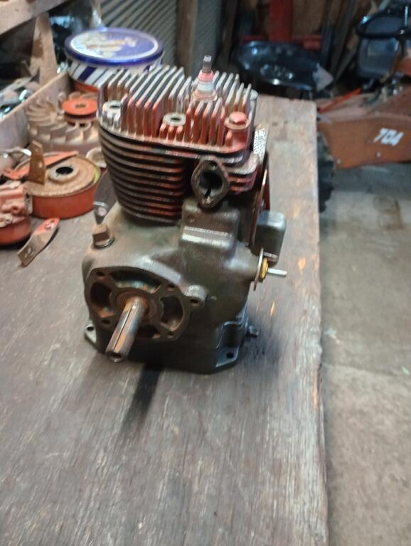

Chrishar 1,026 #25 Posted August 28, 2025 Painted some parts and the motor too 3 1 Share this post Link to post Share on other sites
