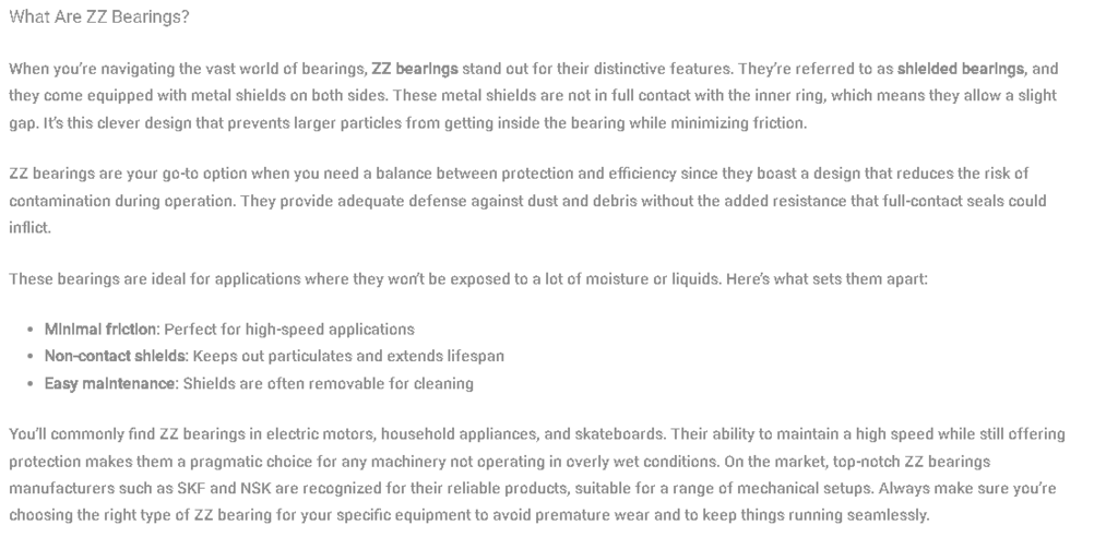

JoeM 10,071 #5 Posted August 6, 2025 (edited) 12 hours ago, wallfish said: I'd choose to leave both of the seals on and leave the grease gun alone. I have some like this running now at least 5 years. I started out with doing just one and it is just as smooth as it was when installed. I figured the mule drive bearings are sealed and some of those are 25 years and counting. I know the ZZ bearings are used in the PTO. I wondered if there was a total seal this is what I found out. Based on the info, no go for the application. Edited August 6, 2025 by JoeM 2 Share this post Link to post Share on other sites

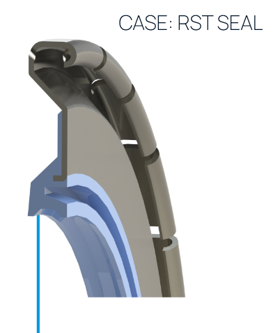

lynnmor 8,875 #6 Posted August 6, 2025 A number of zero turn mowers now use spindle bearings with type RST bearings. They have metal shields with rubber seals inside giving them better performance. 4 Share this post Link to post Share on other sites
