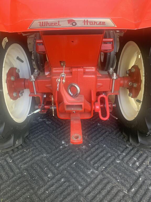

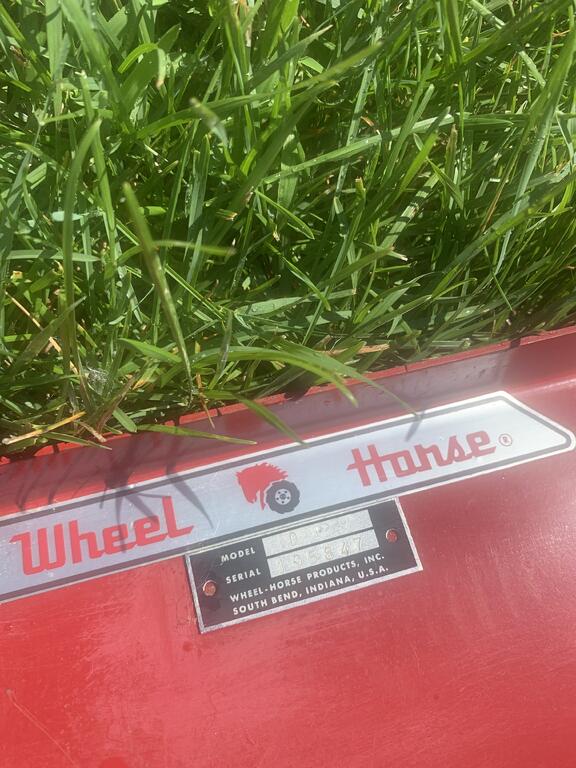

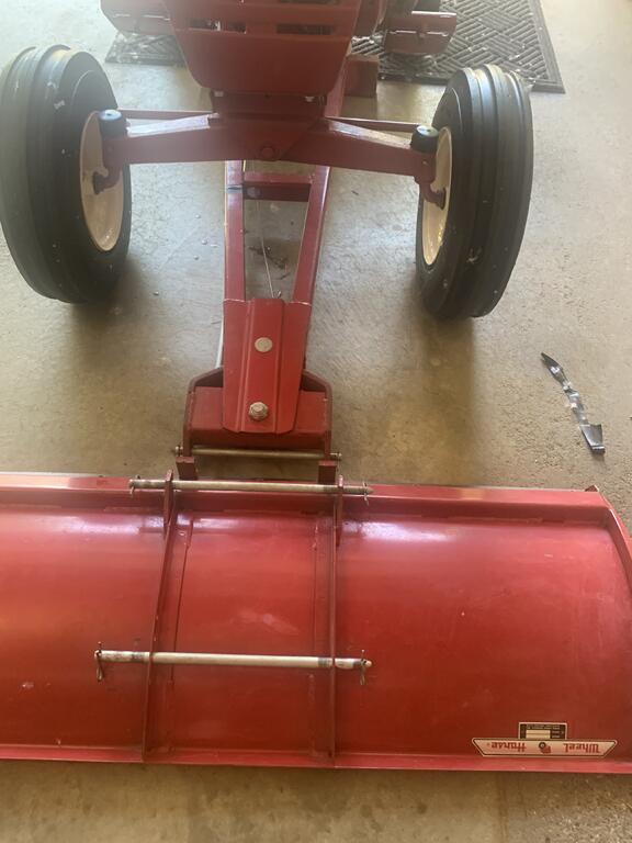

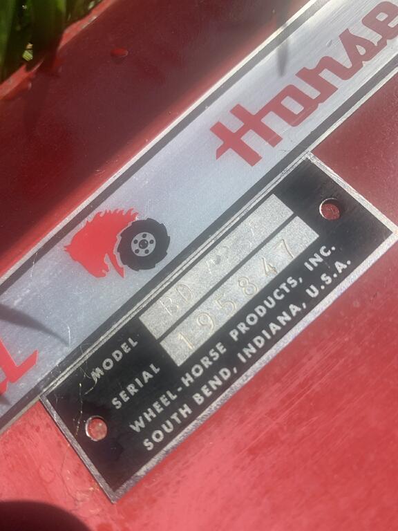

Terry M-(Moderator) 2,326 #1 Posted July 26, 2025 Years ago I picked up this short frame plow and today I decided to put it together. Long story short, it won’t mount up to the existing bracket as the part of the plow frame is too wide for the bracket. I’ve never dabbled with this type of implement before. so…sounding stupid..do I have an odd plow or do I need a different mounting bracket. bracket originally came on this tractor…Guess I could research but thought maybe a quick answer was to be found here.. model stamping on the tag is hard to read…possibly BD 4254 or 4257. 1 Share this post Link to post Share on other sites
squonk 48,126 #2 Posted July 26, 2025 I think if the left bracket Ron the right and the right was on the left it would work. I ran into something similar once but don't remember how I solved it. The plow looks right. 2 1 Share this post Link to post Share on other sites
stevasaurus 23,856 #3 Posted July 26, 2025 It is the right plow for your horse Terry. They do make two different brackets. One for your series plow and one for the "B" & "C" type horses. The plow blade either mounts outside the locking do-hickies or the do-hickies are on the inside. 2 Share this post Link to post Share on other sites
oldlineman 1,809 #4 Posted July 26, 2025 that's what I was thinking squonk 1 Share this post Link to post Share on other sites
Terry M-(Moderator) 2,326 #5 Posted July 26, 2025 6 minutes ago, squonk said: I think if the left bracket Ron the right and the right was on the left it would work. I ran into something similar once but don't remember how I solved it. The plow looks right. Bracket is one piece …sounds like I need a different bracket… Share this post Link to post Share on other sites
moe1965 774 #6 Posted July 26, 2025 I like the idea of the quick removable pin to switch out the hitch. I'm going to do the same to mine 2 Share this post Link to post Share on other sites
stevasaurus 23,856 #7 Posted July 26, 2025 Check with Lowell, Terry. Share this post Link to post Share on other sites
Terry M-(Moderator) 2,326 #8 Posted July 26, 2025 Just now, stevasaurus said: Check with Lowell, Terry. Good idea… Share this post Link to post Share on other sites
squonk 48,126 #9 Posted July 26, 2025 18 minutes ago, Terry M said: Bracket is one piece …sounds like I need a different bracket… I think I cut the piece that connects both sides turned the brackets around and re welded them. As I remember the brackets on our 604 we had back in the 60's were not connected together. 2 Share this post Link to post Share on other sites

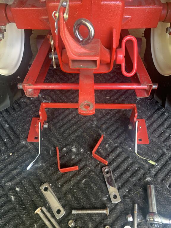

Terry M-(Moderator) 2,326 #10 Posted July 26, 2025 Here’s a pic of the bracket removed …definitely won’t work…this shows the difference a lot better.. I’ll have @wheelhorseman check this out.. Share this post Link to post Share on other sites

squonk 48,126 #13 Posted July 26, 2025 (edited) The bracket you have looks like to me a long frame plow bracket. If you were to cut off the connector piece, turn the brackets around, connect to the plow on the shiny outer part it would work. Edited July 26, 2025 by squonk 2 Share this post Link to post Share on other sites

gwest_ca-(File Mod) 12,488 #16 Posted July 27, 2025 The early brackets bolted to the front of the square axle housing - not the bottom like later models. Best guess 4 Share this post Link to post Share on other sites
