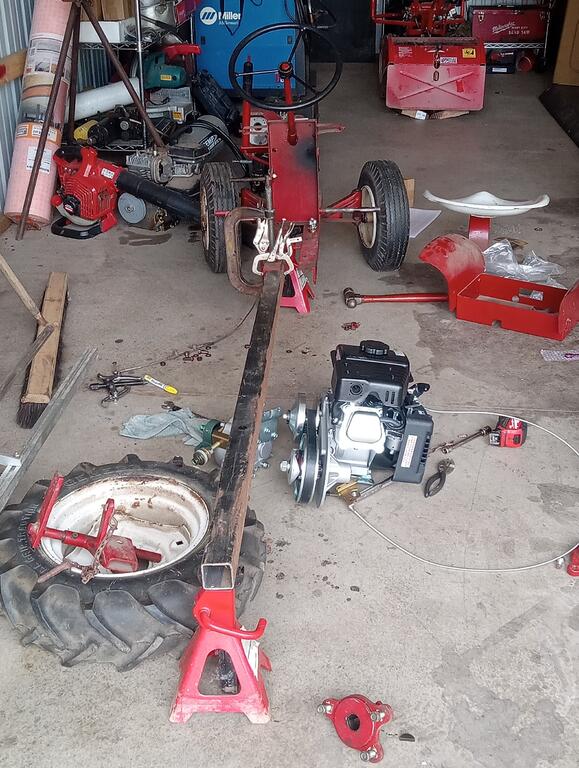

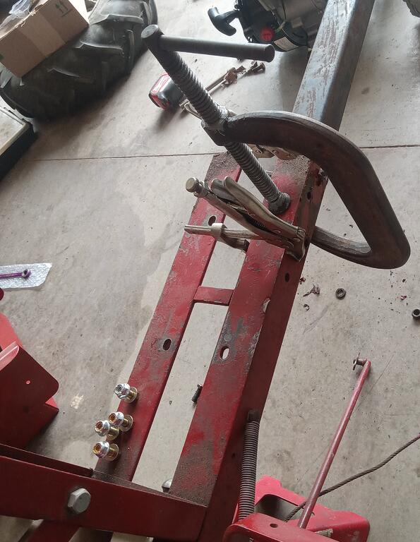

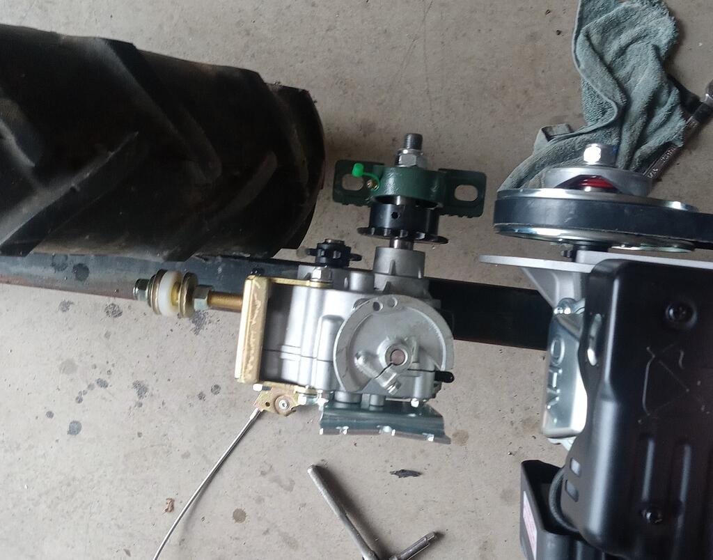

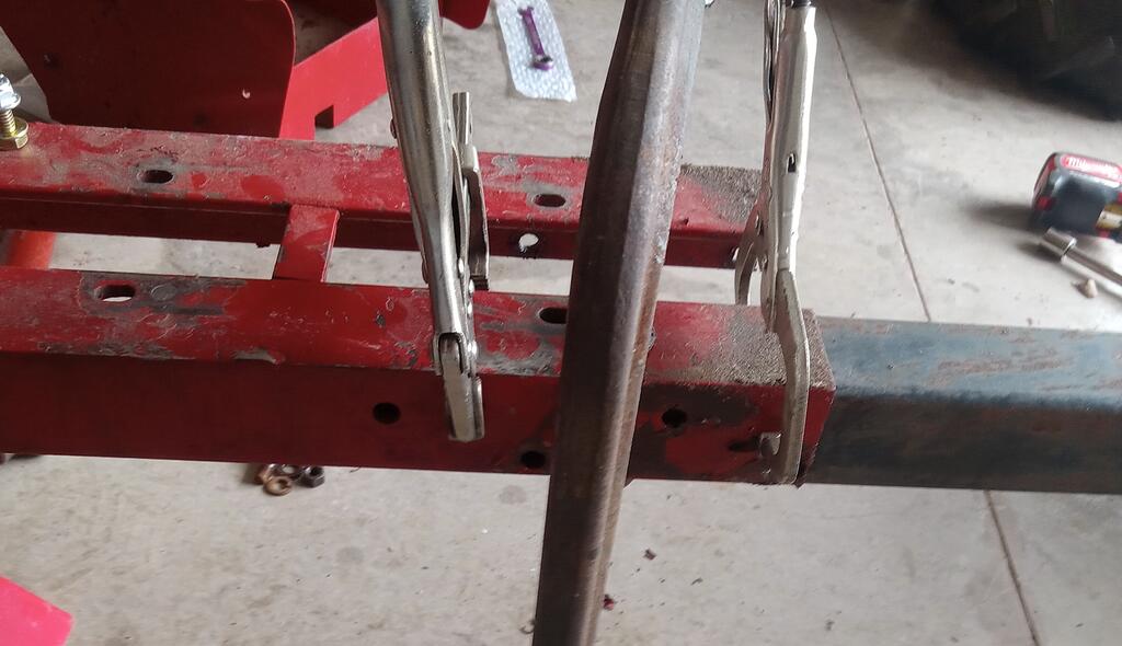

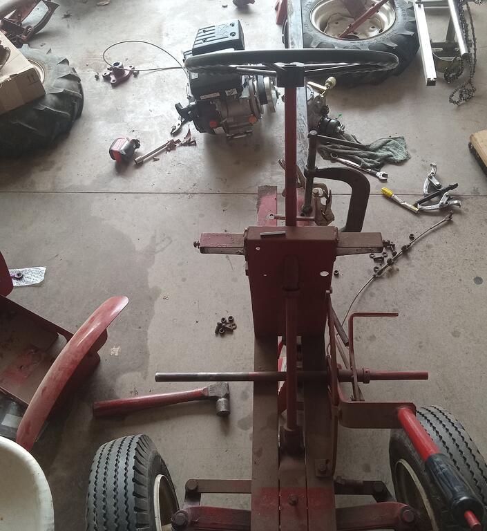

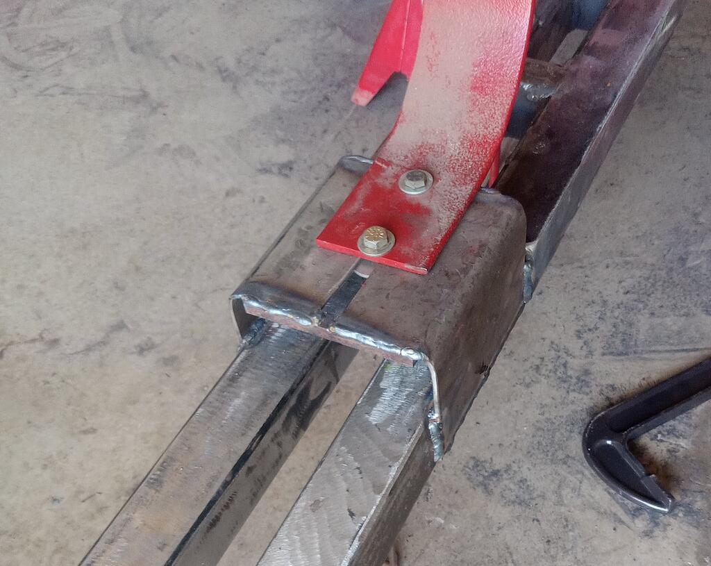

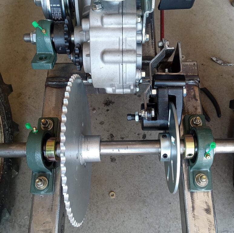

Shed 377 #1 Posted July 24, 2025 So with the destruction of the transmission is my suburban, I have decided to build something a little different and it's a little safer and easier for my kids. So I am building what I call a doodle horse. Ideas are from the doodle bug conversion in the past. I am extending the frame rails and mounting the engine behind the seat. I went with a belt drive tourqe convertor that drives by chain a forward and reverse gear box to a soild chain drive axle. It has one mechanical disc brake which I will use the original brake pedal. The whole tractor will be much longer then original so I wanted to make it look not goofy so I am cutting some rough cut oak boards and building a simple bed frame, steel frame wood sides and flooring. Here's some pictures. Don't mind the mess things have been crazy and I'm trying to finish this before the local show. I'll post more. I'm still waiting on the axle frame rails need to be finished tonight. 6 8 1 Share this post Link to post Share on other sites

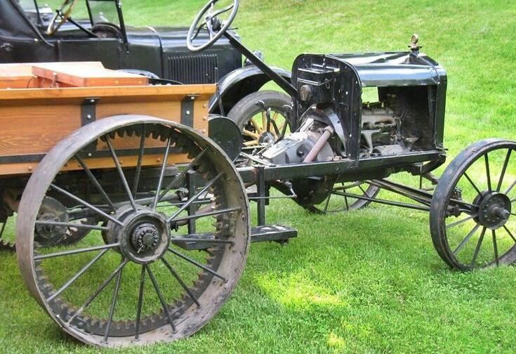

Ed Kennell 47,351 #6 Posted July 24, 2025 Many Doodle Bugs can be seen at the Big Show. Here's mine. 1 3 3 Share this post Link to post Share on other sites
953 nut 69,321 #7 Posted July 24, 2025 1 hour ago, Shed said: mounting the engine behind the seat Looking forward to your build. You will need to add a lot of weight to the front end to prevent wheelies. Share this post Link to post Share on other sites
8ntruck 9,301 #8 Posted July 24, 2025 You mentioned a solid rear axle. If you mean that both rear wheels will be driven by the axle, steering this machine will be an issue. You will need a differential of some sort to be able to steer the machine. The simplest 'differential' is to drive just one wheel, and let the other one freewheel. Share this post Link to post Share on other sites
Shed 377 #9 Posted July 24, 2025 Yeah I'm going to see how it goes many go karts I had growng up were straight they pushed a little. If I have to I can change it around. Yes lots of front weight. I'd like to put a chain driven genorator to charge a battery and I'd put the battery up front. My son loves lights so I'll see. I'm stretching the wheel base a good bit so hoping that would cam the wheelie it down He will just be happy to drive around helping out around the frame. He can take supplies to his chickens then in the body 2 Share this post Link to post Share on other sites
ri702bill 13,067 #10 Posted July 24, 2025 Around here, there were many Doodlebugs made from 1920's cars that became the poor man's tractor.... Mostly at the southern end of the State down in 'Tater Country. 3 2 Share this post Link to post Share on other sites

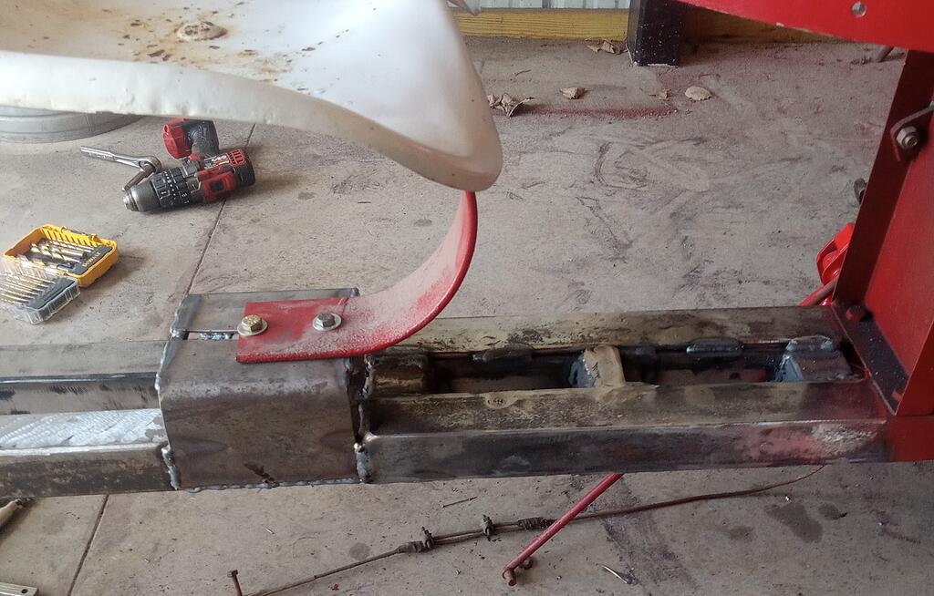

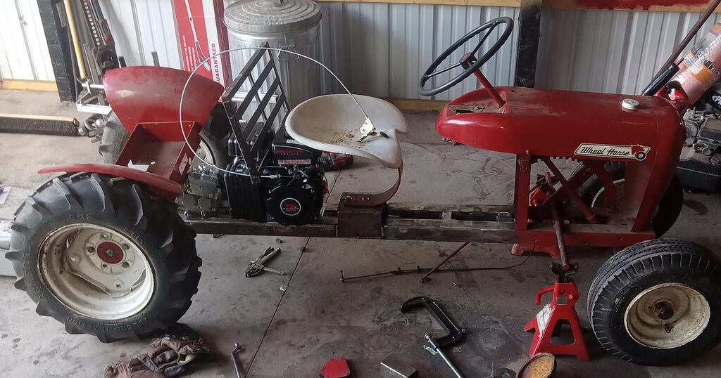

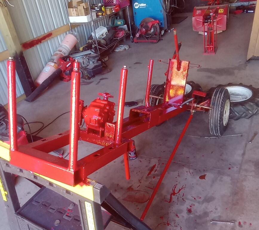

Shed 377 #13 Posted July 28, 2025 So I welded the frame today made a sliding adjustable seat mount. Trying to judge the bed and fender placement I'll remove the fenders from the original bed. I still need to remove the fuel tank it will allow me to move the engine up a lot. See what happens 4 2 1 Share this post Link to post Share on other sites
8ntruck 9,301 #14 Posted July 28, 2025 Probably a minor issue, but with that big a change in the wheelbase. To get proper steering geometry, you will need to adjust the Ackerman on the spindles. Justa guess, maybe reduce it by half. 1 Share this post Link to post Share on other sites
Shed 377 #15 Posted July 29, 2025 Yeah ots going to be shorter then in the photo still mocking things up. Share this post Link to post Share on other sites

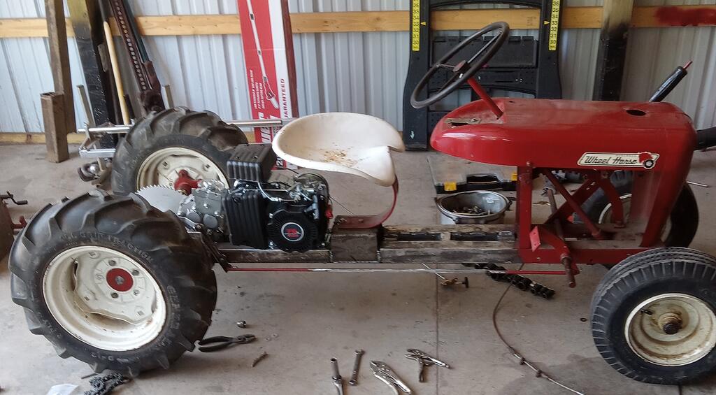

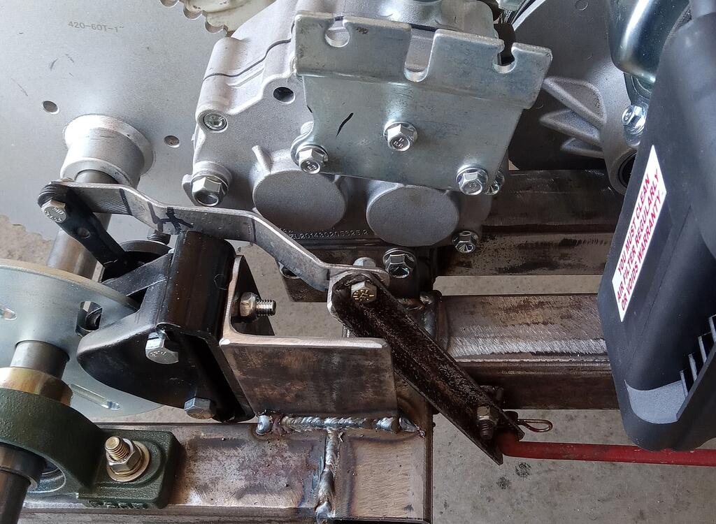

Shed 377 #16 Posted August 3, 2025 So here's the latest swapped the brake to the passenger side foot peg everything's mounted and works. Bed still needs to be made. 7 Share this post Link to post Share on other sites

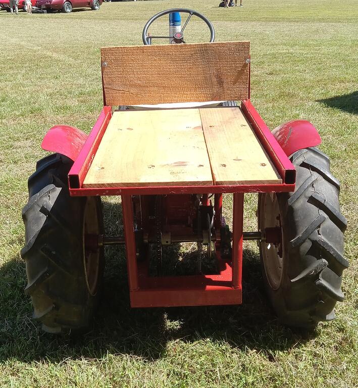

Shed 377 #17 Posted August 10, 2025 Frames painted and tomorrow morning it will be back together. Bed was built wood cut and coated in oil. Long build for a quick project I upgraded the brake linkage so thanks to folks who said fix that. I ended up testing it and bent the rod like nothing was even there. Went with half inch tube with 3/8 hemi joints. 2 6 1 Share this post Link to post Share on other sites

WHX?? 58,138 #20 Posted August 10, 2025 What is the tranny out of or did I miss that? 1 Share this post Link to post Share on other sites

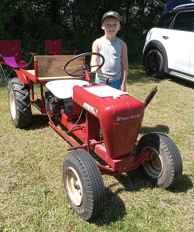

Shed 377 #21 Posted August 10, 2025 45 mins late we made it to our local bloomsburg car show 7 3 Share this post Link to post Share on other sites

Shed 377 #23 Posted August 10, 2025 4 hours ago, WHX?? said: What is the tranny out of or did I miss that? It starts with a belt driven tourqe convertor then to a chain to gear box for a go kart forward neutral reverse then chain drive final sprocket is 60 tooth 3 Share this post Link to post Share on other sites
