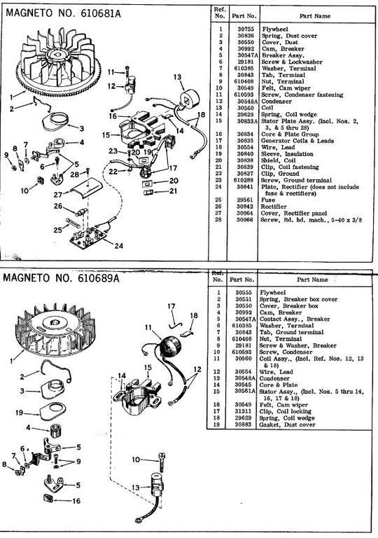

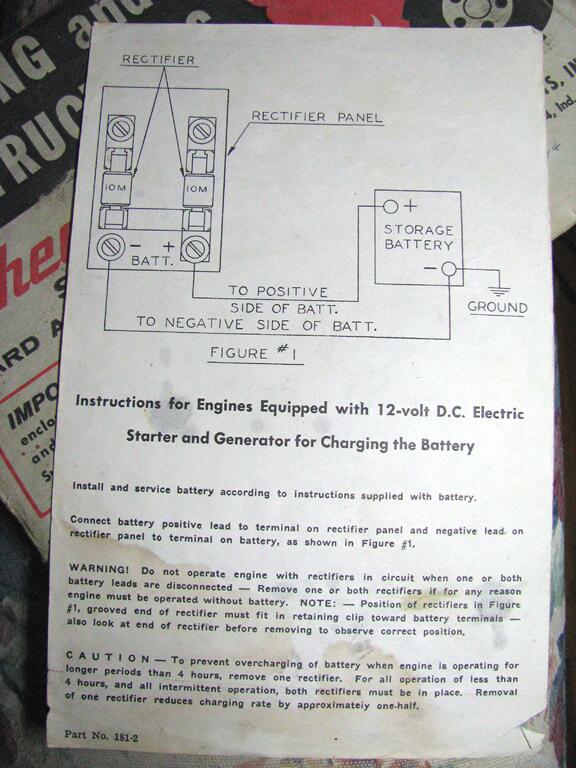

oliver2-44 11,137 #5 Posted July 22, 2025 The Tecumseh diodes can be scarce as hens teeth to find. I recall one member removed the diodes and got his engine running. Then after working others bugs out, inserted the diodes and got that electrical charging system working last. I have and H60 that I need to get running, so I've been collecting files that looked used for when the time comes. Hopefully some of these files may be helpful for you. Keep us posted as you work on it. PS the H60is Identical to thee H55 except it has an internal oil pump. For what its worth.....If your engine's oil wasn't maintained and has a lot of sludge built up, it might be worth removing the engine bottom oil pan and cleaning out the sump and oil pump. I have an old Wisconsin that appeared sludged up and was I glad I pulled the oil pan on it. The oil pump suction had a screen that was totally caked with sludge. Lauson_H45D-HB45D-H55D-HB55D_IPL.pdf Tecumseh H60-75063B H60-75064B IPL-A (1).pdf Tillotson_carburator for HB55 Tecumseh.pdf Tecumseh_3amp_charging_with_diode_and_fuse_panel_SM.pdf 1 1 Share this post Link to post Share on other sites
Handy Don 15,607 #6 Posted July 22, 2025 (edited) 56 minutes ago, oliver2-44 said: I recall one member removed the diodes and got his engine running. As I recall, he performed careful surgery on the diode holder tubes. He opened them up, replaced the blown diodes inside, and then reassembled them. The only reasons for the big holders are to protect the small diode itself within a larger container and to make them easier to mount on the engine Diodes are inexpensive components and widely available. Specs for a diode that is way beyond what’s required would be a 20A10 PIV (peak inverse voltage) = 1000 (vs. maybe 15 from the stator) Continuous amp capacity = 20 (vs. maybe 4 from the stator) Here’s an example from the Jungle site Edited July 22, 2025 by Handy Don 1 Share this post Link to post Share on other sites

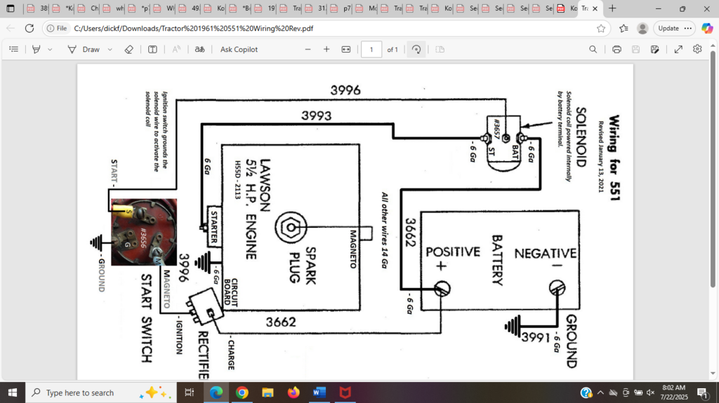

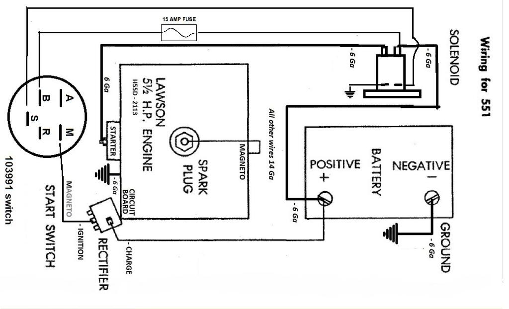

953 nut 63,548 #8 Posted July 22, 2025 10 hours ago, wallfish said: The wiring on those old tractors is fairly simple compared to modern stuff and that basic diagram @953 nut posts all the time for a magneto ignition style should be sufficient to get you going. The 550 used a few components in its wiring that are scarcer than hen's teeth. There is a #3656 ignition switch on for $ 80.00 plus shipping if you insist on going ALL OEM original. Then you would need to find a #3657 solenoid or modify the method of wiring a present-day solenoid. If you have a good original ignition switch and solenoid then the wiring diagram below is great for your needs. The wiring for the 550 and the 551 is identical, the drawing below has been corrected by @gwest_ca to reflect actual wiring, the 551 diagram in the Owner's Manual was incorrect. Or, as John @wallfish suggested you can get the job done for a lot less money by using a 103991 ignition switch and a modern solenoid. The second drawing uses the more modern and much more affordable 103991 switch and a garden tractor solenoid. . Share this post Link to post Share on other sites
