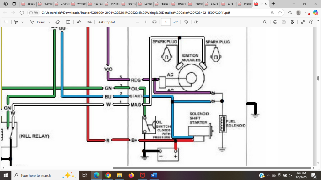

953 nut 68,495 #17 Posted July 21, 2025 Your fuel solenoid has two sources of power, one is from the ignition switch in the start position and the other is from the engine's charging system going through a diode. This is a safety device to shut off fuel flow if the engine isn't running. If the charging system is not functioning or the diode is bad the solenoid will close as soon as you go from start to run on the key switch. The fact that everything worked well with a jumper wire proves that the problem is probably the diode or the wiring to or from it. I do not own this model so can't be of any help in locating the diode, just follow the purple wire and you can locate it. Share this post Link to post Share on other sites

Pattyb 17 #19 Posted July 22, 2025 Good morning! I have a new ignition switch in the mail. I tried to buy one over the weekend at the hardware store but it’s not a stock part for them. I am hopeful it will resolve the problem and I don’t have to deal with replacing a diode. Thanks for the schematic! It will be very helpful if the switch isn’t the issue. I did examine a lot of the wiring for chew marks and didn’t find anything but a mouse nest in the boot of the steering column. I did find a wiring connection up by the fuses that is not connected to anything. It has some electrical tape on it. Is that for accessories? I did not see anything in the owner nor service manual. I will post back after we replace the switch so that the next person has information on what to try next with troubleshooting. I wanted to thank all of you for your help. We have never worked on a carburetor with a solenoid so this was new for us and my research led me here and I am glad it did. You are a wonderful group of people and I’m glad I found you! Pat 2 Share this post Link to post Share on other sites

Pattyb 17 #21 Posted August 3, 2025 It is not the switch! I ordered a good quality replacement, hubby cleaned the connection points and still the same issue. I guess it’s time to trace the wires. Thanks 953 for posting the schematic. 1 Share this post Link to post Share on other sites
953 nut 68,495 #22 Posted August 3, 2025 (edited) I guess it’s time to trace the wires. Just a bit of information on why the diodes are included in your wiring. A diode is a one-way device that will allow flow in one direction only. They are small and may seem like a little lump in the wiring. With your ignition switch in the START position 12 DC volts from the ignition switch will go through the start relay to the starter solenoid and the diode on the light blue wire to the fuel solenoid to open it. With the engine running AC voltage from your charging system will go through the diode on the purple wire, be rectified to 12 volt DC and go to the fuel solenoid to open it. The diode on the light blue wire will stop the 12 volts from the charging system wire from back-feeding power to the starter solenoid. The purple is the diode or wire I suspect has failed. I hope this helps you understand why there are two diodes and where you should look for them. Edited August 4, 2025 by 953 nut 2 Share this post Link to post Share on other sites
Pattyb 17 #23 Posted May 9 953 nut, thank you!!! It was the purple wire that was bad. We made a bypass wire with a new diode and it works perfectly. For anyone with the same issue, Kohler makes a kit, part number, 25 755 31-S. Thanks again to all of you for helping me troubleshoot and resolve the issue. 2 4 1 Share this post Link to post Share on other sites
