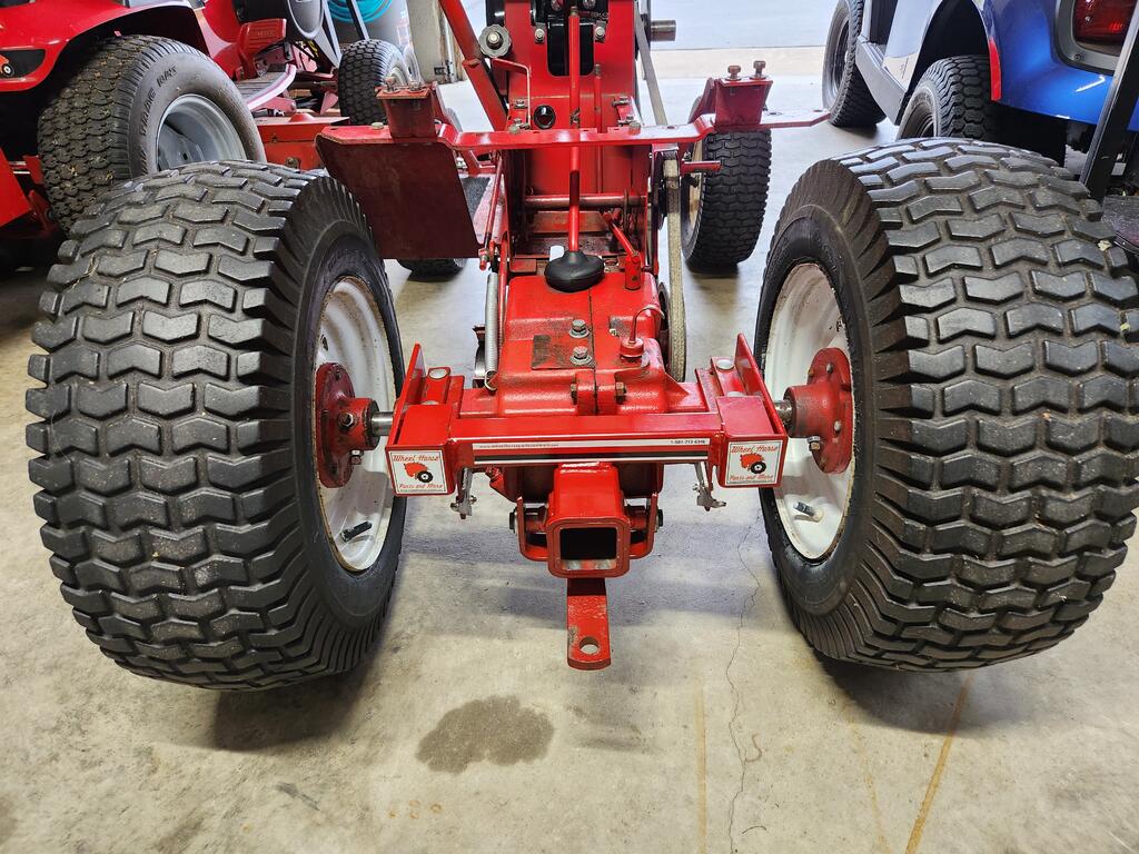

Racinbob 13,143 #3 Posted July 14, 2025 (edited) I'd have to check but I don't think any of mine are tight to the transmission case. I go with the end of the axle flush with the outer end of the hub. Never had a problem. With that being said your issue shouldn't happen. Apparently something has been changer. Wheel Horse wheels have just about the smallest offset out there. Edited July 14, 2025 by Racinbob 1 Share this post Link to post Share on other sites
ri702bill 12,994 #4 Posted July 14, 2025 The picture of Bob's tractor is correct. The outer hub edge should be flush with the end of the axle shaft. Your hub most likely has only one grub screw, located over the keyway. Addind a second one 90 degress apart helps greatly in keeping the hub from walking. As @ebinmaine has advised before, use NEW grub screws and properly torque them - a 7/16 12 point socket fits the square drive heads...... I had the same issue on my C81...issue no more. Share this post Link to post Share on other sites

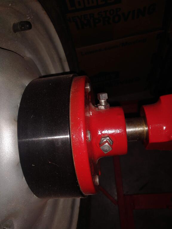

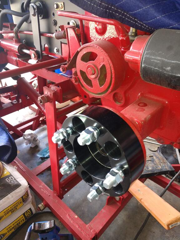

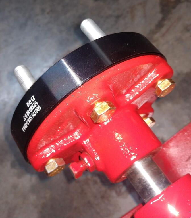

kpinnc 18,940 #9 Posted July 14, 2025 (edited) One option would be to use any width of 5x4.5 spacers. You'll have to ream the bolt holes to 1/2 and get some 1/2x20 bolts to use with them, but removing and reinstalling wheels with studs is so much easier that you'll never look back. I have them on 5 of my tractors and they are awesome! Just don't go too wide and make your mower decks not fit... Edited July 14, 2025 by kpinnc Share this post Link to post Share on other sites
Lee1977 7,768 #10 Posted July 14, 2025 If you used wheel spacers you need 5 on a 4 1/2" bolt circle with 82 mm hole to clear the 3 1/4" ( 79,50 mm ) raised center on the hub. I think mine fit some model Jeep. When I got mine they were around $40 a set. I put mine on the the standard Wheel Horse wheel bolts. Share this post Link to post Share on other sites
