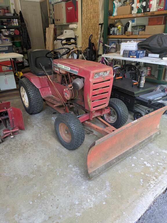

FarmallFarmer09 31 #1 Posted July 13, 2025 Just purchased my first wheel horse. Dont know anything about them, Ive got more large tractors, so i thought itd be nice to get into garden tractors. I purchased a wheel horse Charger 12 Automatic, that came with a snow plow, And a snow blower. all 3 work fantastic. Except for one thing. It has an "Electric clutch" Switch on it, and no matter if its in the on or off position, The other two pulleys are spinning. What can i do about this? And then also, when i go to use the snow blower in the winter, What pulley on the electric clutch do i put it on? It has 2 i believe. I was told this was a rare bunch, as the snow blower was rare, and aparently, because this has a cigarette lighter on it, its rare too? I highly doubt so, i think the guy i bought it from put it on there. And while im here, If you have just some basic info or anything i need to look out for on these charger 12s, Please let me know. As i said, this is my first wheel horse. Thank you. Share this post Link to post Share on other sites
rjg854 13,454 #2 Posted July 13, 2025 A lot of the early 's had lighters on them, so it's not that rare, what makes them rare is that they are still there. You can go to the document forum and download a manual for your model tractor. You might have to do a bit of searching to find the correct model, but it's most likely there. Your tractor looks to be in pretty decent shape. The model number should be on the dash tower, that will aid your search. 1 Share this post Link to post Share on other sites

pfrederi 21,342 #8 Posted July 13, 2025 (edited) The pulleys on electric PTOs will spin even turned off (there is no brake). However if there is a belt on them they will stop spinning in the off position. When you turn switch on you should hear a strong click and see a slight movement in the Clutch. Interesting yo have the electric PTO they normally came on Electros which also had hydro lift.. It is important to determine what type ignition system you tractor has. Kohler used 3 different ignition systems on Chargers...Battery points....Magneto Points ...and Breakerless. Do not make any wiring or ignition switch changes until you determine what style you have. Incorrect wiring will fry components. A picture of the engine from the left side would help us figure out what you have. Edited July 13, 2025 by pfrederi 2 1 Share this post Link to post Share on other sites

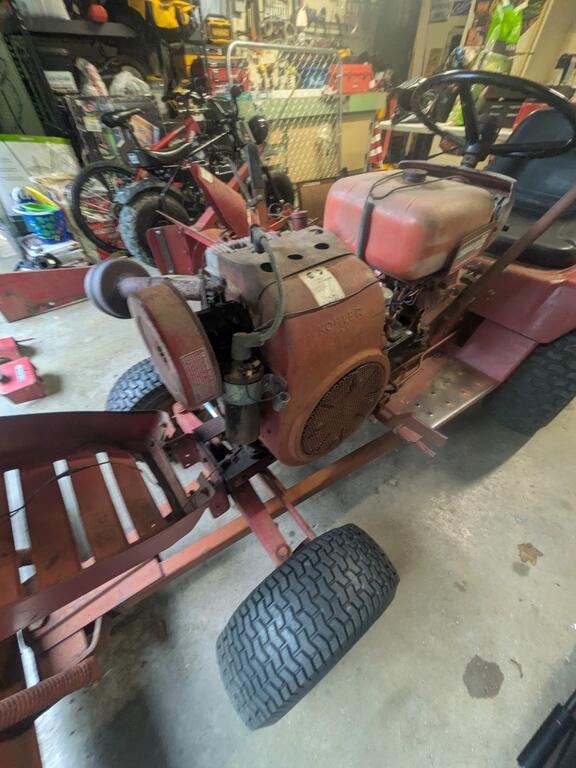

FarmallFarmer09 31 #9 Posted July 13, 2025 Heres the engine from the left. 12 Hp Kohler K301s 1 Share this post Link to post Share on other sites
pfrederi 21,342 #10 Posted July 13, 2025 Battery Points Ignition system. Do not have to worry about frying anything like yo could on a Magneto or breakerless. 1 Share this post Link to post Share on other sites
FarmallFarmer09 31 #11 Posted July 13, 2025 1 hour ago, gwest_ca said: Welcome to Red Square. Does the pulley spin without the engine running or always spin with the engine running? There is a bearing in the clutch that allows the shaft to spin in the pulley. When the clutch is turned on the shaft and pulley are joined by friction and turn together. Any model numbers and serial numbers on the attachments? The snowthrower appears to be a 1973 or later model when the front idler assembly shown was first used. pulley spins while the engine is running, never while its off. And that is with no attachments. I dont know where to find the id tag on the snow blower. Share this post Link to post Share on other sites
FarmallFarmer09 31 #12 Posted July 13, 2025 Just now, pfrederi said: Battery Points Ignition system. Do not have to worry about frying anything like yo could on a Magneto or breakerless. So does that mean that the pulley is gonna spin while no attachments? Share this post Link to post Share on other sites
pfrederi 21,342 #13 Posted July 13, 2025 1 minute ago, FarmallFarmer09 said: So does that mean that the pulley is gonna spin while no attachments? It will spin but if you put any drag on it it will stop. Share this post Link to post Share on other sites

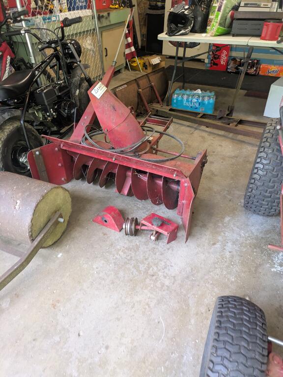

FarmallFarmer09 31 #18 Posted July 13, 2025 not on there. Ill send a photo of the snow blower. I also got this lawn roller. I think its custom made, its like a concrete barrel that some guy attached to the frame. 1 Share this post Link to post Share on other sites
FarmallFarmer09 31 #19 Posted July 13, 2025 Also in the photo of the snow blower i got, I also got another extra snow plow. i dont think it fits. I am going to sell it at my groups next tractor show. What can i get for it if i clean it up? Should i paint it? Will that bring more money? 1 Share this post Link to post Share on other sites
Ed Kennell 47,946 #20 Posted July 13, 2025 1 hour ago, FarmallFarmer09 said: What can i get for it if i clean it up? In my area snow plows sell for $50 to $150 depending on condition. Post a picture of the plow and all the levers, axle bracket, scraper bar. 1 Share this post Link to post Share on other sites
ebinmaine 81,282 #21 Posted July 13, 2025 1 hour ago, FarmallFarmer09 said: Also in the photo of the snow blower i got, I also got another extra snow plow. i dont think it fits. I am going to sell it at my groups next tractor show. What can i get for it if i clean it up? Should i paint it? Will that bring more money? That appears to be a "Short Frame" plow. That'll fit several models in the early to mid 60s. 1 Share this post Link to post Share on other sites
FarmallFarmer09 31 #22 Posted July 13, 2025 1 minute ago, ebinmaine said: That appears to be a "Short Frame" plow. That'll fit several models in the early to mid 60s. I noticed that. its too short to fit on mine. Does that make the value go up? Share this post Link to post Share on other sites
ebinmaine 81,282 #23 Posted July 13, 2025 11 minutes ago, FarmallFarmer09 said: I noticed that. its too short to fit on mine. Does that make the value go up? Depends on region/ show/ who's trying to buy. Up here in the northeast that's $100 to $200 depending on several variables. Share this post Link to post Share on other sites
gwest_ca-(File Mod) 12,557 #24 Posted July 13, 2025 Your snowthrower has the 4 grooved rollers that the chute turns in. That makes it 1980 or older. The side extensions you have were first used in 1975. Click on the fuzzy picture in this link. Have tried to capture VIN plates so we know where they are located but still difficult sometimes. Share this post Link to post Share on other sites
FarmallFarmer09 31 #25 Posted July 13, 2025 37 minutes ago, gwest_ca said: Your snowthrower has the 4 grooved rollers that the chute turns in. That makes it 1980 or older. The side extensions you have were first used in 1975. Click on the fuzzy picture in this link. Have tried to capture VIN plates so we know where they are located but still difficult sometimes. So does it need that bar under it? I dont think i have it with the blower. Ill go out to check really quick. Share this post Link to post Share on other sites
