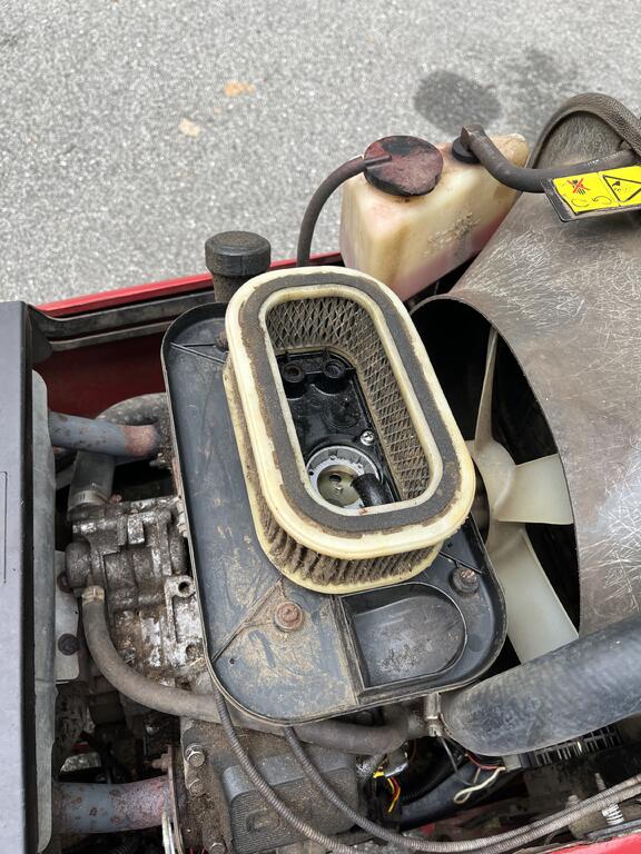

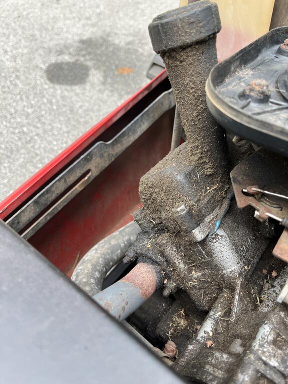

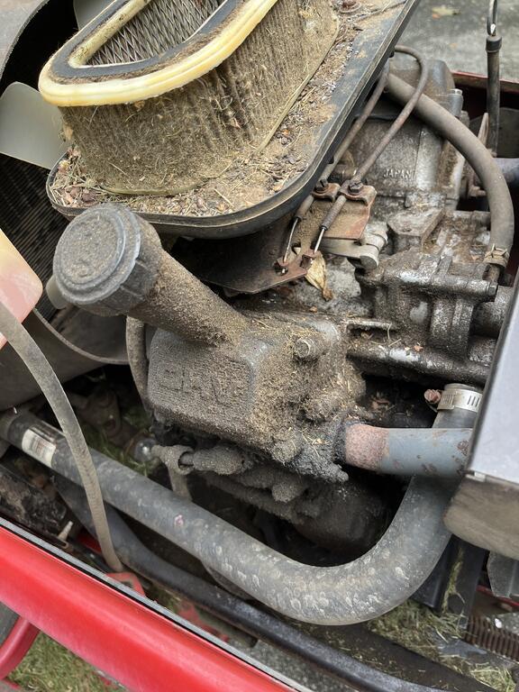

DeltaNu1142 28 #9 Posted July 10, 2025 (edited) I had 30 minutes between things today to clean the air filter until the new ones arrive, and I found a few concerning things. Nothing too serious yet, but I haven't looked that hard: After filling up the right (from the seat) front tire twice in as many days, I'm sure I need a new one. The fronts are Trac Gard N766 16x7.5-8. They're on AZN, but I'd rather buy local/small business if possible. Is this a head gasket leak? I'm getting wisps of smoke when opening the cowl, and I'm pretty sure gooey blue stuff isn't factory Kawasaki sealant: The other side of the engine doesn't have the gunk this one does. That first image also shows the air filter after removing removing the mouse & its house, but before blowing out with compressed air. This is after: Better, but hardly optimal. Back to the head gasket... the oil is present on the dip stick, but low. I'll change it before running it again for any length of time. I need a tire on it, anyway. Edited July 10, 2025 by DeltaNu1142 1 Share this post Link to post Share on other sites
ebinmaine 80,739 #10 Posted July 10, 2025 26 minutes ago, DeltaNu1142 said: head gasket I'm not at all familiar with those engines but that looks maybe like a valve cover gasket leak (??) 1 Share this post Link to post Share on other sites
DeltaNu1142 28 #11 Posted July 10, 2025 (edited) 21 hours ago, ebinmaine said: I'm not at all familiar with those engines but that looks maybe like a valve cover gasket leak (??) Oh... that's what I meant. I found P/N 95-9700 95-9708 for the valve cover gasket. Available from Toro in like 10-15 days. Discontinued from Toros... I'll check with the site vendors. Still looking for a tire locally. I can keep the oil topped up, but the tire isn't lasting overnight and that'll get painful quick. Edited July 11, 2025 by DeltaNu1142 Share this post Link to post Share on other sites
ebinmaine 80,739 #12 Posted July 10, 2025 1 minute ago, DeltaNu1142 said: Oh... that's what I meant. I found P/N 95-9700 for the valve cover gasket. Available from Toro in like 10-15 days. I'll check with the site vendors. Still looking for a tire locally. I can keep the oil topped up, but the tire isn't lasting overnight and that'll get painful quick. It's a bit of a drive for you but Rick n Ray's in Buxton may have a tire? You get in a jam I've definitely got something here but not that 7.5" wide. I have a pair of oddball 18" OD I'd let ya have that are "off size" Might work...... For OE Toro part numbers send an email to billsplaceshop.com Excellent service. 1 Share this post Link to post Share on other sites

Handy Don 17,474 #14 Posted July 10, 2025 1 hour ago, DeltaNu1142 said: I dunno. This looks more to me like spill at filling or the breather not trapping the oil vapor. Share this post Link to post Share on other sites

DeltaNu1142 28 #17 Posted July 11, 2025 14 hours ago, Handy Don said: I dunno. This looks more to me like spill at filling or the breather not trapping the oil vapor. I think I see what you mean... the gunk is pretty uniform all the way down the outside of the tube. I guess the blue goo caught my eye. I can clean it up, change the oil and run it, and see where it's coming from. 2 Share this post Link to post Share on other sites

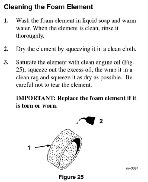

lynnmor 9,040 #22 Posted July 14, 2025 On 7/10/2025 at 12:28 PM, DeltaNu1142 said: I'll get one on the way. Do they need oil? Yes, you oil the foam filter. From the manual: 1 Share this post Link to post Share on other sites
DeltaNu1142 28 #23 Posted July 14, 2025 32 minutes ago, ebinmaine said: Have you had a wheel off one of these yet? Nope, first timer here. 7/14/2025 589.0 hours I didn't set out to do it, but I ended up changing the oil... 1.9 qts Valvoline 5W-30 full synthetic & a WIX 51394XP filter. The oil was low... it came out looking OK, if a little thin. No shiny stuff. I rode around a bit and that seems to have been the cause of my temperature problems. I still need to mount the new tire. I will flush the coolant soon. I put the other mower deck on today, and it's got a frequent (but not regular) tick-tick-tick coming from the left side somewhere. I wasn't able to see it, so I might remove the deck and check it out. The Attach-A-Matic system is great. It was way easier than replacing the deck on my Craftsman was, and that was almost 20 years newer. I cleaned up the engine a bit to see if I can ID the oil leak. I got no wisps of smoke when I shut it down. Share this post Link to post Share on other sites
DeltaNu1142 28 #24 Posted July 14, 2025 3 minutes ago, lynnmor said: Yes, you oil the foam filter. I have the manual... missed that, apparently. The WH didn't come with a foam filter installed. But I've got one on the way, and I'll oil it when it goes on. Thanks. Share this post Link to post Share on other sites
lynnmor 9,040 #25 Posted July 14, 2025 1 minute ago, DeltaNu1142 said: I have the manual... missed that, apparently. The WH didn't come with a foam filter installed. But I've got one on the way, and I'll oil it when it goes on. Thanks. I saw the excellent maintenance by the previous owner, he probably just tossed it. 1 Share this post Link to post Share on other sites
