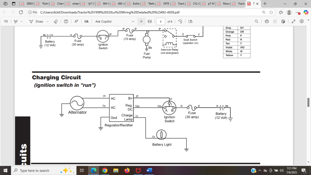

953 nut 64,636 #3 Posted July 6, 2025 Before you go parts shopping you should have the tractor in your possession and do some basic trouble shooting. Frequently charging problems are a matter of a bad fuse holder or other electrical connection rather than a parts failure. We can help you trouble shoot the problem once you have it home. Here is a listing of links to service manuals and associated information that will be helpful; https://www.wheelhorseforum.com/search/?&q=520Lxi&type=downloads_file&page=2&search_and_or=or&sortby=relevancy I'm not sure were you have done your searching but these engines were used by numerous equipment manufacturers besides TORO. This manual may give you more information that will allow you to narrow your search. 4 Share this post Link to post Share on other sites

DeltaNu1142 28 #8 Posted July 6, 2025 7 hours ago, ebinmaine said: My first recommendation is to check with our own vendors. My actual first thought when you mentioned this site has vendors: The tractor I picked up is model # 73545, serial # 890xxxx... so it likely has the plastic gear parts. But I went ahead and got it, loaded it in the trailer and brought it home. I was able to get about 3/4 of my lawn cut before the PTO engagement stopped responding consistently... a clear sign of low volts (from what I can tell). I pulled the tractor into the shed and put it on a charger. The seller said he replaced the voltage regulator, but nothing changed. In fact, he had the old regulator as well as a new one in a box. I'll read voltages on the input & output to see what I can find out. My suspicion is that the stator output is bad / low. The tractor came with a deck, blower, and bagger, as well as a plow and wheel weights. I already had a 48" deck and will be looking to shed some of the parts. I'll post them in the Classifieds when I can get some photos. Thanks for the help so far! 2 Share this post Link to post Share on other sites
ebinmaine 77,792 #9 Posted July 6, 2025 6 minutes ago, DeltaNu1142 said: My actual first thought when you mentioned this site has vendors: The tractor I picked up is model # 73545, serial # 890xxxx... so it likely has the plastic gear parts. But I went ahead and got it, loaded it in the trailer and brought it home. I was able to get about 3/4 of my lawn cut before the PTO engagement stopped responding consistently... a clear sign of low volts (from what I can tell). I pulled the tractor into the shed and put it on a charger. The seller said he replaced the voltage regulator, but nothing changed. In fact, he had the old regulator as well as a new one in a box. I'll read voltages on the input & output to see what I can find out. My suspicion is that the stator output is bad / low. The tractor came with a deck, blower, and bagger, as well as a plow and wheel weights. I already had a 48" deck and will be looking to shed some of the parts. I'll post them in the Classifieds when I can get some photos. Thanks for the help so far! Quite the package! On that voltage regulator and for that matter - the whole system - Remember these are DC systems. Direct Current. No ground equals no direct current. 2 Share this post Link to post Share on other sites
953 nut 64,636 #10 Posted July 6, 2025 4 hours ago, DeltaNu1142 said: replaced the voltage regulator, but nothing changed. The B+ terminal needs to have a connection to a 12 volt source to work. Check the 30 amp fuse and fuse holder. 1 Share this post Link to post Share on other sites
