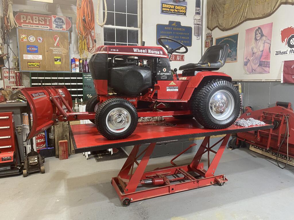

Gasaholic 383 #6 Posted July 11, 2025 Finally got the correctly sized flywheel (had to re-glue one of the magnets) and got my 3rd horse up and running with working rototiller, finally. Just gave it a tryout in the garden and she works wonderfully! (photo taken after I parked it) 2 Share this post Link to post Share on other sites

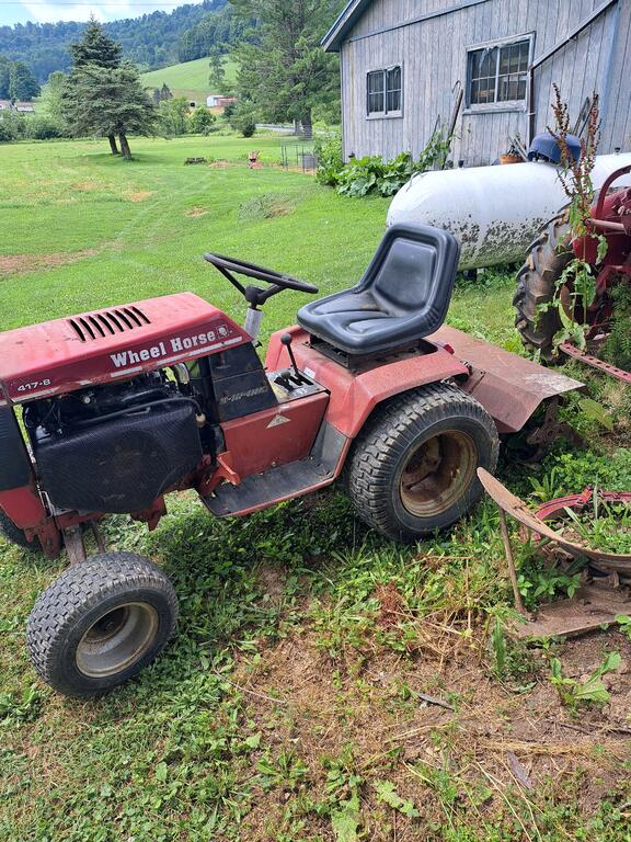

Gasaholic 383 #8 Posted July 12, 2025 electric lift makes it effortless, so I love it. I have tilled so far only in 1st low, but as I mentioned, it works beautifully. Didn't even need to add weights or chains (I thought I might need to, but it doesn't push, so far...) I just got that 417-8 locally for relatively cheap complete with tiller and snowplow (now I have 2 plows, so one's up for sale when I get around to posting it) but it was heavily abused, or at least a lot of "cobbling" was done - For example, hacked wiring harness, lift switch was bad, someone put an ammeter in where the voltmeter was and tried to hook it up the same way, and when it popped fuses, they just left it disconnected, no charging, lots of missing hardware and bits &pieces, a really beat up PTO (they had the PTO brake adjusted so tight it was worn away and digging a groove into the PTO pulley) safety switches bypassed, circuit board inoperative (I may get around to fixing that) oil pressure switch wiring mangled, but at this point it runs and works, so the "restoration" work I'll probably do a bit at a time as I come across the miscellaneous pieces I need for it.. MY main goal was to get it so I can use it to till our garden plot , making my 1948 Farmall cub (with plow, sickle bar and disk harrow) a moot point (So I'll probably sell that cub too. It all works and just plowed & disked the garden this spring. Amazing how powerful that little 9 HP Cub is...) 1 Share this post Link to post Share on other sites
