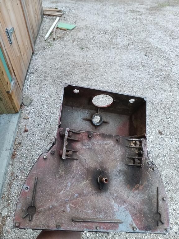

Chrishar 1,054 #1 Posted July 4, 2025 Bought a 704 from a lawnmower graveyard hoping to bring it back to life again have all the parts for it except the gear shifter and the fender pan I put a wanted add here this is going to be a little bit of a project but love this kind of projects 6 5 Share this post Link to post Share on other sites
ri702bill 12,994 #2 Posted July 4, 2025 That looks like it was parked overnight in a bad neighborhood...... 1 10 Share this post Link to post Share on other sites
rmaynard 17,579 #3 Posted July 4, 2025 Wow. That is one ambitious project. I wish you luck. 2 Share this post Link to post Share on other sites
953 nut 69,175 #4 Posted July 4, 2025 I knew that Wheel Horses weren't plentiful in Texas but this one sure is proof positive. Good luck with your project and remember, . 2 Share this post Link to post Share on other sites

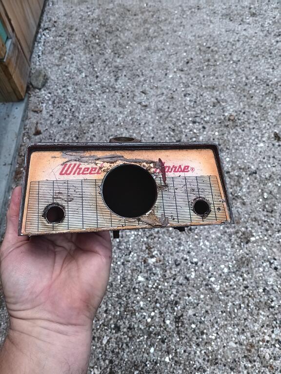

Pullstart 71,220 #5 Posted July 4, 2025 Do you have a hood for it too? Share this post Link to post Share on other sites
SylvanLakeWH 32,469 #6 Posted July 4, 2025 7 hours ago, ri702bill said: That looks like it was parked overnight in a bad neighborhood...... Add on Craigslist: "Ran when parked..." Should be a fun project!!! 5 Share this post Link to post Share on other sites
ri702bill 12,994 #7 Posted July 4, 2025 1 hour ago, SylvanLakeWH said: Add on Craigslist: "Ran when parked..." And my favorite... "will run fine with some TLC"... methinks that means "Total Loss of Cash".... 2 Share this post Link to post Share on other sites
Chrishar 1,054 #8 Posted July 4, 2025 2 hours ago, Pullstart said: Do you have a hood for it too? Yes I have one found it at the wh show 3 Share this post Link to post Share on other sites

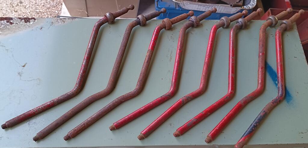

ebinmaine 80,657 #11 Posted July 4, 2025 @Chrishar I have a gas tank here that'll need special attention. @Handy Don might be able to elaborate. It's yours for freight if interested. I'll also look for a shifter. 1 Share this post Link to post Share on other sites
rmaynard 17,579 #12 Posted July 4, 2025 My 704 had a leaky gas tank. After removing all remnants of gas, a simple soldering job fixed it. I sold it 2 years ago. Fellow that bought it, restored it beautifully. He said that next year he will probably bring it to the Big Show. I hope you do the same. 3 Share this post Link to post Share on other sites
Chrishar 1,054 #13 Posted July 5, 2025 Let me know on the shifter thanks 1 Share this post Link to post Share on other sites
Chrishar 1,054 #14 Posted July 5, 2025 this year was my first time at the show and i had a lot of fun will come back again and maybe bring it too 2 1 Share this post Link to post Share on other sites
ebinmaine 80,657 #15 Posted July 5, 2025 8 hours ago, Chrishar said: Let me know on the shifter thanks The ones I have are all from later models. If you'd like to try to modify a couple they're yours for the freight price. 2 Share this post Link to post Share on other sites
