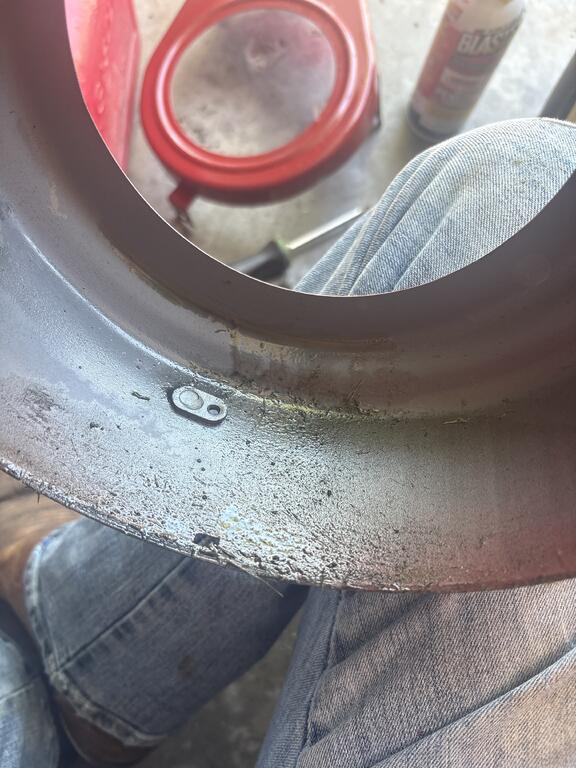

1968Commando 171 #1 Posted July 3, 2025 Noticed oil puddle under tractor and noticed it was dripping from the fan blower shield took it off and found this does this mean my flywheel must come off and I have to fix this seal, this seal is literally 2 months old so I must of messed it up somehow it didn’t start leaking till it got a few hours on it Share this post Link to post Share on other sites
squonk 46,834 #2 Posted July 3, 2025 Did you have the front bearing plate off. Plate gasket could be the source. I made the mistake of somehow putting the gasket on backwards once. Leaks showed up after a couple of days. Share this post Link to post Share on other sites
1968Commando 171 #3 Posted July 3, 2025 Just now, squonk said: Did you have the front bearing plate off. Plate gasket could be the source. I made the mistake of somehow putting the gasket on backwards once. Leaks showed up after a couple of days. Yes I did, I belive I put the gasket on rights guess I don’t know I put probably 5 hours on this rebuild before this leak showed up Share this post Link to post Share on other sites
squonk 46,834 #4 Posted July 3, 2025 Yank the flywheel and see. if the seal is dry it ain't it. Another thing. The oil pan gasket can be put on backwards and drip out the flywheel side. Share this post Link to post Share on other sites
1968Commando 171 #5 Posted July 3, 2025 4 minutes ago, squonk said: Yank the flywheel and see. if the seal is dry it ain't it. Another thing. The oil pan gasket can be put on backwards and drip out the flywheel side. Man these flywheels put up a fight Share this post Link to post Share on other sites

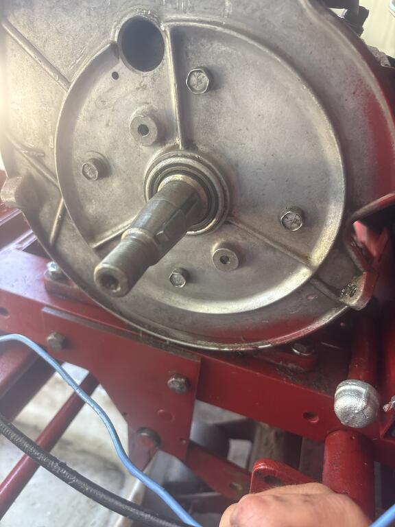

1968Commando 171 #6 Posted July 3, 2025 Got the x flywheel off @squonk here’s what it looks like I guess I’m not sure we’re the oil is coming from Share this post Link to post Share on other sites
1968Commando 171 #7 Posted July 3, 2025 Just now, 1968Commando said: Got the x flywheel off @squonk here’s what it looks like I guess I’m not sure we’re the oil is coming from Share this post Link to post Share on other sites
1968Commando 171 #8 Posted July 3, 2025 (edited) 1 minute ago, 1968Commando said: Here’s were the oil is coming out of I belive Edited July 3, 2025 by 1968Commando Share this post Link to post Share on other sites

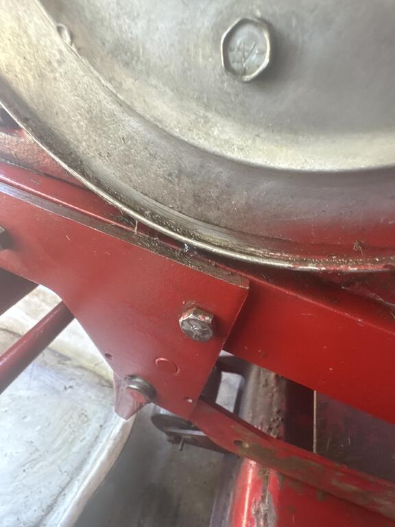

squonk 46,834 #9 Posted July 3, 2025 Try to look down the edge of the oil pan to block mating area. See if you can see the gasket sticking out a lot and almost touching your bearing plate. If so that's your leak. Same as I had. Easy to do it. Share this post Link to post Share on other sites
1968Commando 171 #10 Posted July 3, 2025 49 minutes ago, squonk said: Try to look down the edge of the oil pan to block mating area. See if you can see the gasket sticking out a lot and almost touching your bearing plate. If so that's your leak. Same as I had. Easy to do it. Well shoot it is….so does that mean I have to take the motor off, and the oil pan and do this crap again and all that work…..please tell me there’s an easier way I just painted and wired this thing Share this post Link to post Share on other sites
squonk 46,834 #11 Posted July 3, 2025 Easiest way is to yank the engine and replace that gasket and make sure it's lined up the correct way. Biggest issue for me was getting those bottom bolts back in on that heavy generator Share this post Link to post Share on other sites
1968Commando 171 #12 Posted July 3, 2025 17 minutes ago, squonk said: Easiest way is to yank the engine and replace that gasket and make sure it's lined up the correct way. Biggest issue for me was getting those bottom bolts back in on that heavy generator Okay thank you Share this post Link to post Share on other sites
