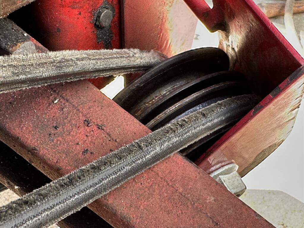

Pullstart 69,457 #1 Posted July 2, 2025 I’ve never had this happen. Thoughts? Too tight? Too loose? Worn belt? 14 Automatic, electric clutch. 42” RD deck. Sharp blades, greased spindles, quiet and tight bearings. 1 Share this post Link to post Share on other sites
peter lena 9,812 #2 Posted July 2, 2025 @Pullstart sounds like a combination of related rotational issues , ENHANCED BY ELECTRIC CLUTCH , sudden severity of rotational drag areas , ever service those 6203 , bearings in the mule drive ? that belt wear is showing you the way , BTW those bearings have wide rubber side grease shields , what could you possibly do ? that would be my first , look see . that instant violent engagement , demands related smooth / easy movement . lubrication failure is probably right there , just my view , pete Share this post Link to post Share on other sites
Ed Kennell 45,524 #3 Posted July 2, 2025 Looks like that belt needs a haircut. I see rust in the Vee pulley that may be wearing the belt. Clean all the pulleys and get a new belt. 3 Share this post Link to post Share on other sites
JoeM 9,710 #4 Posted July 2, 2025 Just thinking out loud. Drive side of the belt pops off.....has to be too loose. (but how did it force it's way out of there?) Is there something in the deck rigging not right causing misalignment and looseness? A worn belt will slip but generally will stay on the pulleys. Mule drive bearing starting to fail. that is a weird one Kev. 2 1 Share this post Link to post Share on other sites

Pullstart 69,457 #6 Posted July 2, 2025 I did my best to make sure this was set up well. This mule/belt/deck has not been on this machine before, but that shouldn’t matter much. I’ll clean the pulleys and see about a nice belt. 1 Share this post Link to post Share on other sites

squonk 45,894 #12 Posted July 2, 2025 (edited) Another thing. Look at what you're mowing. That's not Lee Trevino's practice green there and that's not a gear drive brush hog. You may have hit something that briefly stopped the blades and the belt popped off as the weakest link in the chain. Or one of those stalks could have entered the mule's chat room and popped the belt off. That belt side is moving forward as it was turning and a sudden stop would push a loose worn belt right off. Edited July 2, 2025 by squonk 1 Share this post Link to post Share on other sites
Pullstart 69,457 #13 Posted July 2, 2025 That’s about 2 weeks of growth right now 1 Share this post Link to post Share on other sites
953 nut 64,850 #14 Posted July 2, 2025 I have had a piece of debris (small twig or a clump of sod) get under the belt and derail it. Could be the idler or the deck drive pulley picked up something. 3 Share this post Link to post Share on other sites
8ntruck 8,700 #15 Posted July 3, 2025 I found a piece of a stick jammed in one of the pulleys once when I was chasing a belt twisting inside out problem. 2 Share this post Link to post Share on other sites
Lee1977 7,629 #16 Posted July 3, 2025 (edited) These old decks have worn lift part and It usually take more then the first tighten for them to get adjusted even in regular lawn grass. That belt is trashed, I've had better looking belts to turn up side down, My old 48" deck sounds like a trashing machine, but there is nothing wrong with the belts, pulleys or bearing. After installing it I have had to tighten the belt twice on it in the yard before it got an adjustment it liked. A tight lightly used deck you can get adjusted the first time. Edited July 3, 2025 by Lee1977 1 Share this post Link to post Share on other sites

lynnmor 8,701 #24 Posted July 3, 2025 On 7/2/2025 at 7:53 AM, Pullstart said: I’ve never had this happen. Thoughts? Too tight? Too loose? Worn belt? 14 Automatic, electric clutch. 42” RD deck. Sharp blades, greased spindles, quiet and tight bearings. I wonder about that downward tilt on the mule, perhaps wrong belt or pulleys? Share this post Link to post Share on other sites
