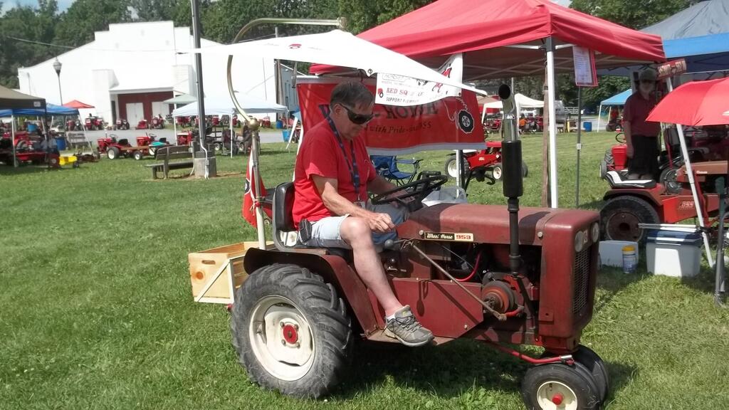

Achto 29,539 #5 Posted July 2 (edited) I have this pipe on my pulling tractor. It's inexpensive, looks good when new, light weight, it's loud and obnoxious. It also slips over a 1" water pipe so you can use that to attach it to the engine. https://www.summitracing.com/parts/sum-622147?seid=srese1&gclid=Cj0KCQjwjo7DBhCrARIsACWauSnLDSu8XZxIOU2C_N6uIlHs1_uEGm1FtUuy16plEyVn4c_UjpU_DrQaAmPOEALw_wcB Pic of my puller with the above pipe on it. Ear protection a must. Edited July 2 by Achto 3 Share this post Link to post Share on other sites

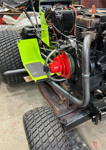

Pullstart 67,398 #13 Posted July 2 (edited) I’ve built quite a few different exhaust systems. Here are some examples for ideas… Custom built stack muffler, brace, etc. Cherry Bomb stack, with Honda Shadow Baffle Full exhaust system #1, rear exit, built with race car headers Full exhaust system #2, Briggs twin two into one, into two, dual rear exit exhaust Dual stainless stacks, WITH stock style muffler Edited July 2 by Pullstart One more link 1 Share this post Link to post Share on other sites
ri702bill 9,656 #14 Posted July 2 Two things come to mind... The lower support - bolted to the engine itself - is required. These Kohler engines require a small amount of back pressure in the exhaust to run properly. There is a perforated disc in the outlet of the glasspack of my stack setup for this. The one from @953 nut.. And the one I did on mt 854 8 speed... 1 Share this post Link to post Share on other sites
