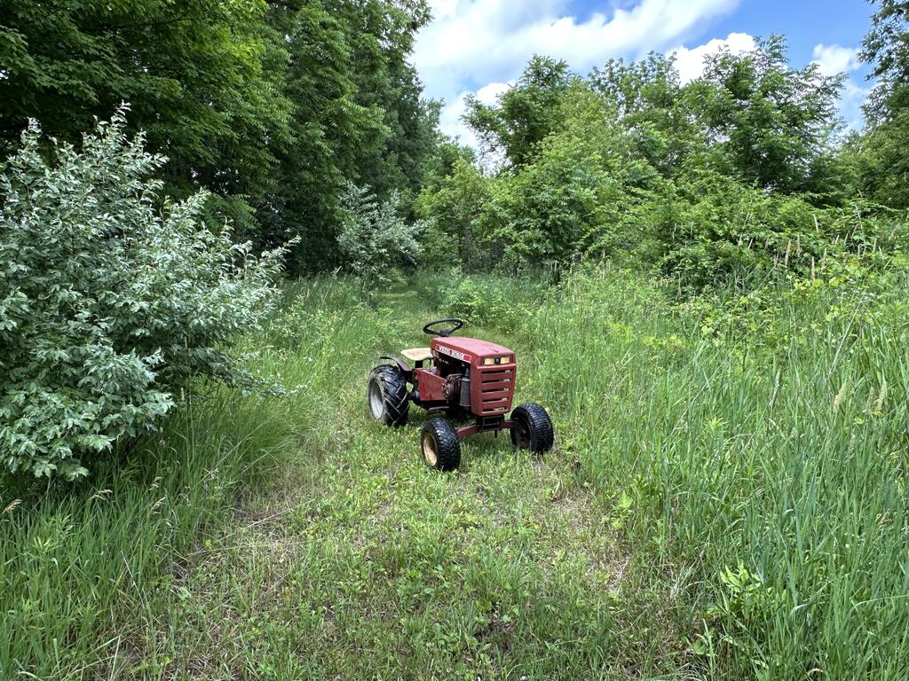

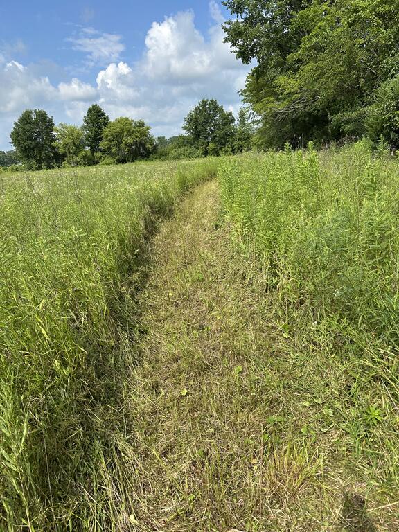

Pullstart 71,561 #29 Posted June 28, 2025 Here’s the video of getting this beast running! 4 2 Share this post Link to post Share on other sites

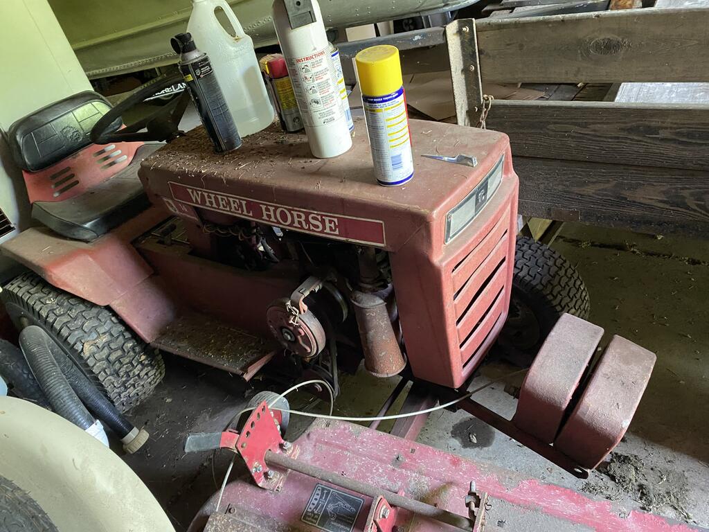

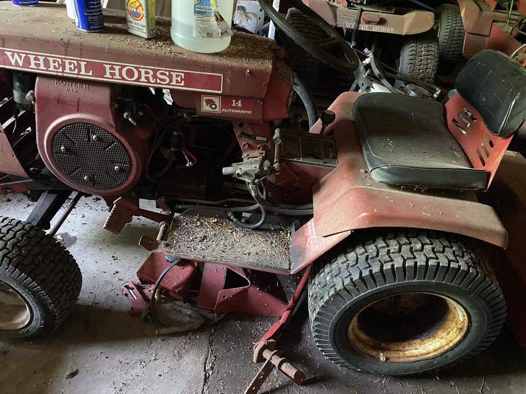

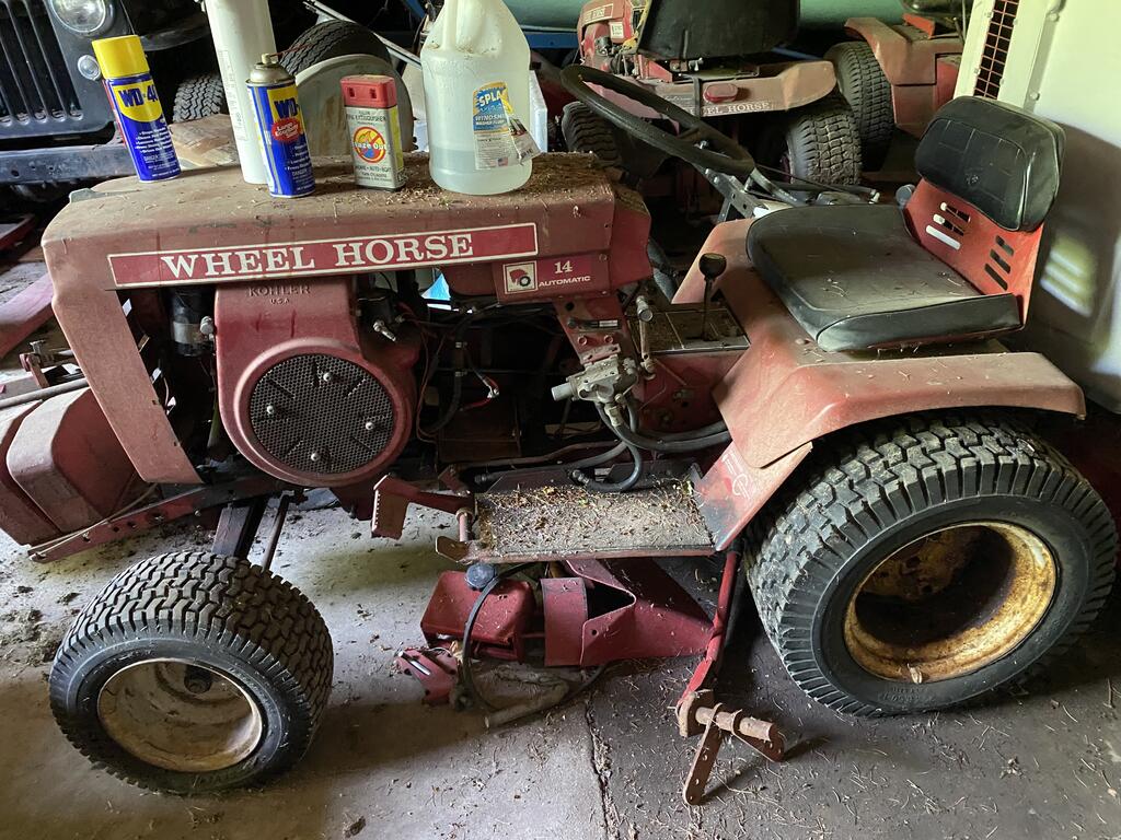

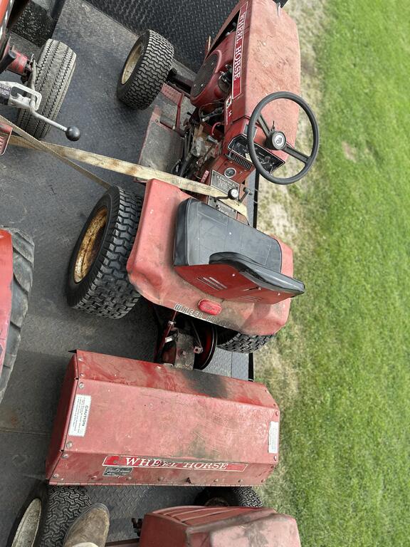

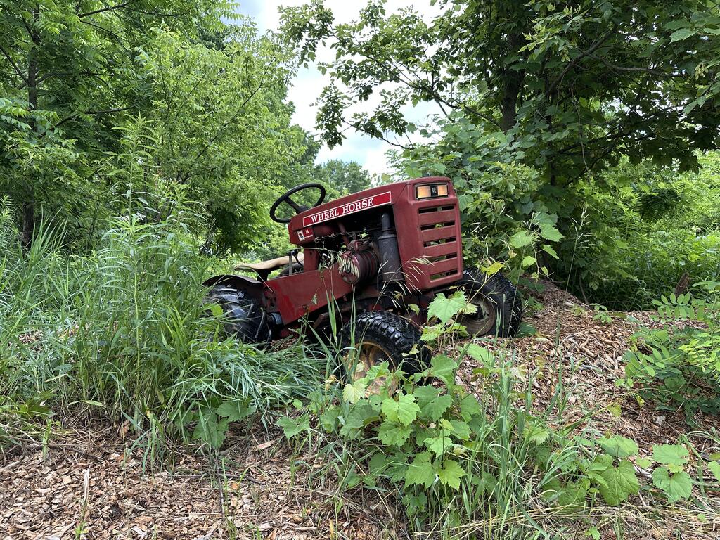

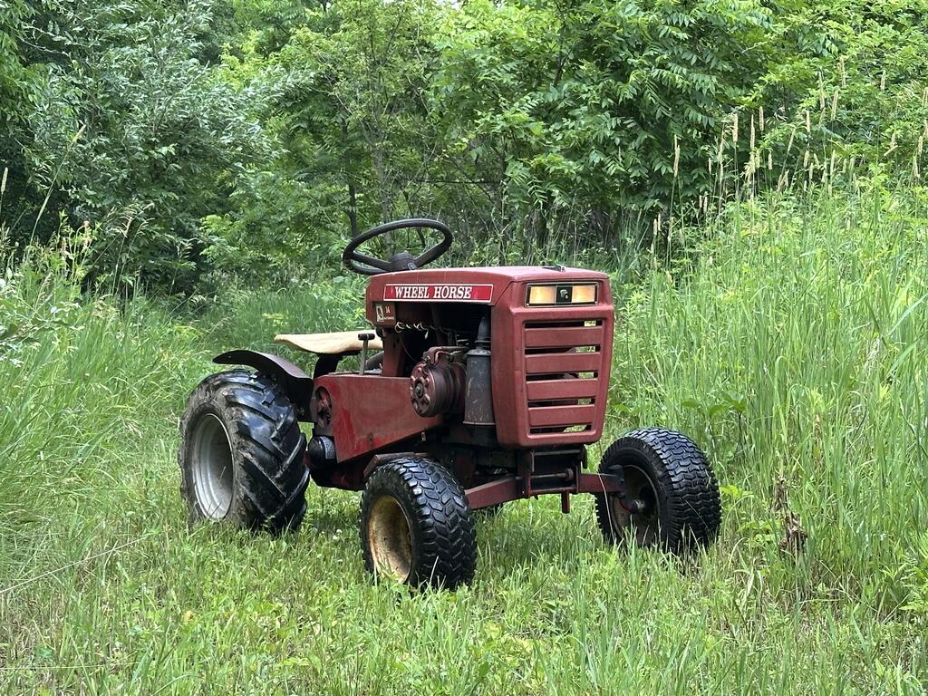

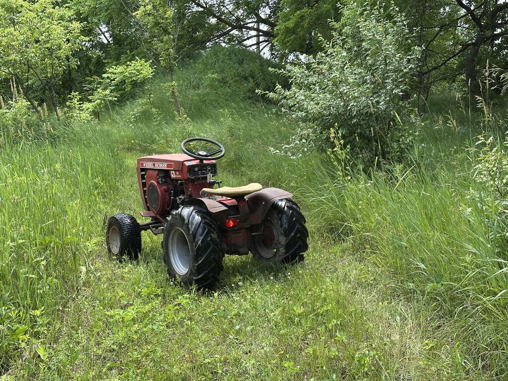

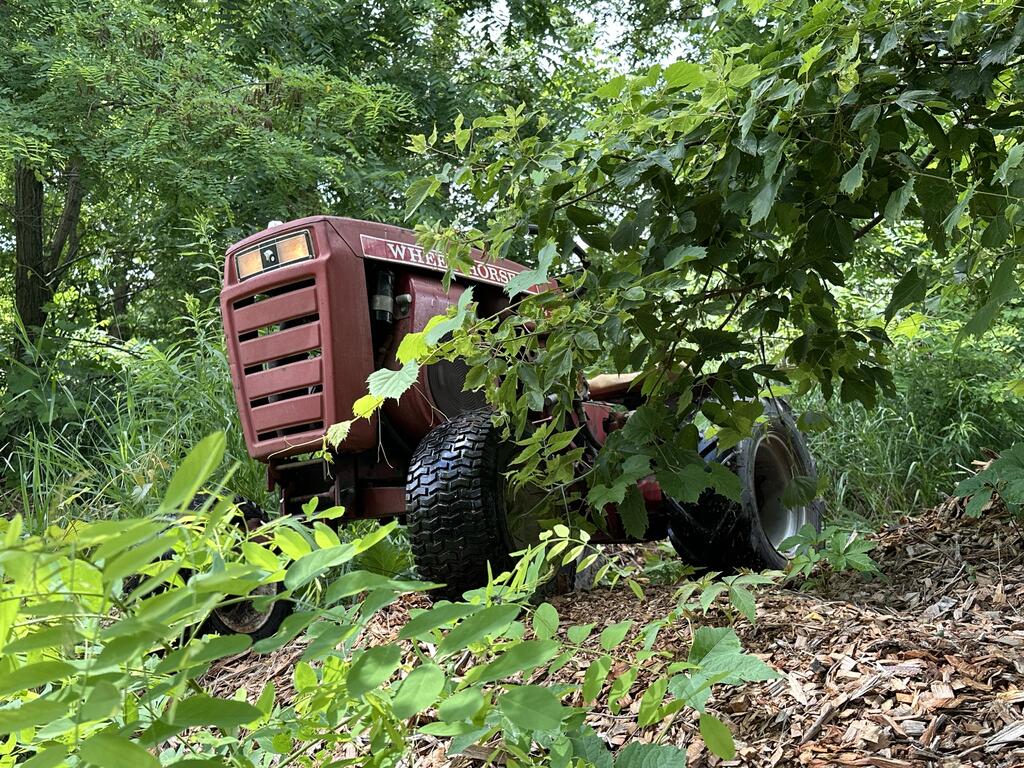

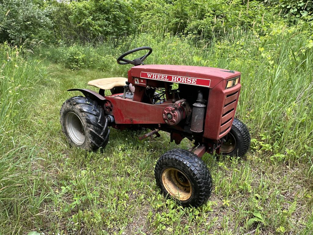

Pullstart 71,561 #30 Posted June 28, 2025 And a few pictures for reference, of the way the tractor was found. 5 2 Share this post Link to post Share on other sites

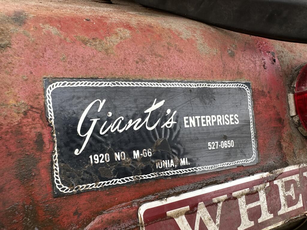

WHX?? 58,388 #33 Posted June 28, 2025 (edited) 1 hour ago, ebinmaine said: tried a mower until this year Wadda you gonna do with a mower EB ... Mow rocks?!?!? I put the pic of the dealer sticker in the dealer thread Kev. I don't know about you guys but if I came across a barn find with dueling tombstones I woulda immediately let the moths out of the wallet. Did the seller know he was sitting on the holy grail of collectibles Kev? Kinda strange tho he had them on that model tractor. Edited June 28, 2025 by WHX?? 4 Share this post Link to post Share on other sites
Pullstart 71,561 #34 Posted June 28, 2025 7 hours ago, WHX?? said: Wadda you gonna do with a mower EB ... Mow rocks?!?!? I put the pic of the dealer sticker in the dealer thread Kev. I don't know about you guys but if I came across a barn find with dueling tombstones I woulda immediately let the moths out of the wallet. Did the seller know he was sitting on the holy grail of collectibles Kev? Kinda strange tho he had them on that model tractor. They were on there because this was powering a tiller last. Keeping the front end planted was priority. 2 Share this post Link to post Share on other sites

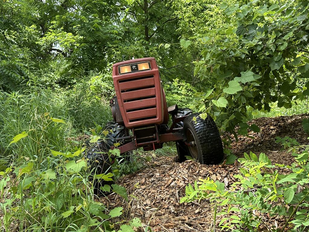

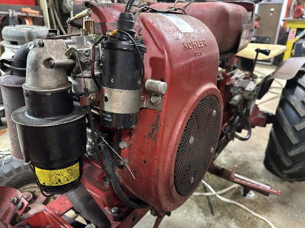

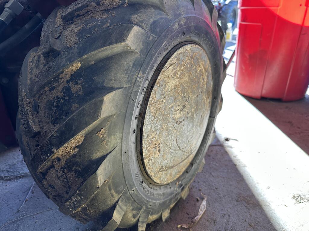

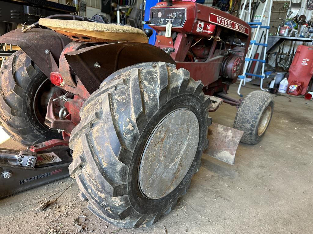

Pullstart 71,561 #35 Posted June 30, 2025 Our pool leak is taking the majority of my time, but a good tractor shine, tune and trail ride for a few minutes was just what the doctor ordered. The mixture screws were backed out pretty far, and it would occasionally stumble pretty hard. I brought them both out to 1-3/4 turns and played with it from there. It seems much happier! I swapped a set of 23x10.50 Deestones on the rear. While the tires were off, I also finished screwing the fenders to the tool box. Since I cut so much of the box away, I used a long piece of 3/8” threaded rod across the front fender braces to hold everything together, with jamb nuts inside and out of the sheet metal. I had thoughts of another stack on this. The muffler has a crack in the side but still has a decent tone. I decided I will leave it well alone until a change is necessary. 1 8 Share this post Link to post Share on other sites

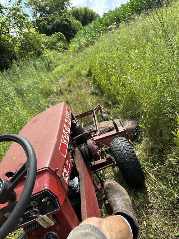

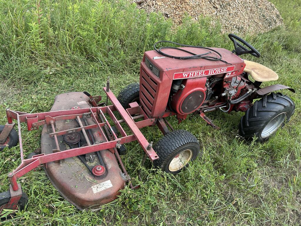

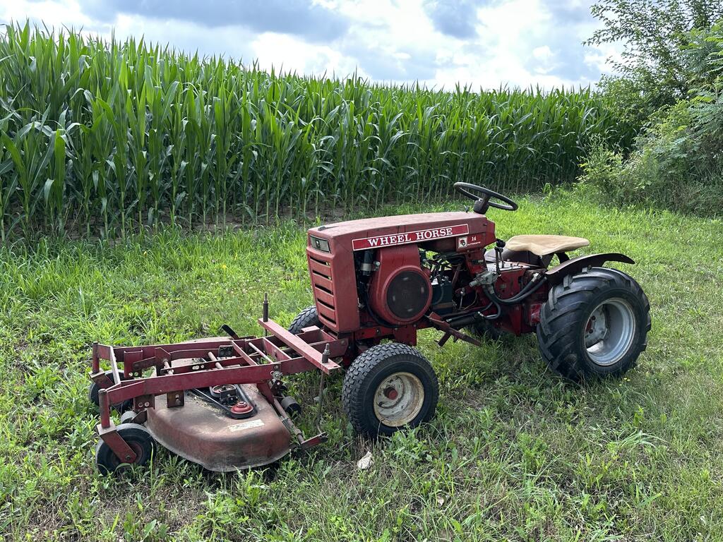

Pullstart 71,561 #37 Posted July 16, 2025 I need to mow out back in a bad way. I figured I’d do that before it gets too hot out, then do some shop work ( @ebinmaine ). My B-121 has left me giving mouth to mouth a couple times. The 42” deck does not fit that well under this 1445. The deck shell touches the back tires and the foot rests don’t fit. So I decided I should run the front mount on the 1445 to see how that works. The only remaining issue is that the aftermarket car that came on this occasionally floods out bad. I have adjusted the float level and it helped, but sometimes it just floods, even on smooth, level ground. I sold Rebel this morning as a roller but before, I took the engine out. I nabbed the carb and oil bath air cleaner (my favorite air cleaner style) and test fit it. So far, so good! I’ll toss the deck on and get chopping! 2 3 Share this post Link to post Share on other sites

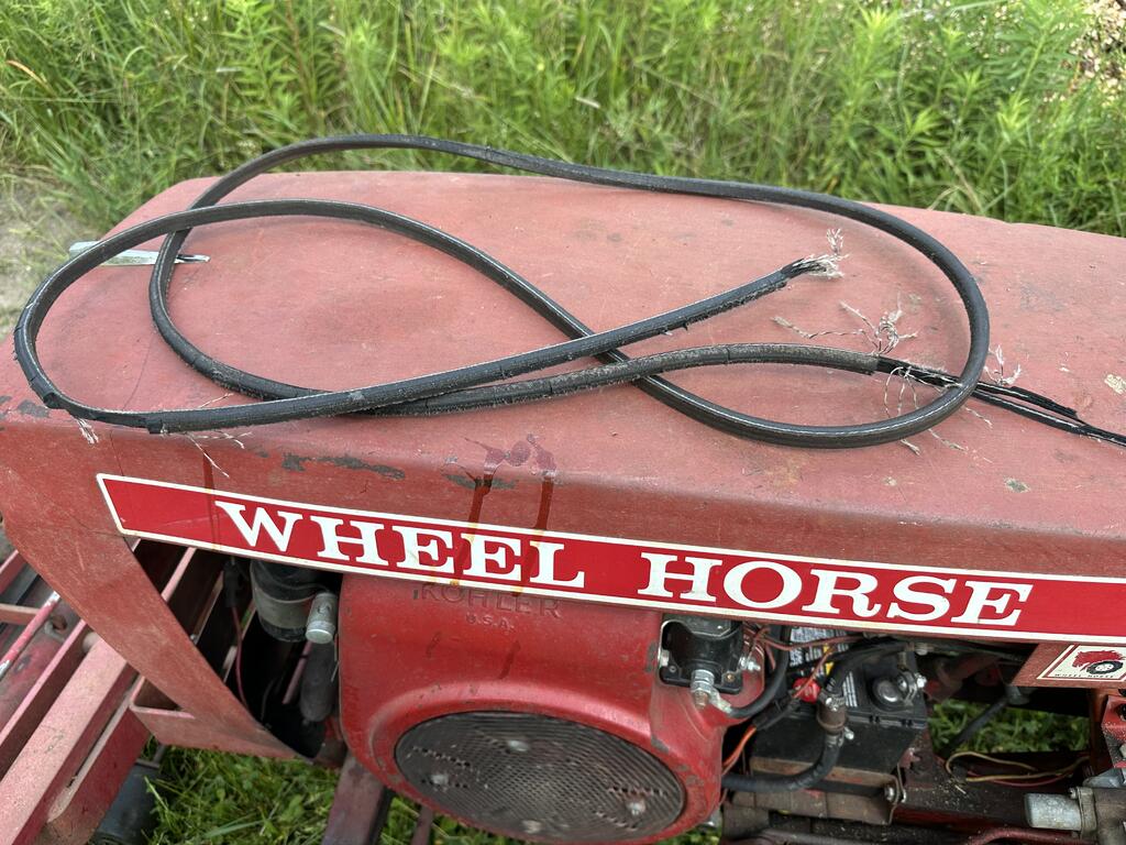

Pullstart 71,561 #38 Posted July 16, 2025 I finally after all these years, have broken a belt! I saw it twisting and hopping, then sent it flying but soon after found a nice used one hanging on the wall. A little more fuel and I am back at it! I had to lean out this carb a bit to make it run smooth, but it’s rocking and rolling! I love it, even with the electric clutch. 1 4 1 Share this post Link to post Share on other sites

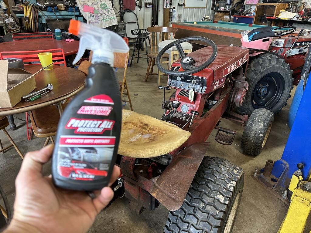

Pullstart 71,561 #43 Posted August 19, 2025 On 6/25/2025 at 6:41 PM, Pullstart said: Having that big seat spring, I can see myself doing lots of chores on it. Plus the parking pawl actually works, and neutral is spot on too! I got too comfortable with this one. Comfortable enough to be negligent and ignorant. That comfy seat really bucked me off! Fell off my 1445 story here. 2 Share this post Link to post Share on other sites

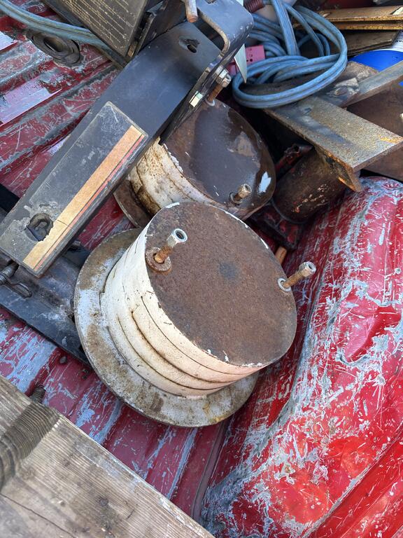

Pullstart 71,561 #44 Posted October 20, 2025 Don’t put it down, put it away! Got these sweet new wheel weights mounted! @WHX?? thanks Uncle Jim! 7 1 Share this post Link to post Share on other sites

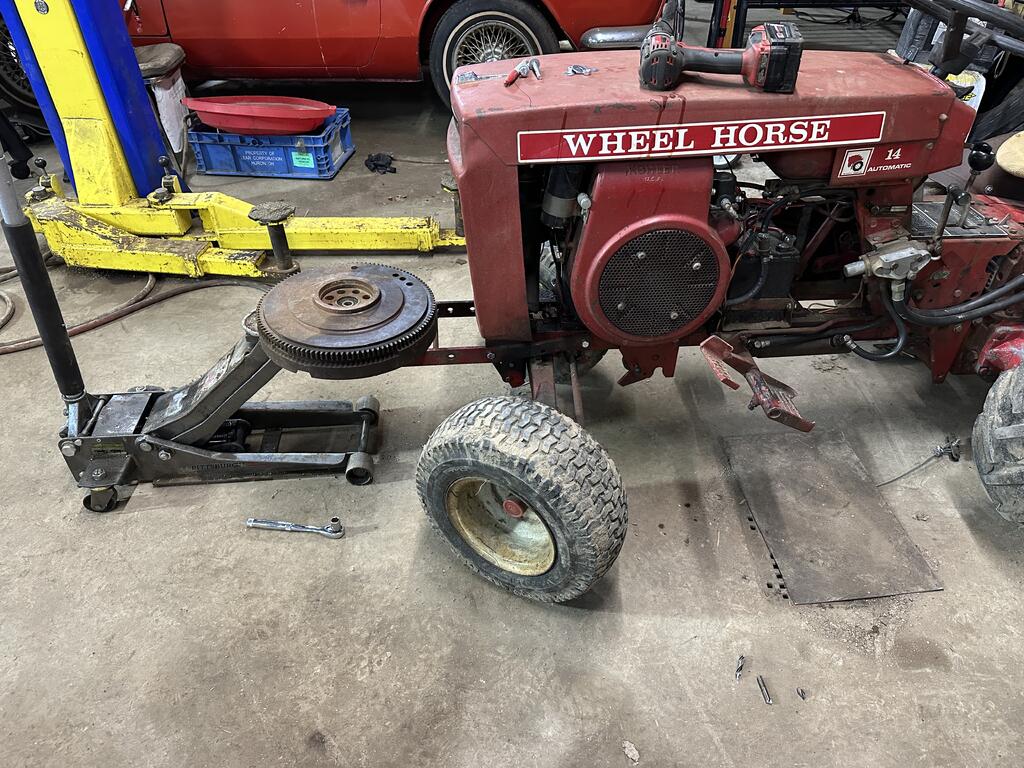

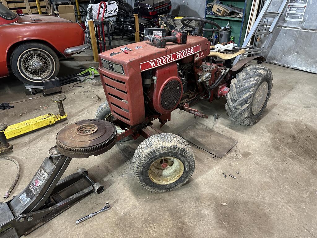

Pullstart 71,561 #49 Posted March 19 I did some upgrades tonight to the 1445. I’d like to have it be a house machine this year for plow day. The rear end is super heavy, so some front weight was in order. I also put a new Lowell lift cable on too. The flywheel is the stocker from Norman when I upgraded to a South Bend Clutch a few years back. It’s pretty heavy. 2 5 Share this post Link to post Share on other sites
