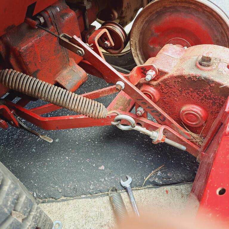

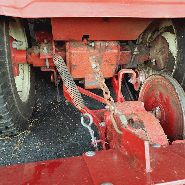

WHX?? 57,773 #6 Posted June 25, 2025 (edited) This is how I have it set up on a C-120 with hydro lift and no rear rock shaft and it works pretty good. This is how a PO had it set up which didn't work for crap. From my research the 104823 arm was part of a kit used to adapt the the tiller to other models. No idea why it was used since the tiller had the bracket on top of the housing. Edited June 25, 2025 by WHX?? 3 Share this post Link to post Share on other sites
c-series don 12,361 #7 Posted June 25, 2025 Lifting from the hood on that model tiller I believe gives a better mechanical advantage rather than the older models that lift from the tiller frame. 2 Share this post Link to post Share on other sites
WHX?? 57,773 #8 Posted June 25, 2025 3 minutes ago, c-series don said: Lifting from the hood on that model tiller I believe gives a better mechanical advantage rather than the older models that lift from the tiller frame. My thought as well given Handy Don's dissertation on lifting geometry above. 2 1 Share this post Link to post Share on other sites
