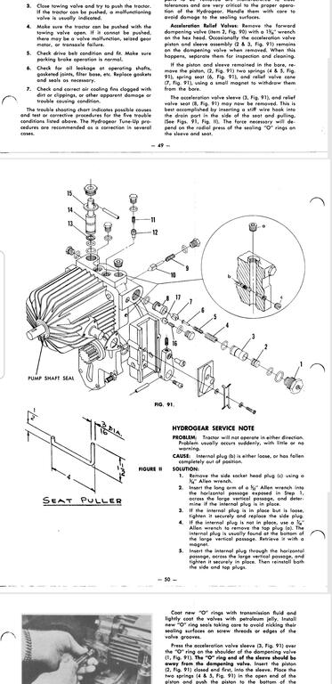

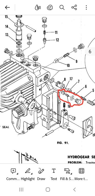

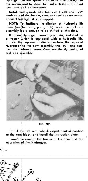

gt14rider 968 #6 Posted June 24 (edited) Good morning, I have a manual on hydraulic lift, but can't figure out how to move it here. Hope this helps. It has some part #s and picture of insulation. Edited June 24 by gt14rider Share this post Link to post Share on other sites
gt14rider 968 #7 Posted June 24 Get yourself a copy of a sundstrand manual. Part 4 has hydrogear info. 1 Share this post Link to post Share on other sites
