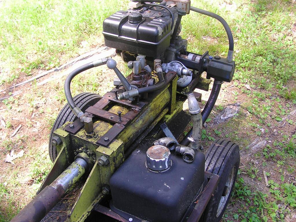

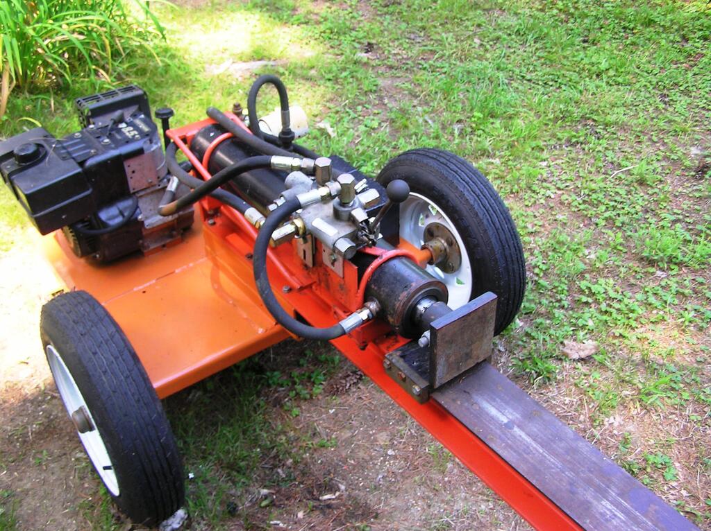

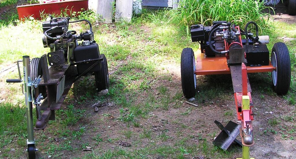

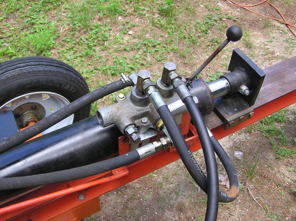

Wayne0 1,631 #1 Posted June 19, 2025 (edited) I've had a home built wood splitter for the last 30+ years. It's on an 8" beam. 10 HP Techy, 16 GPM 2 stage pump, 5" piston (from a compactor) Short 20" stroke. It is a beast and has split 24" beach crowns easily. The tongue weight is a bazillion pounds and it's a pain to move around. BTW, this splitter is on it's 3rd motor, second pump and second valve and second tank. Moving on to now. I'm too old to mess with this, so I came across another home built for short $$ on CL. 8.5 HP $375! Very nicely done and well cared for. The only problems are the valve has a detent in both directions, which is very unsafe. Also, the pump is pretty slow, although has plenty of power. It has a nice 4" piston, 24" stroke. BTW, the guy just put new bearings and new wheels and tires on it too. So now, I've swapped my old valve over to the new machine and my next move is to swap the motor and pump. His valve was side mounted so you could only work from that side. I moved it to the top so you can work from either side. This is so well balanced, I can pick the tongue up with 2 fingers! More to come. Edited June 19, 2025 by Wayne0 5 1 Share this post Link to post Share on other sites

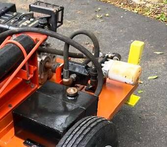

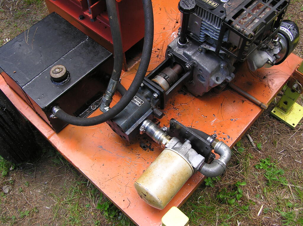

Wayne0 1,631 #7 Posted July 1, 2025 Got back on the splitters today. Pulled the pump off the "new" machine. Decided to keep the 8.5 Hp as it runs excellent. The pump bracket from the old 10 hp motor bolted right up. I got lucky with the coupling. The one on the new pump and motor matches up with the old set up although they are different brands. I needed 1/2 from each to connect. I need to relocate the filter to be able to connect the suction line. Original was 1/2" threaded, old pump is 1" barb. Gotta do some creative plumbing. Pics to come. 1 Share this post Link to post Share on other sites

Wayne0 1,631 #9 Posted July 1, 2025 Well, it's finally done! The bracket for the pump off the old 10 Hp motor bolted right up to the 8.5 Hp. To connect to the pump, I had to re-locate the filter bracket as well as get rid of the 1/2" fittings in favor of a 1" hose barb. Short piece of hose and we're in business. Got lots of parts left over. It works great! One thing I still have to do, is grind a little off both sides of the wedge so my 4 way will slip over it. While de-greasing the whole thing from all the oil, the paint wrinkled and peeled. A good excuse for a coat of Regale Red 1 Share this post Link to post Share on other sites
