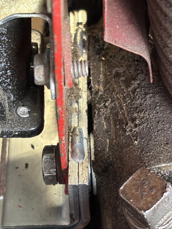

Racinbob 13,110 #8 Posted July 9, 2025 (edited) 14 hours ago, bwiesman78 said: Thanks Everyone! I decided to send it to a place in town that rebuilds them. Should have it back tomorrow. I also bought a spare starter made in Taiwan from DBElectric, but the gear teeth are about 1/8" shy of hitting the gear on the engine side. Guess I will send that one back! That seems to be a common problem recently. It's an easy fix. Put a 3/8" flat washer between the starter mount and the engine block on the PTO end. That sounds like it would cant the starter, look wrong and not work right but it corrected that same issue I had and I know that @Lane Ranger did the same thing his. It works. I have a thread on it but I don't have time to find it right now. Edited July 9, 2025 by Racinbob 1 1 Share this post Link to post Share on other sites

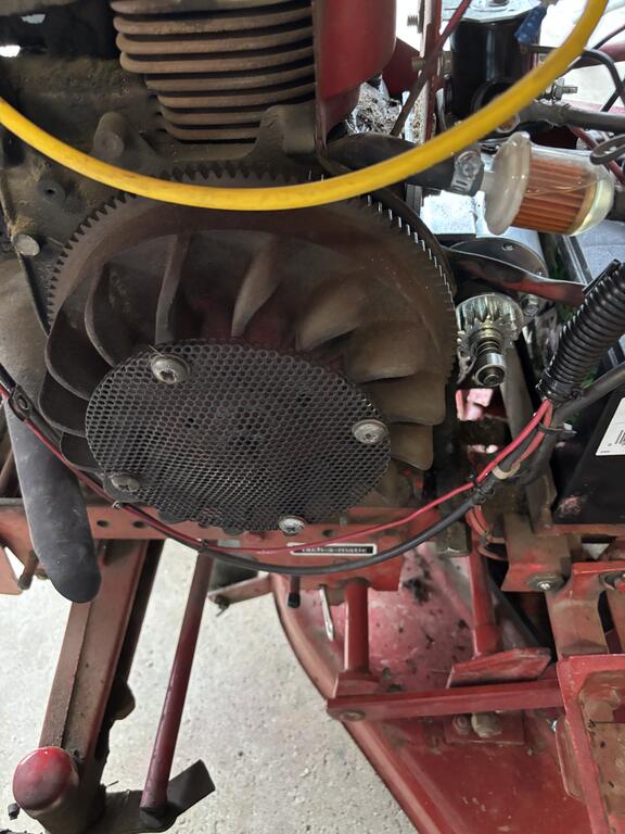

Lane Ranger 12,092 #10 Posted July 9, 2025 2 hours ago, bwiesman78 said: That's a good idea, thank you for the tip!! yes one washer behind the starter plate on hole furthest from the flywheel teeth. Hard to believe that slight difference does the job but it does ! a few pictures attached 1 Share this post Link to post Share on other sites
