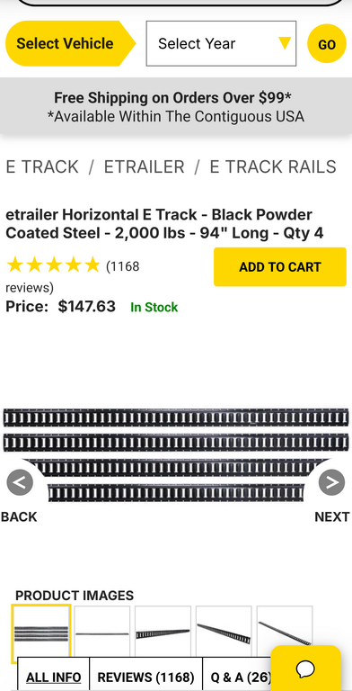

HyperPete 939 #30 Posted June 19, 2025 32 minutes ago, ebinmaine said: How's it fastened to the trailer? Many bolts through the 3/4" plywood flooring. I believe there are bolt holes about every 8 - 12" on each side of the track, and mine is 8' long. Sadly, no pics of the e-track, just the trailer. Whoops, ALMOST posted the link to the 8' horizontal track at etrailer dot com. 1 Share this post Link to post Share on other sites

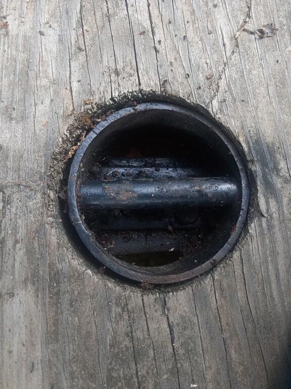

JPWH 6,544 #31 Posted June 19, 2025 This is what I have installed on my trailer. 3/8" bolt through the center to the frame and a 1/4" bolt offset to keep it from turning. 1 1 Share this post Link to post Share on other sites
