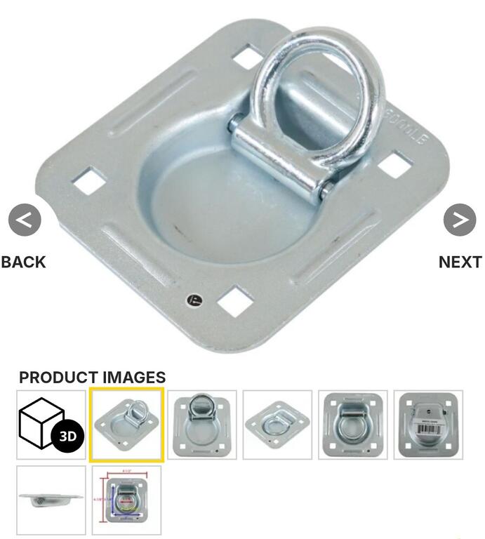

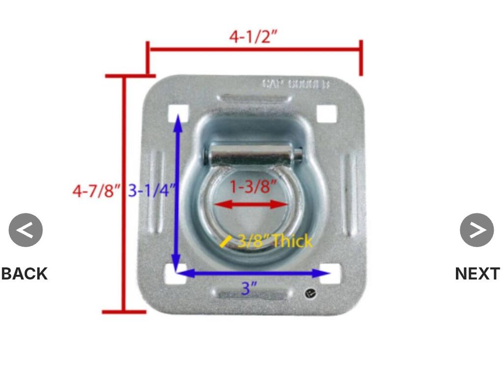

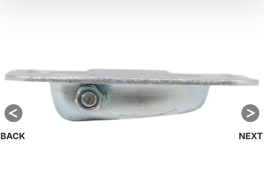

ebinmaine 81,282 #1 Posted June 11, 2025 One of the modifications I'll be doing to our new trailer is adding multiple tie down points. I'll be using flush/recessed D rings on the deck. See pics below. There will be 12 of these. 6 per side. Approximately 20 ish inches in from each outside edge. They'll be attached to the steel cross members at two of the four holes per ring. The main question I have is: Should I drill a 3+ inch diameter hole all the way through the deck boards? Or learn to use my router to make a "pocket" and drill a small centered drain hole in the pocket? What say you, oh Redsquare gurus?? 1 Share this post Link to post Share on other sites
Pullstart 71,561 #2 Posted June 11, 2025 For moisture and draining purposes, I’d suggest a pocket, and a drain hole in the center. 5 Share this post Link to post Share on other sites
953 nut 70,654 #3 Posted June 11, 2025 If you haven't already purchased the flush mounts I would just use the surface mounted "D" rings. They don't stick up that high and won'6t capture water leading to rotted boards. 4 1 Share this post Link to post Share on other sites
Wayne0 1,666 #4 Posted June 11, 2025 (edited) I really don't think it matters as long as water doesn't pool and soak. Myself, I'd blow a hole right through to avoid any water sitting there. Is the decking PT? Edited June 11, 2025 by Wayne0 2 Share this post Link to post Share on other sites
Handy Don 17,735 #5 Posted June 11, 2025 (edited) 17 minutes ago, Pullstart said: For moisture and draining purposes, I’d suggest a pocket, and a drain hole in the center. And once you’ve routed the pockets, drilled the drain hole (⅜ or ½”), and drilled the mounting holes then, even though the deck is pressure treated, apply a good wood sealer liberally before mounting the rings. Edited June 11, 2025 by Handy Don 3 Share this post Link to post Share on other sites
ebinmaine 81,282 #6 Posted June 11, 2025 2 minutes ago, 953 nut said: If you haven't already purchased the flush mounts I would just use the surface mounted "D" rings. They don't stick up that high and won'6t capture water leading to rotted boards. I went with the four bolt flush mount hold downs for the ability to have a flat deck. The extra strength is a bonus. 1 Share this post Link to post Share on other sites
ebinmaine 81,282 #7 Posted June 11, 2025 2 minutes ago, Handy Don said: apply a good wood sealer Brand preferences?? 1 Share this post Link to post Share on other sites
Handy Don 17,735 #8 Posted June 11, 2025 (edited) 7 minutes ago, ebinmaine said: Brand preferences?? For years I used a now-banned, high VOC preservative. Lately, I’m using Thompson Water Seal which works well. As with most similar VOC-compliant clear products, exposure to the sun does diminish its effectiveness over two or three years. Areas not in direct sun are good for 3-5 years. Preservative stains with suspended solids (e.g. “paint stains”) last much longer. Edited June 11, 2025 by Handy Don 1 1 Share this post Link to post Share on other sites
JimSraj 593 #9 Posted June 11, 2025 (edited) Since the part that will be recessed isn’t round, I’d make a template that’s slightly larger than matching the shape of the part of the hold down that will be recessed, including the bolt and nut. Fasten the template to the deck and rout in steps until you are deep enough, using a plunge bit with a flush bearing. If you want to make the top of the flange flush with the top of the deck, make a second template matching the outside of the 4-7/8” x 4-1/2” with radiused corners. Set the hold down in the routed recess and trace the flange. Fasten second template and rout to match thickness of flange. Drill your holes using the hold down to guide the drill. Drill your drain hole if you like. Make sure your template is thick enough to allow you to start the first pass with the bearing on top of the cutter. Edited June 11, 2025 by JimSraj Added text 3 1 1 Share this post Link to post Share on other sites

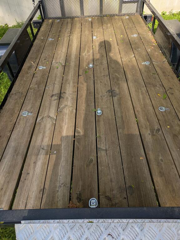

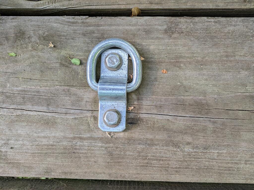

rjg854 13,454 #23 Posted June 17, 2025 This is my trailer D-rings, just lagged them into the treated decking. 1 Share this post Link to post Share on other sites
ebinmaine 81,282 #24 Posted June 17, 2025 1 minute ago, rjg854 said: This is my trailer D-rings, just lagged them into the treated decking. The way this was explained to me by my trailer dealer: If the fastener is ONLY in the wood then you're depending entirely on the strength of the wood in a fast stop or worse situation. The bolt threads will pull out of wood LONG before the same is true for steel. I don't have a formula for understanding the deceleration of mass from say 55 mph to zero. Imagine a 600 lb tractor trying to come to a complete stop when the trailer does.... This is several THOUSAND pounds of force now pulling at the wood. Share this post Link to post Share on other sites
