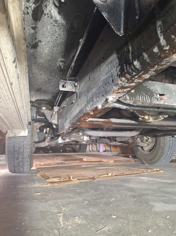

Beap52 2,537 #1 Posted June 10, 2025 my 1992 GMC K2500 elsewhere is my daily driver, however I don't drive a lot of miles about two thousand so far this year. One thing I have been doing on my vehicles the past fifteen years or so is using my pump up sprayer and coating the undersides and inside the fenders with Penetrol. Penetrol is used in oil based paint to help it flow smoother and I'm sure the main ingredient is linseed oil. It's been two or three years so today I crawled under and touched up a a few spots. 2 4 1 Share this post Link to post Share on other sites

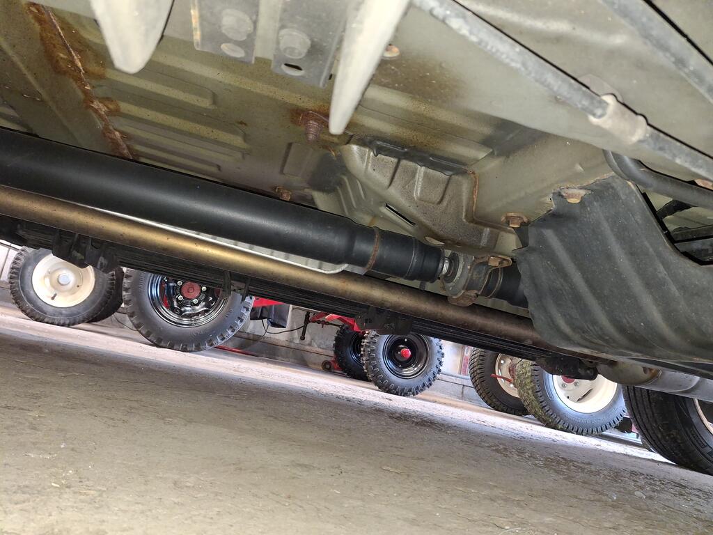

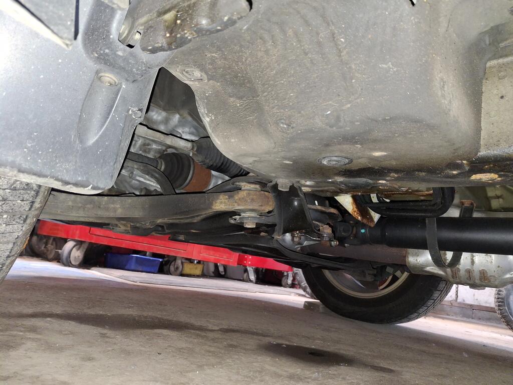

squonk 48,427 #6 Posted June 10, 2025 In the mid 87 year GM switched to the new trucks with the boxed in frame as opposed to the C channel style. The main issue is the crap that gets inside the frame. I lost my 2013 GMC last Sept to a rotted frame. I saw a tool pop up on FB that looks to be a neat idea to wash the inside of the frames out. A magnetic swirly gig sprayer called the chassis grenade you pop on a frame hole and let it rip! https://www.saltycaptain.co/products/4wd-wash-chassis-flusher-kit I bought a clean Honda Ridgeline to replace my GMC and bought a Woolwax undercoat gun kit and used PB Blaster Surface Shield on it. I got back underneath it this spring and it held up well thru the winter. Also enrolled in a local car wash monthly unlimited wash club that will be worth the cost in the long run. https://www.woolwaxusa.com/Woolwax-Pro-Undercoating-Applicator_p_16.html https://blasterproducts.com/product/surface-shield/ 2 Share this post Link to post Share on other sites

squonk 48,427 #8 Posted June 10, 2025 Shot of the Surface Shield protection after a winter and several washings. 2011 Honda Ridgeline. 1 Share this post Link to post Share on other sites
