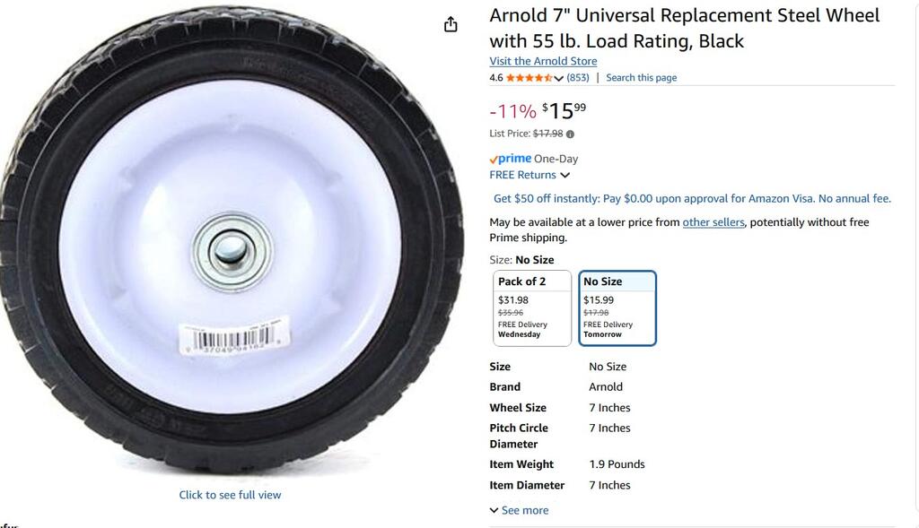

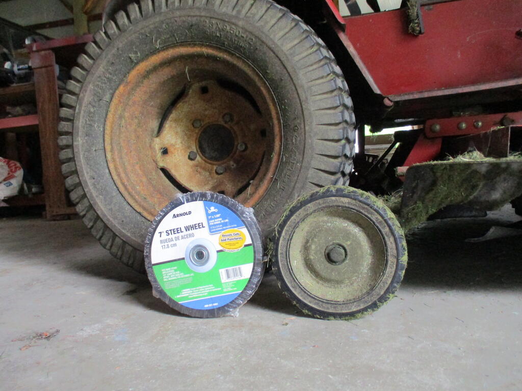

pfrederi 21,217 #5 Posted June 9, 2025 (edited) Been running these for 3 years now. No problem getting the deck adjusted for slight down at the front. Price has almost doubled since I bought two sets... surprise surprise Edited June 9, 2025 by pfrederi 1 Share this post Link to post Share on other sites
JimSraj 585 #6 Posted June 9, 2025 1 hour ago, pfrederi said: Been running these for 3 years now. No problem getting the deck adjusted for slight down at the front. Price has almost doubled since I bought two sets... surprise surprise Thanks they are just what I am looking for. This deck cuts beautifully since I corrected the deck/spindle angle that had developed. (See my previous post on bent deck. ) I just want to be able to raise the level of the cut closer to 4”. Share this post Link to post Share on other sites
