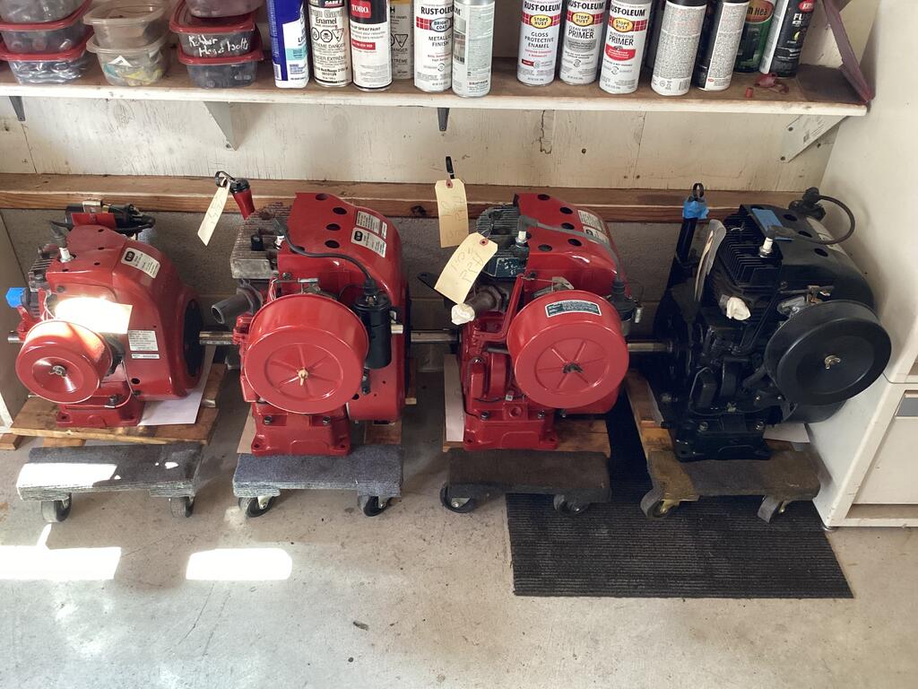

richmondred01 2,393 #3 Posted June 7, 2025 1 hour ago, 953 nut said: For $ 50.00 you are off to a good start. If you have a good machine shop nearby that will bore a cylinder and turn a crank for a reasonable price that would be the way to go. Buying a used engine from another Wheel Horse would work but you won't know how long the used engine will last. One of our members here rebuilds engines and you may want to check with @richmondred01 to see what he would charge or ifr he has one already rebuilt for sale. I can rebuild it for you. Buying a used engine is always a gamble. I’ll make it right. PM me if interested. 1 1 Share this post Link to post Share on other sites

richmondred01 2,393 #8 Posted June 10, 2025 I’ve got two fully rebuilt 16’s ready to go. PM me if interested. Share this post Link to post Share on other sites
