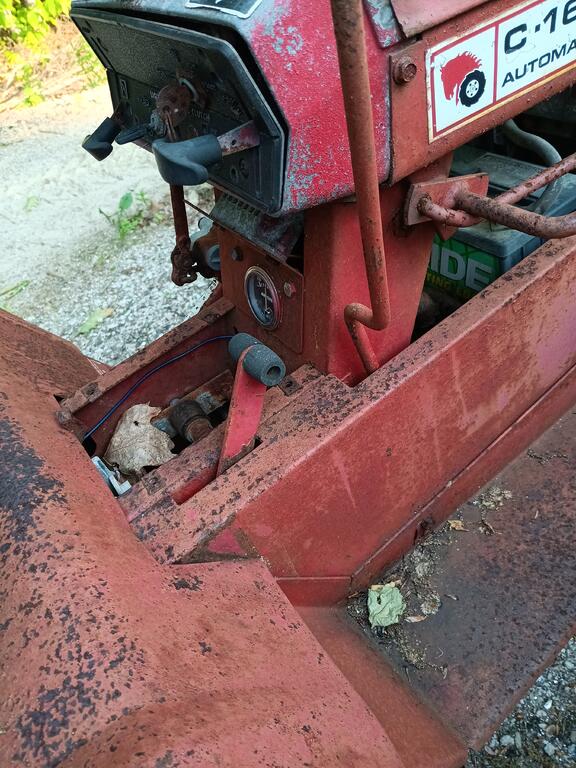

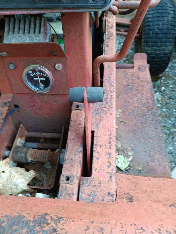

sqrlgtr 2,248 #1 Posted June 5, 2025 Was hoping someone would have a picture of the correct hydro belt engagement handle for this tractor. Here is a pic of what appears to be a homemade one that's on it now. I was thinking that it was a littlt different than the later models but may be the same. Hoping to find correct one at big show. Share this post Link to post Share on other sites

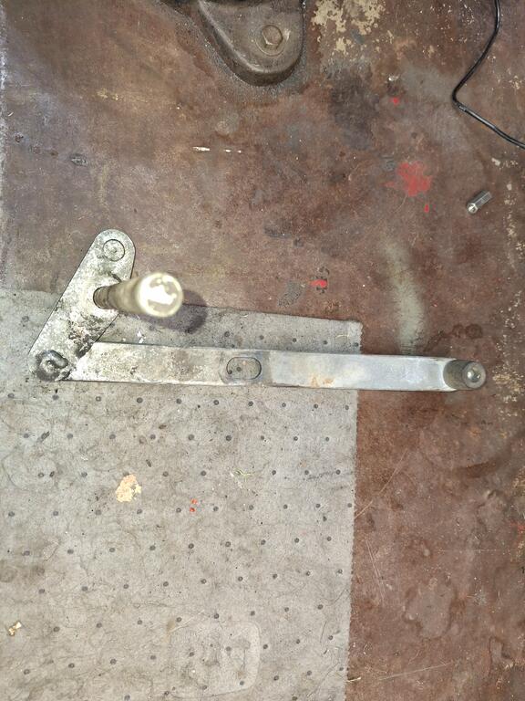

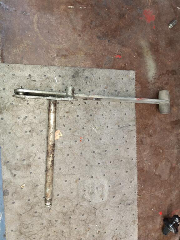

ebinmaine 77,547 #2 Posted June 5, 2025 Likely something like this... Share this post Link to post Share on other sites
sqrlgtr 2,248 #3 Posted June 5, 2025 Yes I think that is what they looked like. The only other hydro machine I have is a GT14 and its made a little different, I think. Share this post Link to post Share on other sites
sqrlgtr 2,248 #4 Posted June 5, 2025 I assume someone cut belt guard trying to figure out how it was supposed to work . Thanks for pic. 1 Share this post Link to post Share on other sites
squonk 45,613 #5 Posted June 5, 2025 I might have one of those levers. I'll have to look 1 1 Share this post Link to post Share on other sites
Ed Kennell 45,043 #6 Posted June 5, 2025 5 minutes ago, sqrlgtr said: I assume someone cut belt guard trying to figure out how it was supposed to work . Thanks for pic. Probably too long of a belt that allowed the tensioner pulley to rub the belt guard. 1 1 Share this post Link to post Share on other sites
ebinmaine 77,547 #7 Posted June 5, 2025 4 minutes ago, Ed Kennell said: Probably too long of a belt that allowed the tensioner pulley to rub the belt guard. Agreed. I've had one here that had that..... issue. Share this post Link to post Share on other sites
sqrlgtr 2,248 #8 Posted June 5, 2025 Might have been what happened. Never would have thought about that. What ever/who ever happened at least they cut it good and square looking. @squonkif you find one bring it along if you don't mind,,, Share this post Link to post Share on other sites

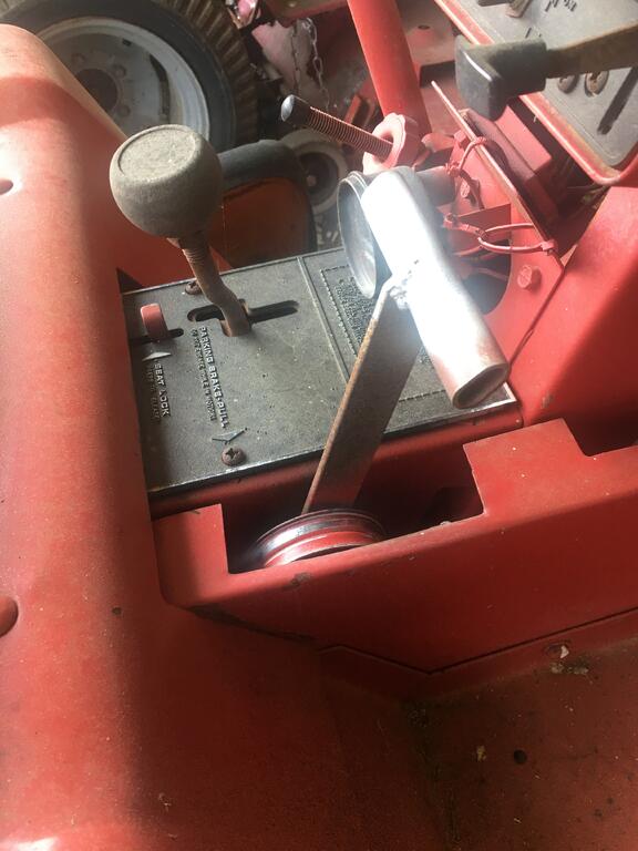

kpinnc 17,292 #9 Posted June 6, 2025 I think the best ones look like this: If you don't like the look, you will love the sound... 2 Share this post Link to post Share on other sites
sqrlgtr 2,248 #10 Posted June 6, 2025 @kpinnc I dont see one in your pic? I always thought the go go/ back up stick was in a lot better position were that one is instead of between your legs. Share this post Link to post Share on other sites
kpinnc 17,292 #11 Posted June 6, 2025 2 hours ago, sqrlgtr said: @kpinnc I dont see one in your pic? I always thought the go go/ back up stick was in a lot better position were that one is instead of between your legs. I removed the engagement/ brake lever. Just added a tension spring for the pulley and it's worked great for years. Two different tractors and both work well. Personal opinion here: I've not seen a Sundstrand hydro yet that didn't have a damaged park brake pawl. This introduces metal fragments into the hydro and eventually some of it will pass through the strainer and damage the pump or motor. So I remove the linkages except the arm on the pawl itself. Let gravity pull the arm down and it never contacts the gears again. Then just add a firm spring to maintain tension on the idler pulley. This is the exact same evolution that came between the early and later Eaton systems minus the brake pawl. 3 Share this post Link to post Share on other sites
ebinmaine 77,547 #12 Posted June 6, 2025 3 minutes ago, kpinnc said: I removed the engagement/ brake lever. Just added a tension spring for the pulley and it's worked great for years. Two different tractors and both work well. Personal opinion here: I've not seen a Sundstrand hydro yet that didn't have a damaged park brake pawl. This introduces metal fragments into the hydro and eventually some of it will pass through the strainer and damage the pump or motor. So I remove the linkages except the arm on the pawl itself. Let gravity pull the arm down and it never contacts the gears again. Then just add a firm spring to maintain tension on the idler pulley. This is the exact same evolution that came between the early and later Eaton systems minus the brake pawl. Interesting concept. I'm not sure I'd do that here in the land of 5 months of winter though. When I cold start the K341 for snow plow duty I always let the engine warm before engaging the transmission. All that oil is pretty unwilling to participate for a bit. How do you "put it in park"? My 1978/79 has a brake drum. The '75 however, does not. Share this post Link to post Share on other sites
kpinnc 17,292 #13 Posted June 6, 2025 18 minutes ago, ebinmaine said: How do you "put it in park"? My 1978/79 has a brake drum. The '75 however, does not. Good point. Both of mine are hydrogears. No external brake. I probably should've mentioned that. Neither of my release levers actually stopped the belt from turning while cranking. 1 Share this post Link to post Share on other sites
ebinmaine 77,547 #14 Posted June 6, 2025 2 minutes ago, kpinnc said: Good point. Both of mine are hydrogears. No external brake. I probably should've mentioned that. Neither of my release levers actually stopped the belt from turning while cranking. My 1975 definitely does let the belt roam free. Now that you mention it, I'm not sure about the later model. Share this post Link to post Share on other sites

sqrlgtr 2,248 #18 Posted June 6, 2025 @squonk what would be the damage for me to acquire that piece. Share this post Link to post Share on other sites
sqrlgtr 2,248 #20 Posted June 6, 2025 K I will just take it Share this post Link to post Share on other sites
