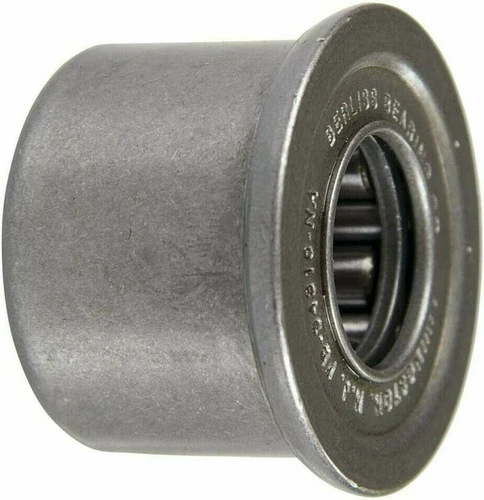

stvski80085 279 #1 Posted June 2, 2025 Will these work on a 77 b-80. They look deeper then the standard cheep ones you can get. I bought a caged bearing for in between the two outer bearings but it get's caught up on the inside by the grease fitting. Tried sanding but still an issue. Just looking for something more robust. Steve 1 Share this post Link to post Share on other sites
kpinnc 18,969 #2 Posted June 2, 2025 (edited) I've used them and they are indeed much stronger than the 1/2 inch standard bearing. BUT the important item of note is simple: if the spindles you place it on has a groove worn on the bottom (as many do), that bearing will damage itself and the spindle. Edited June 2, 2025 by kpinnc 4 Share this post Link to post Share on other sites
stvski80085 279 #3 Posted June 2, 2025 Thanks. My spindles look brand new so I may give these a try. Steve 2 Share this post Link to post Share on other sites

stvski80085 279 #5 Posted June 2, 2025 12 minutes ago, kpinnc said: I've used them and they are indeed much stronger than the 1/2 inch standard bearing. BUT the important item of note is simple: if the spindles you place it on has a groove worn on the bottom (as many do), that nearing will damage itself and the spindle. Did you use two per wheel or just one on each wheel? Steve 1 Share this post Link to post Share on other sites

Horse Newbie 7,405 #7 Posted June 2, 2025 1 hour ago, stvski80085 said: Did you use two per wheel or just one on each wheel? Steve I know @kpinnc will be along shortly to answer this, but yes I believe you do use two per wheel, just like the cheapies… one inner and one outer… 3 Share this post Link to post Share on other sites
ebinmaine 80,740 #8 Posted June 2, 2025 46 minutes ago, Horse Newbie said: I know @kpinnc will be along shortly to answer this, but yes I believe you do use two per wheel, just like the cheapies… one inner and one outer… To the best of my knowledge this is correct 1 Share this post Link to post Share on other sites
kpinnc 18,969 #9 Posted June 2, 2025 3 hours ago, stvski80085 said: Did you use two per wheel or just one on each wheel? Two per wheel. 1 Share this post Link to post Share on other sites
