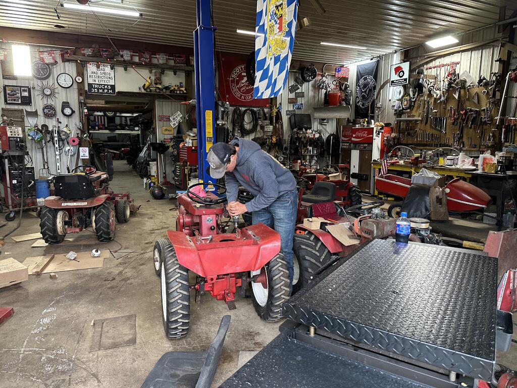

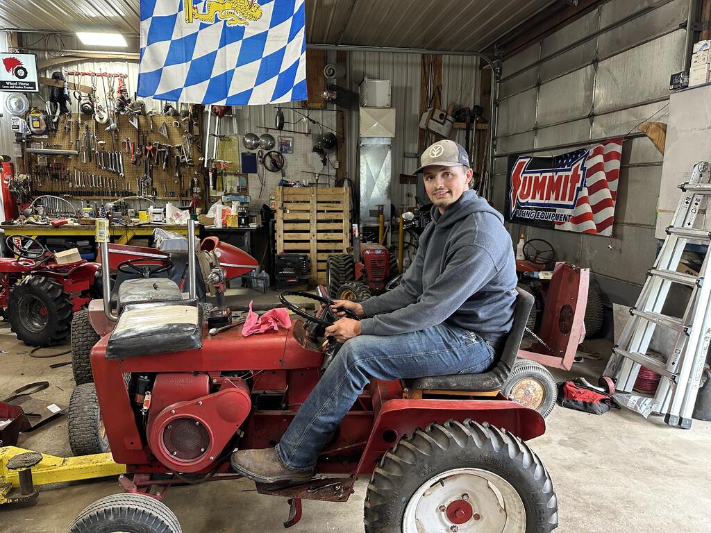

Pullstart 71,561 #28 Posted June 4, 2025 Well as fast as it came, it’s gone. Kind of. But not gone, just not mine. We found a seat off of what I think was “Big Junky” if I recall, and it had some brackets we could utilize to give it a lift kit, relocation, and still hinge up for the fuel access. I gave it to Brenen. He can reach all the controls and sit comfy. Winning! The short list of it’s needs: tighten the steering up secure/shorten the fuel hose that’s dangling the right side tie rod is held together with that blue bungee remove the deck bracket find a lift cable as the original is broken 8 1 Share this post Link to post Share on other sites

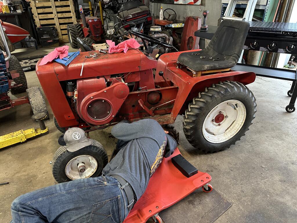

Pullstart 71,561 #30 Posted June 5, 2025 9 hours ago, Pullstart said: The short list of it’s needs: tighten the steering up secure/shorten the fuel hose that’s dangling the right side tie rod is held together with that blue bungee remove the deck bracket find a lift cable as the original is broken and give it a name! We accomplished quite a bit last night, while Rylee and her girls were out playing in the rain. The drive belt was also more rubber than Kevlar. It did not like to let go of the pulleys when attempting to shift. I found a decent used one out back, and we swapped it over. The steering shaft is pretty loose inside the steering gear. It’s a concern of mine, and hopefully we can get it cleaned up and tightened up for the show. 2 3 Share this post Link to post Share on other sites

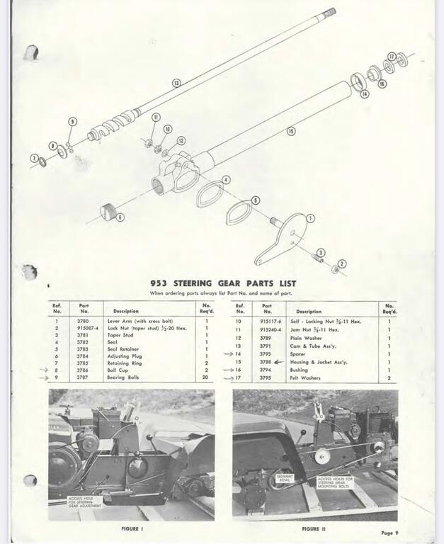

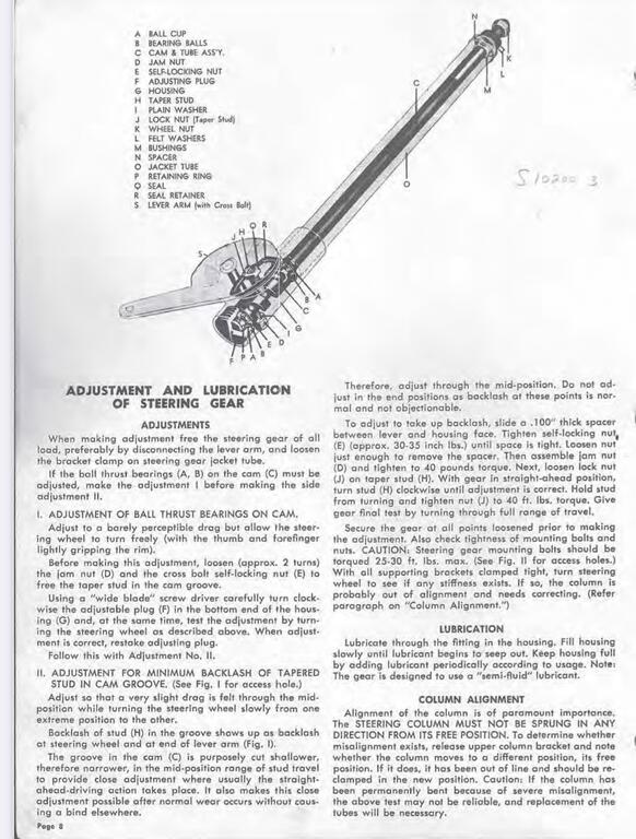

Pullstart 71,561 #32 Posted June 5, 2025 @953 nut I’m sure you’ve been into one of these steering sets. If the steering wheel is removed, can the column drop out the bottom of the tractor or does the dash need pulled? 1 Share this post Link to post Share on other sites
953 nut 70,655 #33 Posted June 5, 2025 1 hour ago, Pullstart said: The steering shaft is pretty loose inside the steering gear. It’s a concern of mine, and hopefully we can get it cleaned up and tightened up for the show. I'm aware that this is not the manly thing to do and should only be considered as a last resort . . . . . BUT . . . . . on page 69 of the 953 Owner Manual there is a rather detailed adjustment sequence for the Ross steering box. 1 1 Share this post Link to post Share on other sites
953 nut 70,655 #34 Posted June 5, 2025 2 minutes ago, Pullstart said: If the steering wheel is removed, can the column drop out the bottom of the tractor Yes, if I remember correctly there are two 3/8" bolts that can be accesses through openings provided in the dash tower, remove them and it will come right out. 1 Share this post Link to post Share on other sites
oliver2-44 11,847 #35 Posted June 5, 2025 @Pullstart I've only been into two of these Ross boxes, one on my 64 Case and the other my 49 Mayrath. But If I remember correctly, that pin (item 3) can be removed with out pulling the column. The are the high wear part, wearing on one side, grind a new curved end to match the good side, or weld up and grind. You have a lathe, that's even better. Item 1 can also be removed to clean out old grease. If you disassemble, the bearing balls can be found in the Hillman drawers at your hardware store. some Ross boxes had a plastic bearing retainer, if its disintegrated, just put heavy grease on the balls to hold them in place for reassembly. Under the steering wheel at the top of the tube, if it doesn't have an upper support guide/bearing you can add a front wheel bearing to the top of the tube to give it some side to side support. That tractor looks like its been kept out of the weather. But the steering tube are known to rust thin at the top of the steering box. The tube is an Odd size by todays tubing standards. I used a trampoline leg tube on my Case with a little light grinding to make it fit. On my Mayrath I got a piece of tubing from a Muffler Shop friend and had him use his hydraulic expander to make it the perfect size. 3 Share this post Link to post Share on other sites
Pullstart 71,561 #36 Posted June 5, 2025 30 minutes ago, oliver2-44 said: hydraulic expander to make it the perfect size. I got one of those tools around here too, great idea if needed! thanks for the tips! 1 Share this post Link to post Share on other sites

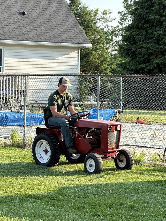

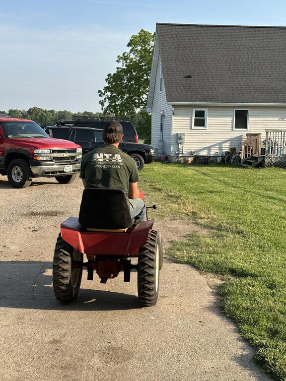

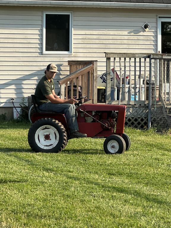

Pullstart 71,561 #46 Posted June 12, 2025 After we tossed the new belt on, we buttoned things up and pushed it aside. When a need arose to drive it, the belt was slipping bad enough to act like it was in neutral. I taught Brenen how to adjust the linkage a bit, and last night it took right off. His first drive! 1 5 Share this post Link to post Share on other sites
Pullstart 71,561 #47 Posted June 12, 2025 Using a 7/8” wrench, we loosened the nut on the steering cross shaft, turned the plug in the bottom of the steering gear in a bit, and the steering tightened up significantly! Another one is ready for the show! 4 Share this post Link to post Share on other sites
