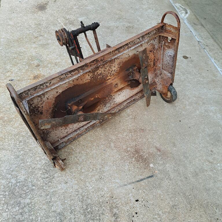

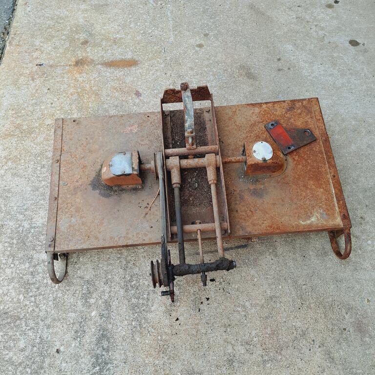

WHX?? 56,598 #1 Posted June 1, 2025 Came off a 702 @Achto and I parting out. Could this be possibly for a 701? Never saw one like it. Requires specific mid mount brackets that are not quick attach. @Lane Ranger shed any light? 3 Share this post Link to post Share on other sites

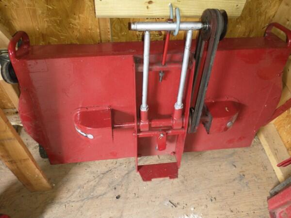

squonk 46,567 #3 Posted June 1, 2025 I have a similar deck but with enclosed ends. Nice and quiet and cuts like a dream. But for some reason it's a PITA to get the front shaft to line up in the hitch. My newer style 32" deck just about goes into place all by itself. 4 Share this post Link to post Share on other sites
stevasaurus 23,689 #4 Posted June 1, 2025 That deck has the wheels inside...only one built like that and is for the 701. 2 1 Share this post Link to post Share on other sites
gwest_ca-(File Mod) 12,234 #5 Posted June 1, 2025 The only deck I am aware of that has flat side panels. 2 1 Share this post Link to post Share on other sites
ri702bill 12,106 #6 Posted June 1, 2025 I have a slightly later one with the external wheels & removable sides. Yes, the captured front mount is a PITA. - but - one advantage is the two adjustable yokes allow you to get the mower square to the tractor. Is that a crack I see on the left side in the cast iron bearing housing?? Common problem, can be repaired... 2 Share this post Link to post Share on other sites
