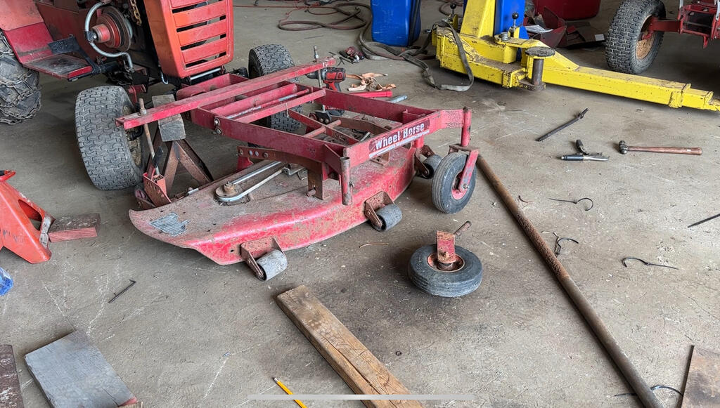

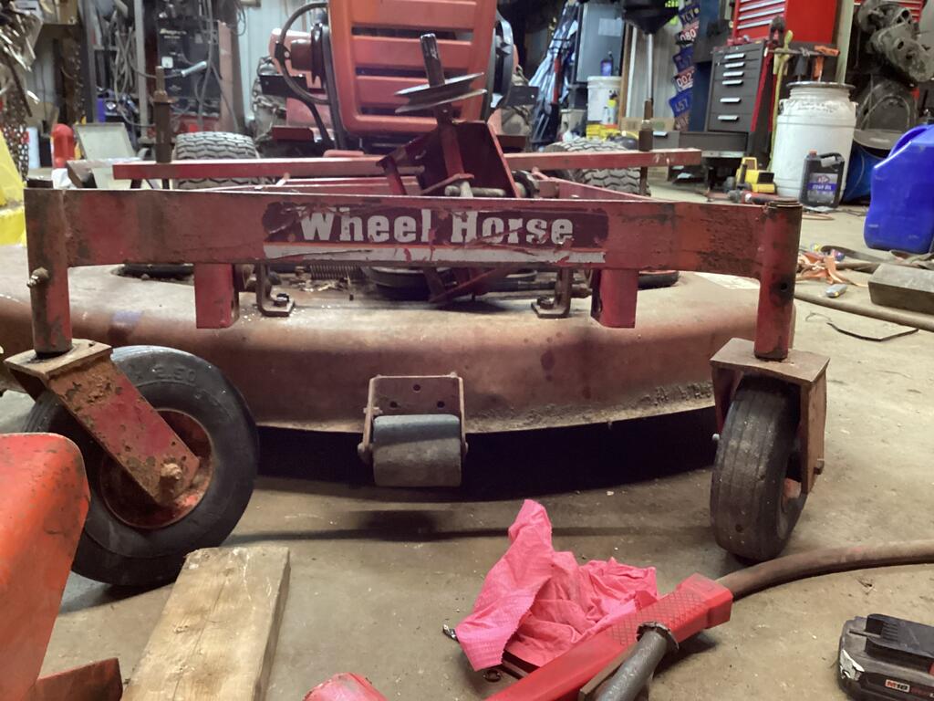

Pullstart 71,259 #1 Posted May 31, 2025 I started popping this rig together today. I need to better the idlers, then give it a shot in the field. 7 8 1 Share this post Link to post Share on other sites
Pullstart 71,259 #2 Posted June 1, 2025 The frame is tweaked considerably. For what I need, it’ll still work just fine. 4 1 Share this post Link to post Share on other sites
c-series don 12,461 #3 Posted June 1, 2025 (edited) @Pullstart Well today is your lucky day Kevin, I have a non tweaked frame! I’ll bring it to the show. I’ll trade you for a cheeseburger,fries and a drink! Edited June 1, 2025 by c-series don 7 Share this post Link to post Share on other sites
JCM 11,415 #4 Posted June 1, 2025 Those deck carriers are pretty rare. Nice 2 1 Share this post Link to post Share on other sites

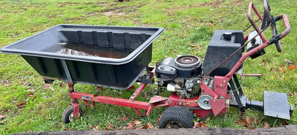

JoeM 10,269 #7 Posted June 1, 2025 If you don't like the way it cuts you could always turn it into a power buggy.. 7 1 1 1 Share this post Link to post Share on other sites
953 nut 69,351 #8 Posted June 1, 2025 21 minutes ago, JoeM said: f you don't like the way it cuts you could always turn it into a power buggy.. Or a motorized chicken waterer. 1 2 Share this post Link to post Share on other sites
squonk 48,127 #9 Posted June 1, 2025 37 minutes ago, JoeM said: If you don't like the way it cuts you could always turn it into a power buggy.. I can see it now! 5 Share this post Link to post Share on other sites
Horse Newbie 7,405 #10 Posted June 1, 2025 Or a motorized gurney… 4 Share this post Link to post Share on other sites

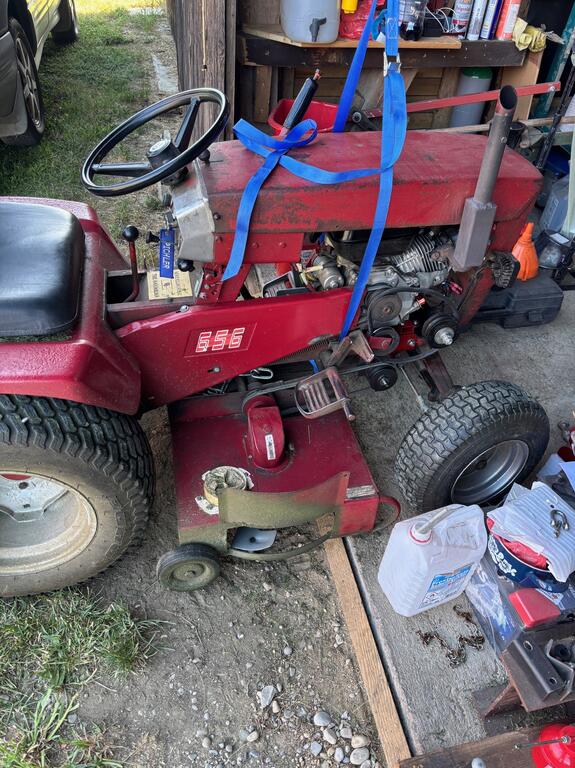

peter lena 10,070 #11 Posted June 1, 2025 @Pullstart always wanted one of those , have a number of yard side trimming issues that would be perfect for it . of course a thorough functiona detailing , idlers , wheel swivels lubing . make the rust run out , then red aerosol grease , extension tube detailing , pete 1 Share this post Link to post Share on other sites
pfrederi 21,151 #12 Posted June 2, 2025 I use mine to keep walking paths open. Really beat on her use her more like bush hog. 4 5 Share this post Link to post Share on other sites

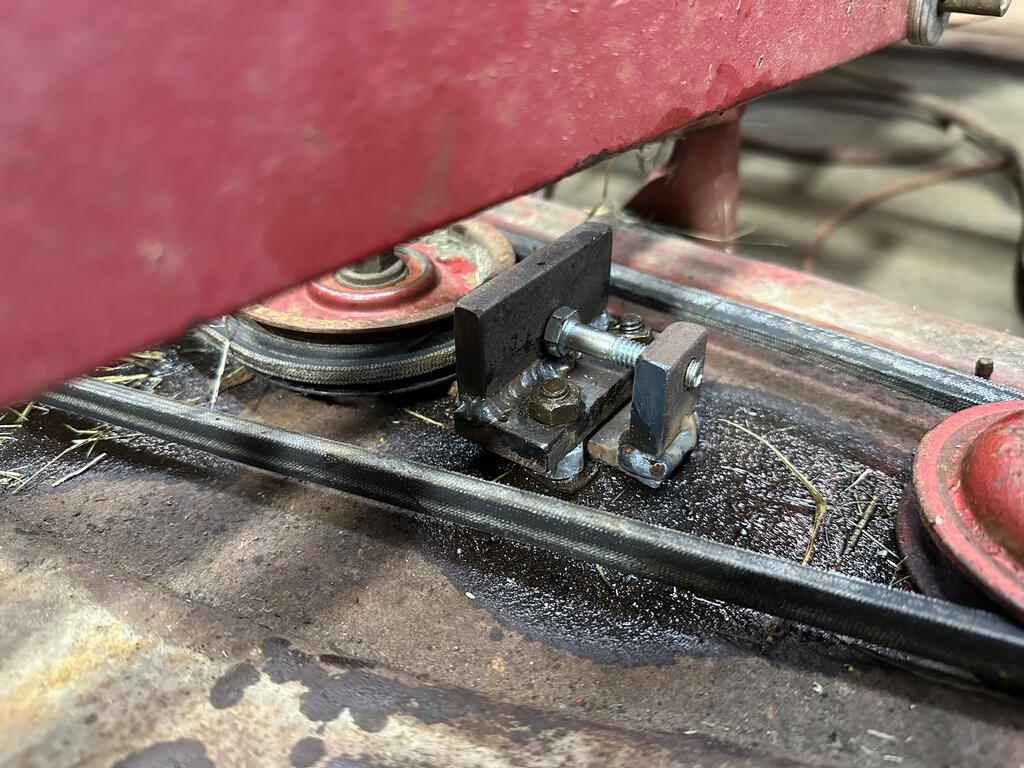

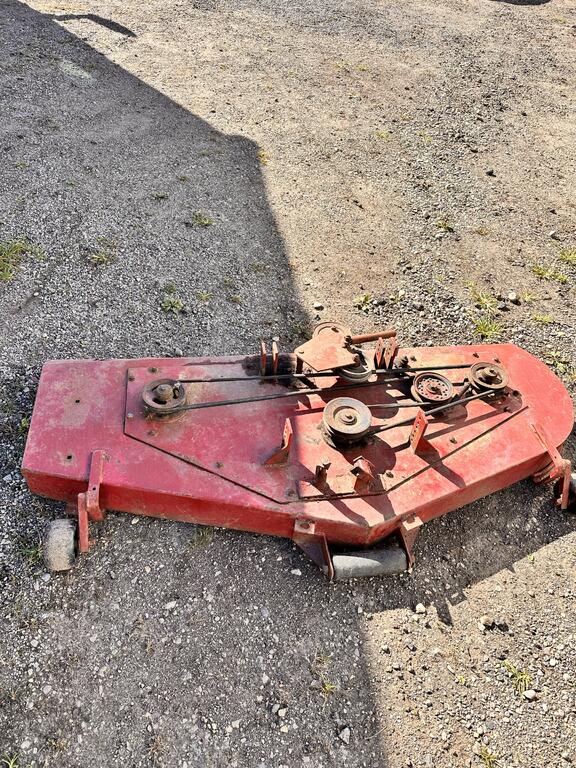

Pullstart 71,259 #14 Posted June 10, 2025 I could not understand the pictures or descriptions of moving the tensioner spring, so I decided I’d build a tensioner. I think it works much better, and after the belt slipping and smoking a bit last night, it should perform great! 3 2 Share this post Link to post Share on other sites
squonk 48,127 #15 Posted June 10, 2025 "Sharpen my knife! " 1 1 Share this post Link to post Share on other sites
Pullstart 71,259 #16 Posted June 10, 2025 3 hours ago, squonk said: "Sharpen my knife! " A sharp knife is easily safer than a dull one 2 1 Share this post Link to post Share on other sites
Handy Don 17,474 #17 Posted June 10, 2025 7 hours ago, Pullstart said: Very cool! The spring tensioner’s two jobs are to accommodate belt wear and to let the belt slip when the blade hits an obstruction but not when it’s just hitting grass! With your copious free time, you could probably add a spring to your souped up tensioner! 1 1 Share this post Link to post Share on other sites

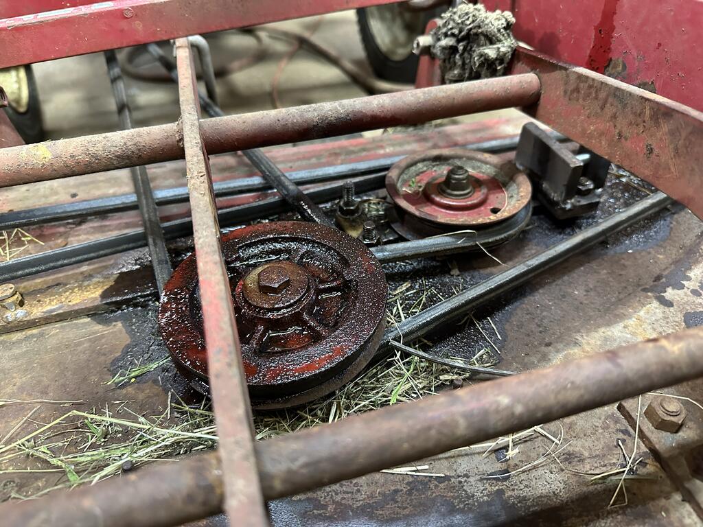

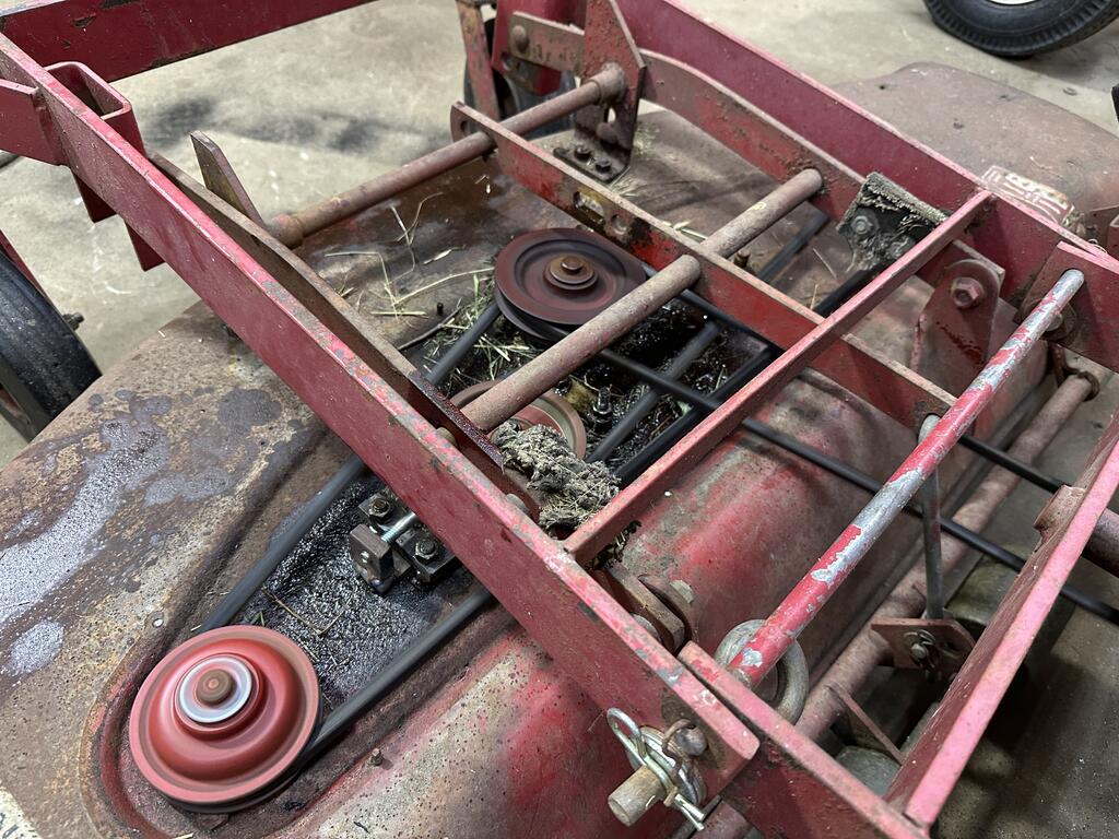

peter lena 10,070 #18 Posted June 10, 2025 @Handy Don look at second deck pulley picture , note the added idler pulley to typically unsupported , long stretch of belt , added that to all my decks , also every bearing , re greased with lucas green grease , quiet smooth operation , no bearing noise , pete Share this post Link to post Share on other sites

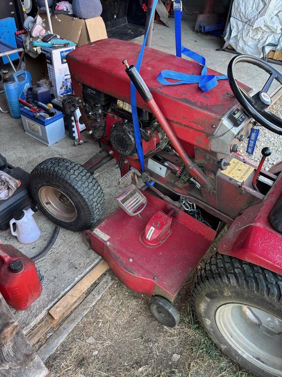

CCW 1,519 #20 Posted June 11, 2025 @Pullstart that sure looks easy, but these 70+ arms are not going to pick up any implement that easily. 2 1 Share this post Link to post Share on other sites
Pullstart 71,259 #21 Posted June 11, 2025 18 minutes ago, CCW said: @Pullstart that sure looks easy, but these 70+ arms are not going to pick up any implement that easily. I’m sure a floor jack would help Share this post Link to post Share on other sites

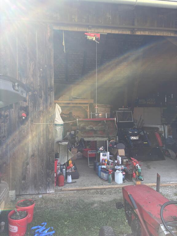

Tractorhead 9,217 #22 Posted June 13, 2025 I make such issues the Tractorhead Style... for such hevy Work i have mounted a hoist in my Shed also very handy at Mowerdeck Cleanout! 👍 2 Share this post Link to post Share on other sites
