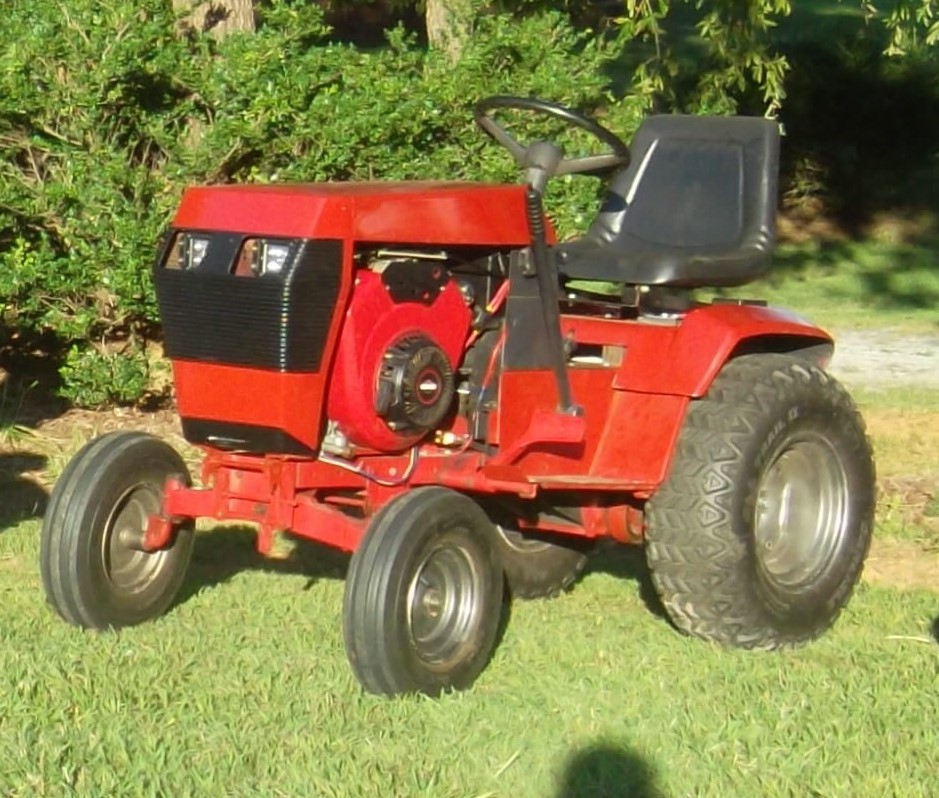

8ntruck 8,402 #1 Posted May 30, 2025 Since this is an engine discussion, I'll post it here. Just a thought experiment for now. Clyde, my C-195 has a Series 1 KT 19 with over 1000 hours showing on the hour meter. I figure that sooner rather than later, it is going to expire. What kind of replacement engines come to all of ya'alls creative minds? The tractor will be used for mowing, moving trailers around, and maybe skidding logs, moving firewood, and hauling powered implements (log splitter, chipper/shredder)to work sites. Possible grading and snow plowing. My thoughts in no particular order: A fresh KT 19 series 2. B&S 18hp boxer twin. Vanguard 20hp V twin. Predator 20hp V twin. Think a Wisconsin V 4 would fit? I remember that somebody swapped a diesel of some sort in one. A Kohler M18. Kohler K341. 20 hp Onan. 1 Share this post Link to post Share on other sites

ebinmaine 76,177 #4 Posted May 30, 2025 I agree with both above. Easiest: keep watch for a direct replacement Kohler 19 HP. Literal bolt in with no mods. Next in line to me would be either Briggs Vanguard or a flat twin as mentioned. "Out of the running" IMHO: predator. Yeah they're cheap and available and easily modded.... We give enough money to that market already. I have - and will again - spend twice the money rebuilding an old Kohler before I'll buy a new cheap copy. Most interesting? Definitely something unusual like the Wisconsin V4.... Lots of Cool Factor there. But the PTO situation could be a deal breaker. 3 Share this post Link to post Share on other sites

WHX?? 53,506 #9 Posted May 30, 2025 Good thread since there are many horses out there with KTs that deserve a new lease on life. I like KP's Briggs or a Honda if I had your wallet Truck... The guy I sold my ailing Super to put a big Predator in it and is a beast. It had the rear PTO but I guess he wasn't worried about the bearing side load. Maybe a good series 2 if you could find one. 2 hours ago, wfrpalm said: and refresh or replace. Not worth refreshing any series 1 economically wise. I looked into that and could have almost done two repos for the cost. and you still have a bad rap motor. Again series 2 replace yes IF you could find a donor tractor. 3 hours ago, ebinmaine said: rebuilding an old Kohler True EB but we're talking a KT 1 here. 4 hours ago, Bill D said: My vote is a 18 HP Briggs boxer twin. Not a bad I idea either Bill. Plenty of those out there in a 18 HP IC flavor. No idea if those have the side load PTO bearing tho. 1 Share this post Link to post Share on other sites
pfrederi 19,379 #10 Posted May 30, 2025 Two things Don't worry about side loading get an electric PTO Agree would be a fools errand to overhaul a KT Series 1. I did overhaul an M-18 it was expensive and parts are getting hard to find or $$$. As much as I like my KT17s I would not do it to them 1 Share this post Link to post Share on other sites
Bill D 2,471 #11 Posted May 30, 2025 4 hours ago, WHX?? said: Good thread since there are many horses out there with KTs that deserve a new lease on life. I like KP's Briggs or a Honda if I had your wallet Truck... The guy I sold my ailing Super to put a big Predator in it and is a beast. It had the rear PTO but I guess he wasn't worried about the bearing side load. Maybe a good series 2 if you could find one. Not worth refreshing any series 1 economically wise. I looked into that and could have almost done two repos for the cost. and you still have a bad rap motor. Again series 2 replace yes IF you could find a donor tractor. True EB but we're talking a KT 1 here. Not a bad I idea either Bill. Plenty of those out there in a 18 HP IC flavor. No idea if those have the side load PTO bearing tho. There is a chart somewhere showing which Briggs engines have ball bearing supported crankshaft. Someone here had it. Most 18 I/C engines should have ball bearings. You will need to find PTO parts. The Briggs stuff is different than the Kohlers. 1" crankshaft different hoop and engine bracket, different mounting plate. 1 Share this post Link to post Share on other sites
WHX?? 53,506 #12 Posted May 30, 2025 2 hours ago, Bill D said: Briggs engines have ball bearing supported crankshaft. I would think most larger engines would have balls? Maybe not the preds? Share this post Link to post Share on other sites

Lee1977 7,464 #16 Posted June 2, 2025 Briggs Vanguard or Honda either would work. Most Vanguard crank shafts are !", but they can be ordered with a 1 1/8" crank shaft. I have two Vanguards a 18 HP in my C-120 and a 16 HP in my 312-8. 4 Share this post Link to post Share on other sites

Wayne0 1,432 #20 Posted June 2, 2025 (edited) On 5/30/2025 at 12:59 PM, Bill D said: There is a chart somewhere showing which Briggs engines have ball bearing supported crankshaft. Someone here had it. Most 18 I/C engines should have ball bearings. You will need to find PTO parts. The Briggs stuff is different than the Kohlers. 1" crankshaft different hoop and engine bracket, different mounting plate. All on the GT Work horse Briggs twin series. Edited June 2, 2025 by Wayne0 1 Share this post Link to post Share on other sites
ebinmaine 76,177 #21 Posted July 29, 2025 On 6/2/2025 at 1:47 PM, bds1984 said: My 1st vote would be for a K341 or M16 @bds1984 Do ALL K341 engines have the axial load capability? I ask because there's a non WH brand near me. On 6/2/2025 at 2:09 PM, ebinmaine said: When you went from 12 horsepower up to 16 or 18 was the difference immediately noticeable? Or is it the kind of thing you only really feel if you're trying to get through thick grass or otherwise use the pto? @Lee1977 Share this post Link to post Share on other sites
bds1984 1,506 #22 Posted July 29, 2025 11 hours ago, ebinmaine said: @bds1984 Do ALL K341 engines have the axial load capability? I ask because there's a non WH brand near me. As far as I know, they do. The general consensus around here is if there are ball bearings on the crankshaft, you should be good to go. 1 Share this post Link to post Share on other sites
