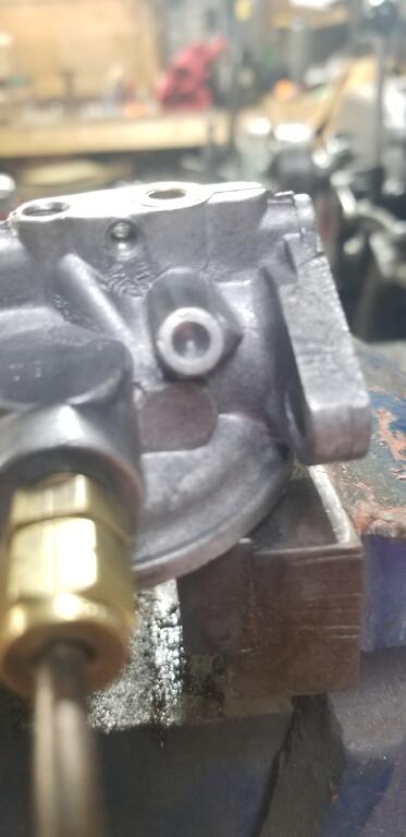

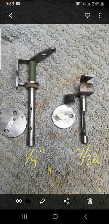

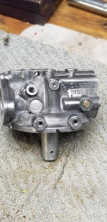

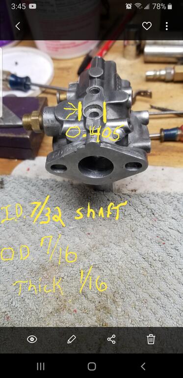

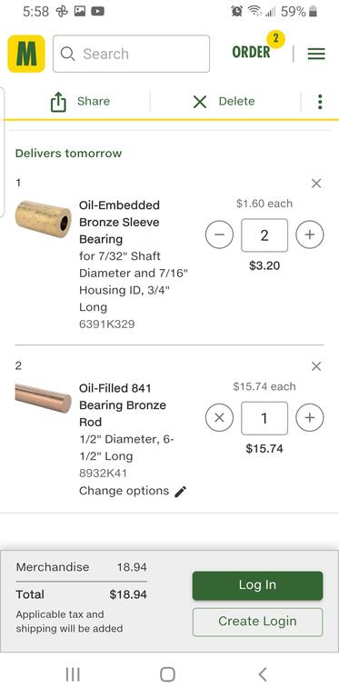

gt14rider 1,281 #1 Posted May 29, 2025 Hi all, @ebinmaine, working on my 856's carb and throttle shaft on carb needs a bushings, it is a Carter model N # 22 the shaft is 7/32, not 1/4" like bigger carbs are. Is there a p/n for the bushing or do I have to make one? Mcmaster carr has a 7/32" x 7/16" x 3/4" bushing or 1/2" x 6 1/2" oil embedded bronze rod. Any info would be appreciated. 2 Share this post Link to post Share on other sites
953 nut 69,724 #2 Posted May 29, 2025 Go to ACE and buy a couple Hillman #58087, 1/4" i.d. x 7/16" o.d. x 1/16" thick bronze bushings. 3 1 Share this post Link to post Share on other sites
gt14rider 1,281 #3 Posted May 29, 2025 The shaft is 7/32" I have the 1/4 x 7/16" x 1/16. That's the problem. 1 Share this post Link to post Share on other sites

gt14rider 1,281 #7 Posted May 30, 2025 The 1/4" shaft is out of a carb off a 12hp or 14 hp. The 7/32" shaft out of 8hp. 1 Share this post Link to post Share on other sites
gt14rider 1,281 #8 Posted May 30, 2025 Thanks. that's what I'm going to do, I'll get some stock from mcmaster carr. 1 Share this post Link to post Share on other sites

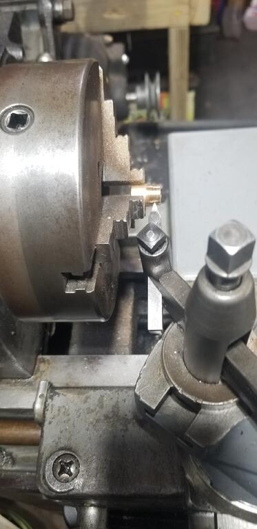

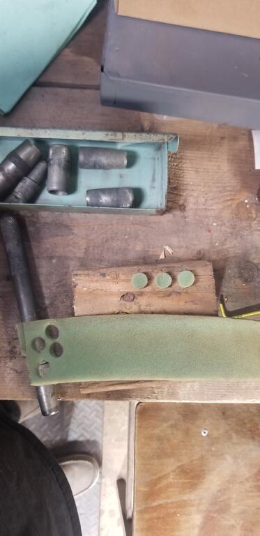

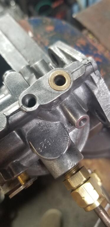

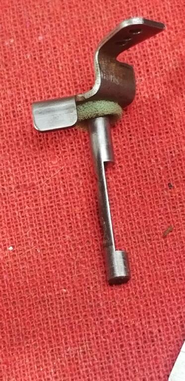

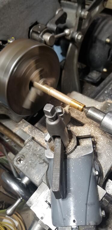

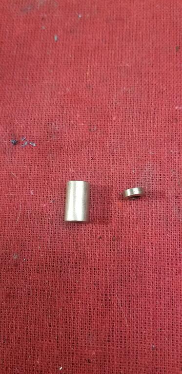

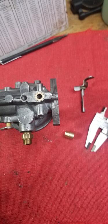

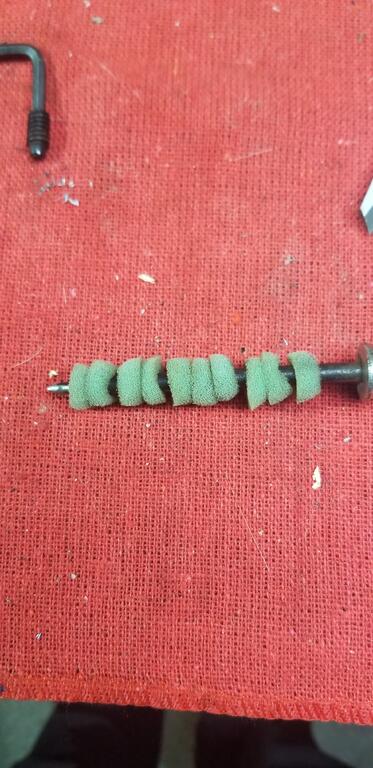

gt14rider 1,281 #10 Posted June 11, 2025 @ebinmaine Got some time on the lathe, got some oil embedded bronze from Mcmaster carr, the 3/4" bushing was a little tight to work with, but got one bushing done. Started turning down the 6" rod . Got it down to 0.010 ,going for the finnish cut,and drive pulley on lathe broke in half. I made the bushing 1/8" thick x 7/32" I'd. X 13/32" od Took pre filter and hole punch and made some carb shaft gaskets, poked a hole with an awl. 2 Share this post Link to post Share on other sites
