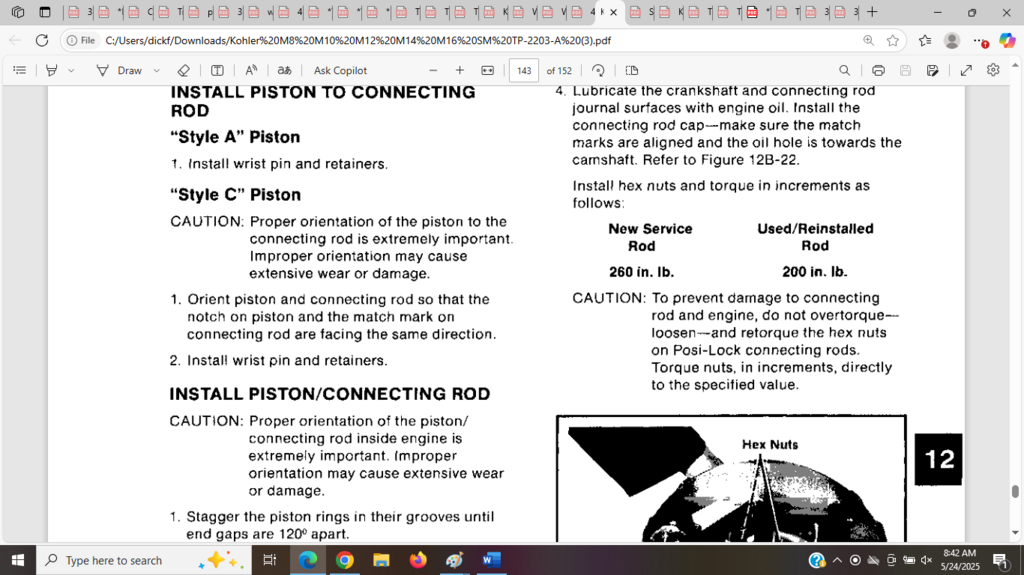

svt721 27 #6 Posted May 25, 2025 23 hours ago, 953 nut said: This is from the Kohler Service manual for your engine. If you haven't downloaded the service manual please do so before you get started. Excellent info, thanks. I’ll roll with the LRB bearings. I brought the crank to the machine shop yesterday morning, he too suggested to use the new rod as the old ones can wear. Hopefully the crank is in good shape and I don’t have to exchange the standard rod for a .010 under. He’s going to hot tank the block after he hones it, so I should be able to mask it off and dust it with some paint. Im obsessive about service manuals, have them for all my cars (over 13 books in 4 binders for my 1994 Saab convertible 😂) and the Horse so I’ve been going through the Kohler paper manual through this whole process. Noticed there are different torque numbers for new and used rods. Ive got a bottle of Torco assembly lube (was my dads favorite substance for building engines haha) and I’ll be applying it liberally. 1 1 Share this post Link to post Share on other sites

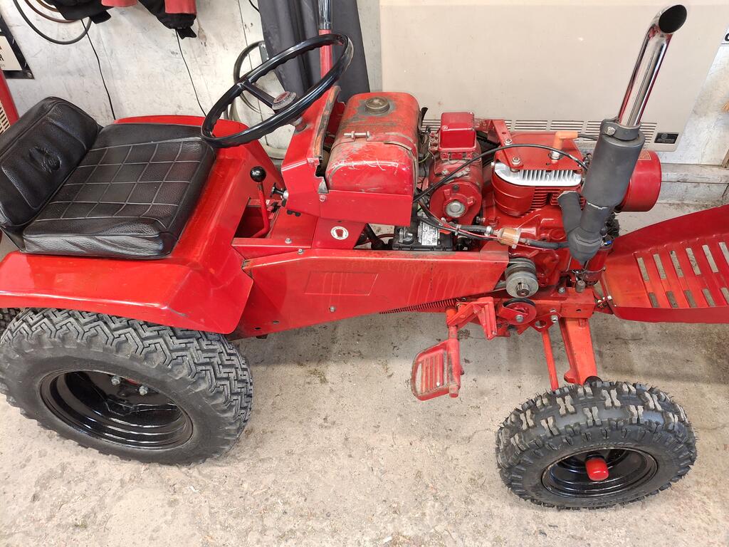

svt721 27 #7 Posted May 25, 2025 (edited) 23 hours ago, squonk said: I wouldn't waste the time blasting the block. I have had great results with just cleaning the block with Dawn Power wash spray. Then a soft wire brush on the nooks and crannies and then painting with Rustoleum enamel and clear. I’ve been wanting to do a stack very similar to yours, I think there’s a guy on here that sells them? Or did you build that one yourself? My only concern is I don’t want it any louder than the stock muffler and I need the pipe to be above face level. Do you know if he makes these with bigger mufflers and longer pipes? What’s the noise level like on yours? Edited May 25, 2025 by svt721 1 Share this post Link to post Share on other sites
squonk 47,887 #8 Posted May 25, 2025 5 minutes ago, svt721 said: I’ve been wanting to do a stack very similar to yours, I think there’s a guy on here that sells them? Or did you build that one yourself? My only concern is I don’t want it any louder than the stock muffler and I need the pipe to be above face level. Do you know if he makes these with bigger mufflers and longer pipes? What’s the noise level like on yours? Bud Andrews made this muffler. He stopped making them. @jimkemp makes similar ones and Chad Burris makes some chrome ones 2 Share this post Link to post Share on other sites

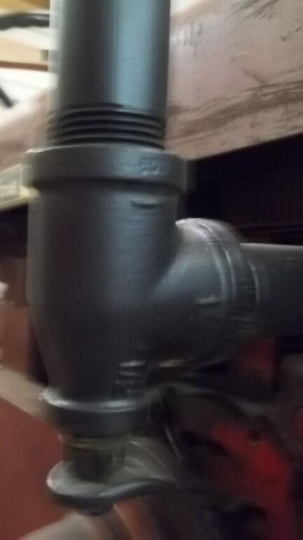

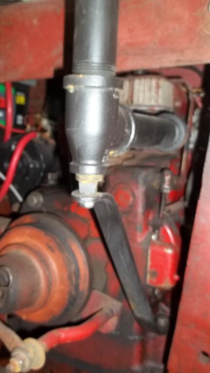

953 nut 68,508 #9 Posted May 25, 2025 Jim Kemp sells the mufflers on They have a nice mellow tone, not nearly as loud as the stock muffler. I added a brace below mine to help reduce the likelihood of damage to the engine exhaust threads. 2 Share this post Link to post Share on other sites
